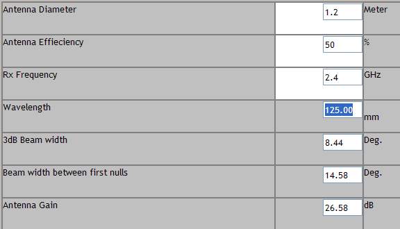

Dish 90cm=24.3dB --> 1.2M (120cm) 26.6dB = +2.3dB

The dish 3dB beamwidth is 8.4 Degrees so we need to point very accurately (+/- 4 degrees total error)
