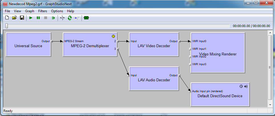

OK Ken, I have received your "Newdecod Mpeg2.grf" file and using GraphstudioNext we can see:
- newdecod Mpeg2 graph.jpg (86.39 Kio) Vu 116544 fois
If you look at this graph, it show how window will decode your TS:
* TS packets received are sent by Tutioune in the Universal Source Filter.( usrc.ax) These are packets of data that can content one or several video and audio channels mixed.
* The Universal Source Filter send the data stream to a Microsoft Mpeg2 Demultiplexer that will separate audio and video data that are in the stream and chose only for output the audio PID and video PID you have selected in Tutioune.
* the demux audio output is coded in Mpeg1 layer2= mpegaudio, we need a decoder before sending the data to the sound card. Here Windows has chosen the LAV audio decoder.
* the output of the audio decoder is a decoded audio stream that is sent to your Soundcard by the Audio Renderer: "Default directSound device"
* The demux video output is coded in Mpeg2 so we need a decoder, we see that Windows has chosen the LAV video decoder.
* the output of the LAV video decoder go to the video renderer
So if your video rendering is no very good you have 2 solutions:
1) well set your LAV video decoder
or
2) tell Windows to change to another Mpeg2 video decoder
We first try to tweak better your LAV video decoder.

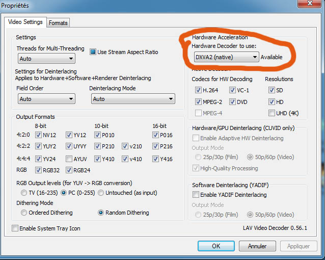

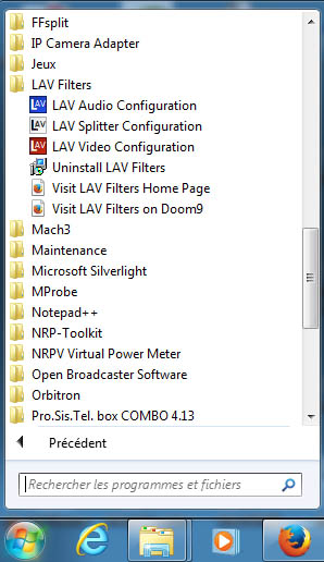

Go to Windows, start --> all programs, find the LAV menu directory and ask for LAV video configuration :
- LAV Filters directory.jpg (65.79 Kio) Vu 116536 fois
- LAV video configuration.jpg (114.23 Kio) Vu 116543 fois
try now different setup . Restart Tutioune after each change.
