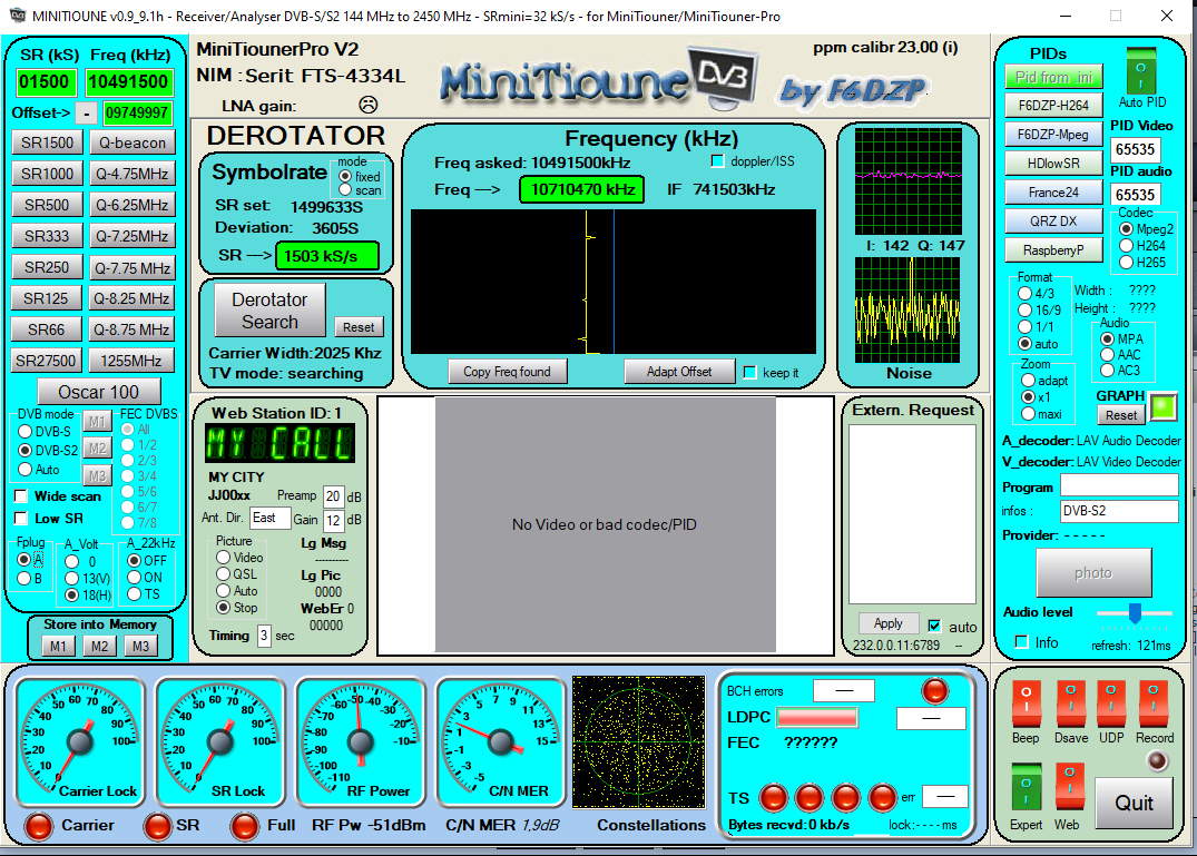

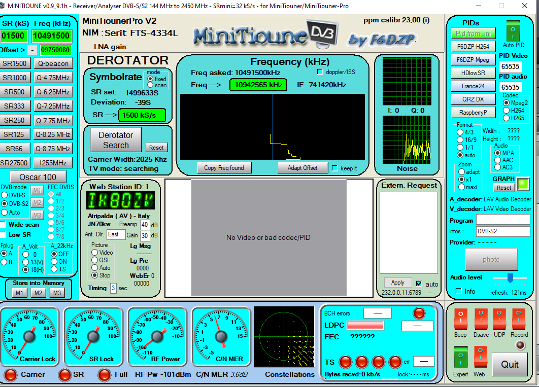

it is a couple of days that i cannot receive anymore the DATV signal with my minitiouner.
This is what i get when i start the program:

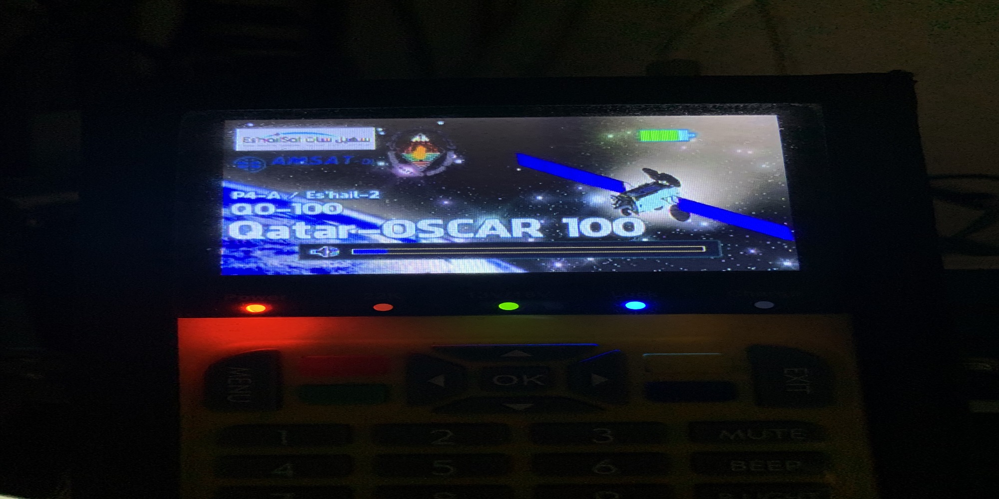

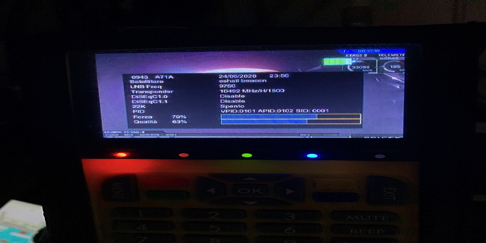

I have checked with the Digital Satfinder and i get the Beacon signal on it:
Signal on Satfinder (1).JPG (551.81 Kio) Vu 93353 fois
Signal on Satfinder (2).JPG (459.55 Kio) Vu 93353 fois
I have checked that on the LNB is present the 18V.

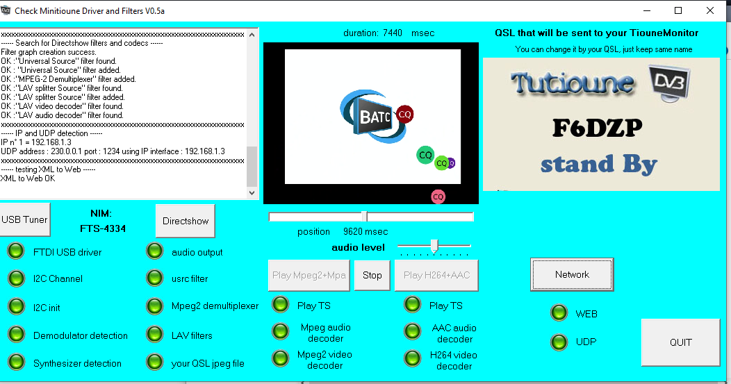

I have checked with the programs:
CheckMiniTiouneDriverAndFilters_V0_5a - I get:
Check Minitioune Driver and Filters.png (137.9 Kio) Vu 93359 fois

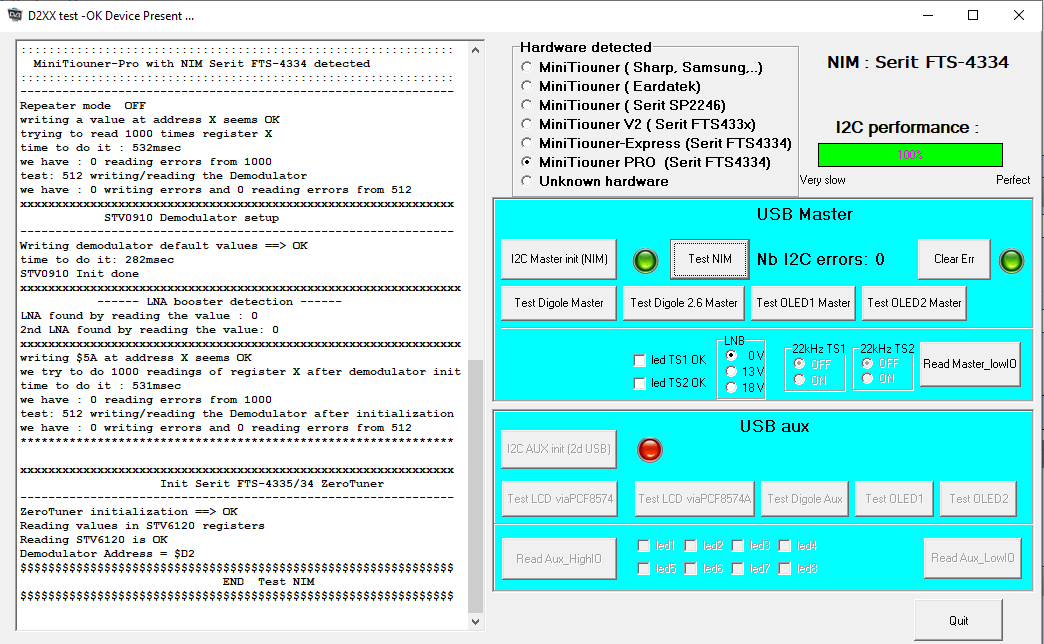

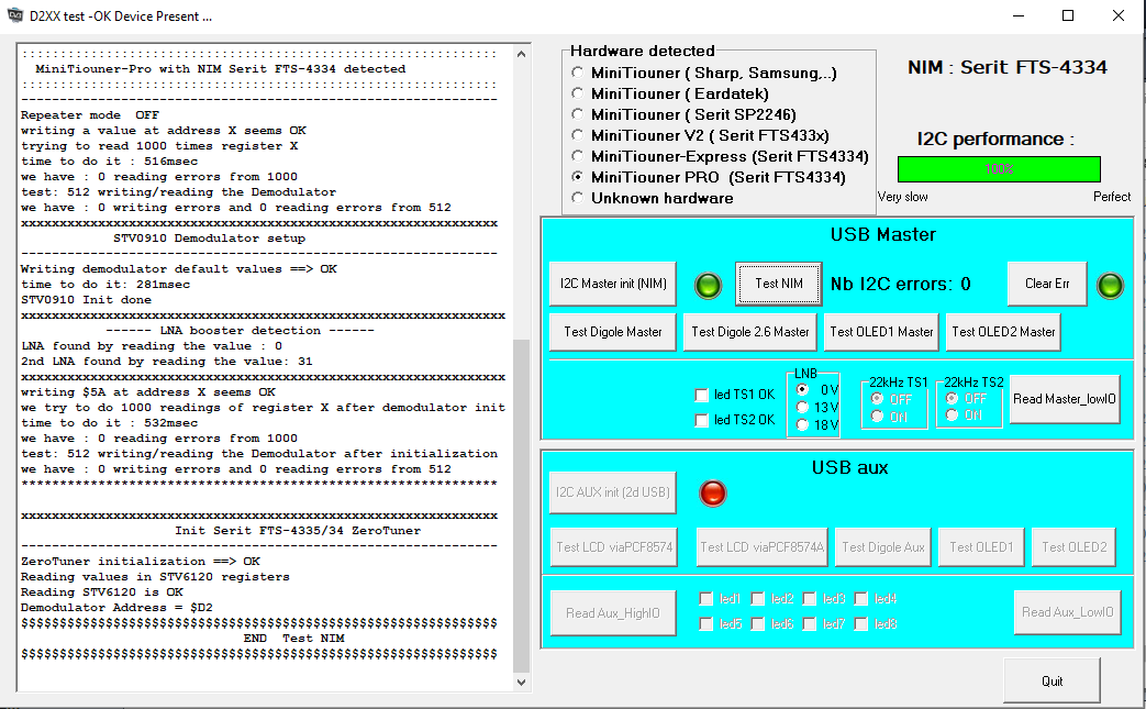

TestMyMiniTiouner_V2_0a - i get:
Test My Minitiouner.png (67.28 Kio) Vu 93359 fois
How you can see all tests are OK all green LEDs.

Enzo check your LNB and/or the connections to your LNB.
You have no LNA gain. See text above "DEROTATOR"

Messagede F6DZP » Sam 1 Aoû 2020 05:12
you are not on the frequency.
if we read the Freq --> value, we can see that the freq set is 10 710 470 kHz
it should be 10 491 500 kHz (freq asked)
so you are at about 220 MHz far from the frequency searched. So it is normal that you receive nothing
now I try to know why you have this result... the derotator cannot go so far from the freq asked.
it seems that your MiniTiouner clock is bad (quartz?)
1) could you try to set the Derotator Symbolrate detection mode to 'scan'
2)Could you try to use the original minitiouneConfig.ini ?
3) using Minitioune, could you do CTRL +A and capture the new pannel

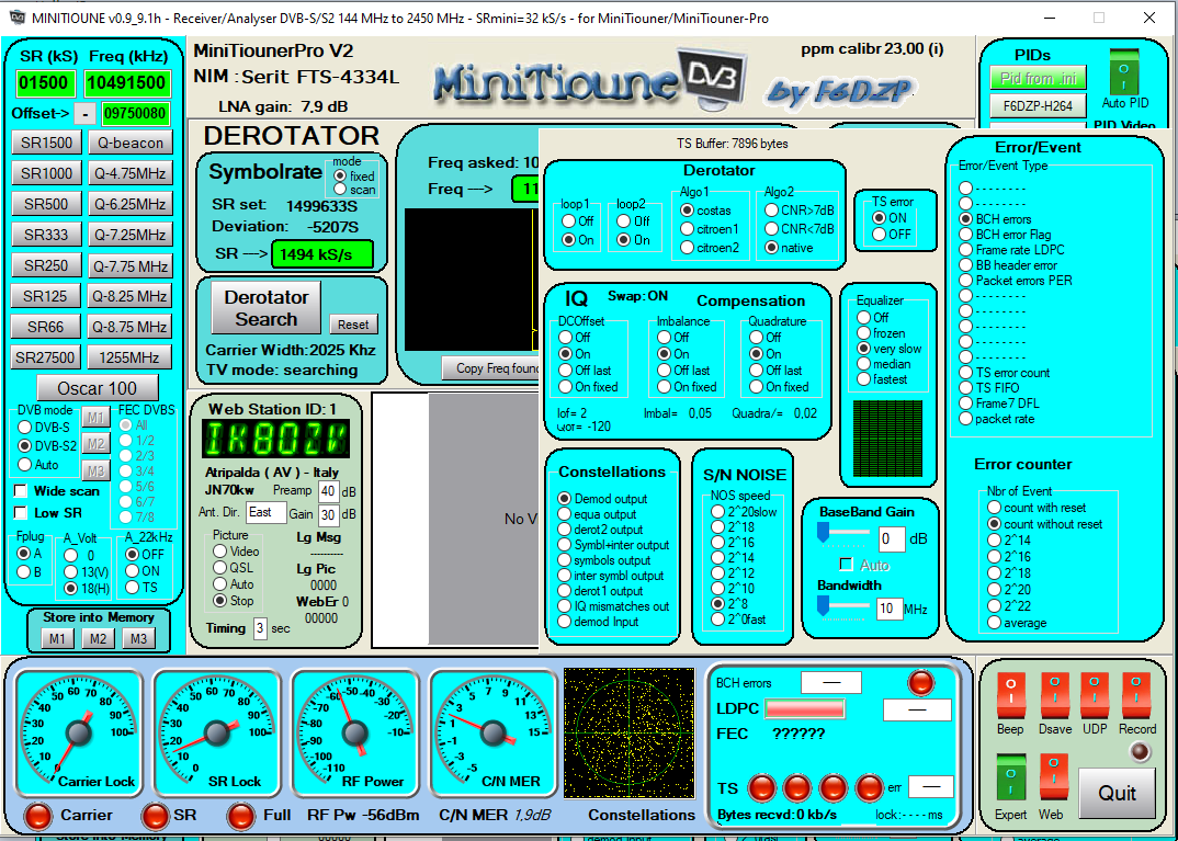

Here are the result of your requests:
1) Please how to set the Derotator Symbolrate detection mode to 'scan'? If i click on the Derotator Search tab,
i just see the Freq --> moving some kHz each time i click on it.
2) I have tried to download the program again and used the one just downloaded so with the original minitiouneConfig.ini file with the same results
3) doing CTRL +A while using Minitioune i get this:
New Panel.png (222.23 Kio) Vu 93317 fois
Please what to do?
JP i have also noticed that when i switch on the minitiouner i have the RF Power to -100:
Just switch ON.png (214.75 Kio) Vu 93307 fois
but if i just switch, in the program, the Fplug from "A" to "B" and then back to "A", so the RF Power jumps to -50:
Switching A to B and back to A.png (215.64 Kio) Vu 93307 fois
Thanks for your helps

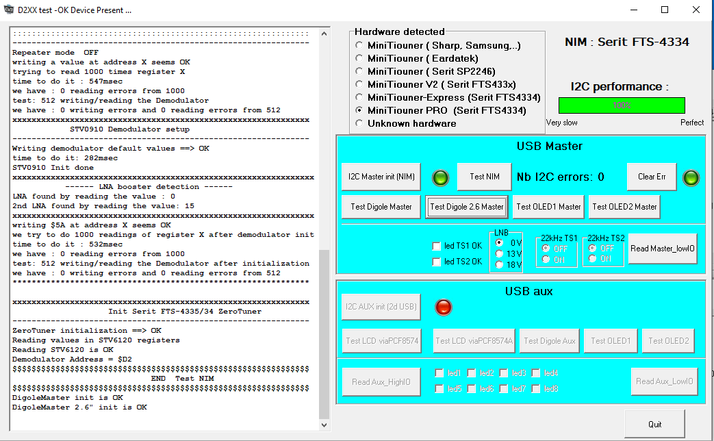

Hello Jean-Pierre, Thanks for your reply.
As you can see on the initial post, i have made the screenshot of all the test done with the TestMyMiniTiouner software,
but, yes, you are right i forgot the Display test.
When i run the the TestMyMiniTiouner software i get this warning:
I click on OK and the program Opens:
I then click on the IC2 Master Init ( NIM ) Tab and then on the Test NIM tab and this is the result:
Finally i have clicked first on the Test Digole Master Tab and then on the Test Digole 2.6 Master tab and how
you can see from the picture they give both OK:
