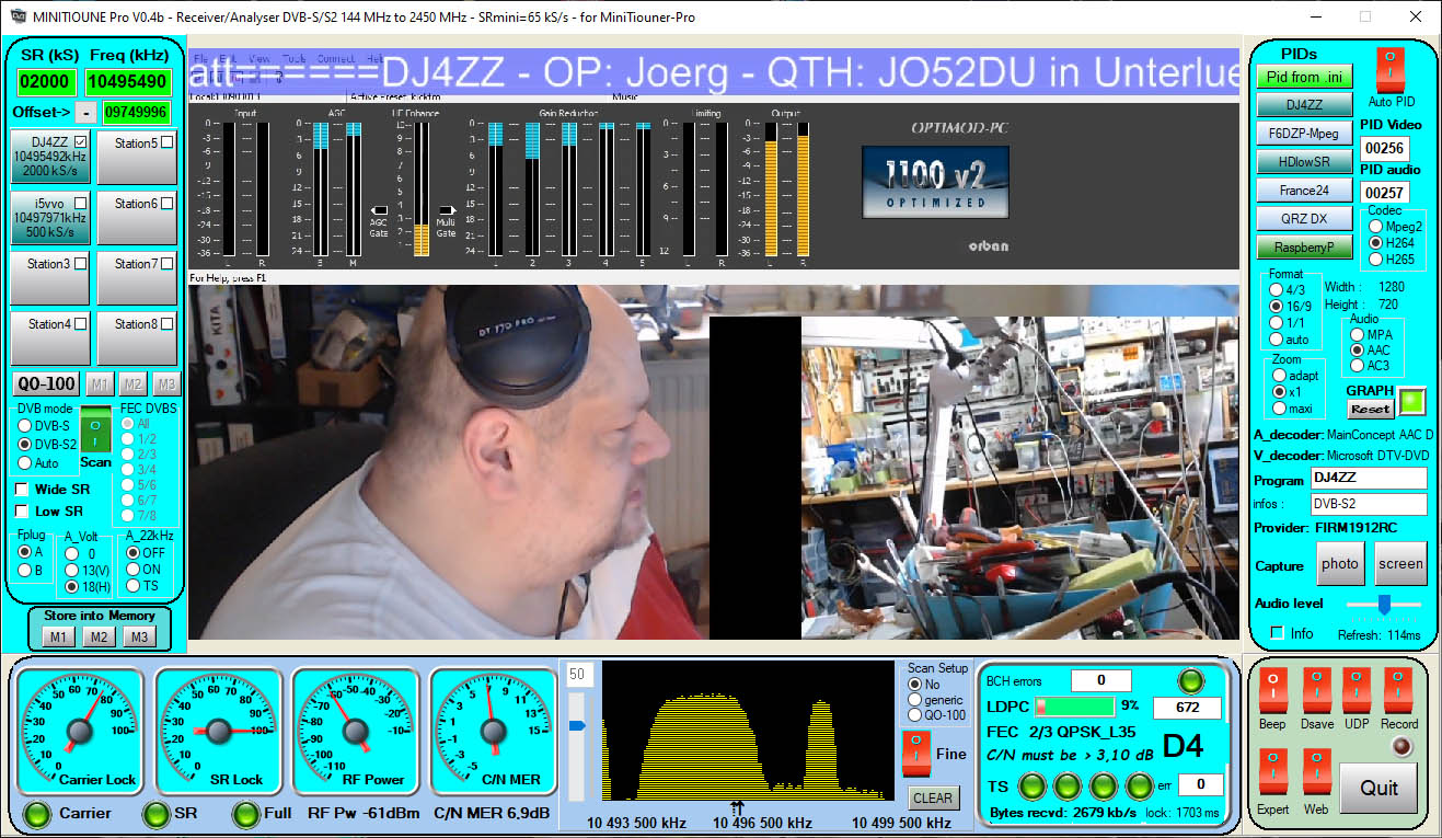

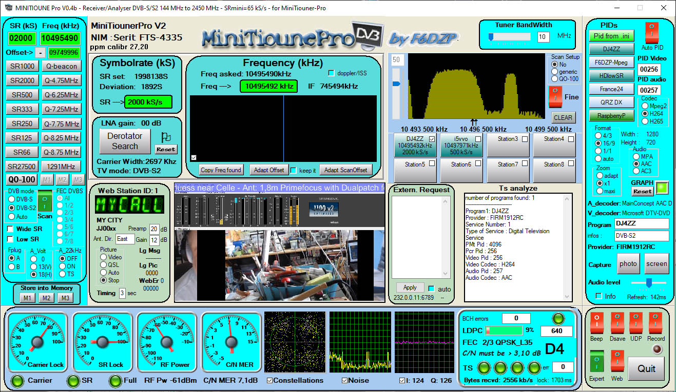

en phase de beta test par plusieurs OM, la publication est proche.
Ce logiciel ne marche qu'avec les MiniTiounerPro et pourra marcher avec le MiniTiounerV2 + extension que je nomme "MiniTiounerV2+"
MinitiounePro V0.4b Expert mode receiving and scanning.jpg (351.13 Kio) Vu 120190 fois
En mode Expert, vu toute l'activité, le raffraichissement des mesures passe de 109ms (Minitioune) à 142ms. ça demande donc un PC pas trop vieux/lent
mais en mode Standard, le rafraichissement des mesures n'est presque pas affecté car les constellations sont remplacées par le scanner ( si il est en route)
MinitiounePro V0.4b standard mode receiving and scanning.jpg (282.74 Kio) Vu 120190 fois
plusieurs OM font le beta test, on corrige et c'est mis à télécharger.

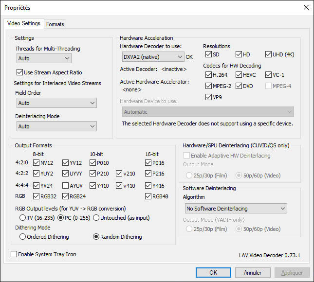

I am having problems with the new version. Jerky video and audio on the beacon, possibly elsewhere too. There seems to be a codec problem yet all the codec tests are fine. It plays fine in VLC. This did not happen in the last version.
Mike
g0mjw
Messages: 12
Inscription: 17 Juil 2011
Re: MiniTiounePRO
Messagede F6DZP » Mar 7 Avr 2020 04:31
Hello Mike,
1) VLC cannot be used to compare. VLC uses its own internal codec, not Windows codec.
2) Yes, I have seen one time what you are talking (jerky video and audio on the beacon) when I used some codec
You can see now directly in Minitioune the name of codec used.(A_decoder and V_decoder) , could tell me which one you use?
3) can you use "Win7DSFilter Tweaker_6.3" to set use of LAV video decoder for H264 and LAV audio Decoder
verify that Minitioune uses them (A_decoder and V_decoder) and tell me if you always have "Jerky video" ?

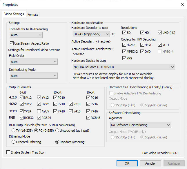

Re: MiniTiounePRO
Messagede F6DZP » Mar 7 Avr 2020 06:55
It seems that the "jerky video" issue is due to a new Windows update or Nvidia update ???
I can find the same problem using the old Minitioune V0.8s and also Minitioune v0.9beta8.9...
seems to happen only on my PC using a Nvidia card...
I continue to investigate
Re: MiniTiounePRO
Messagede F6DZP » Mar 7 Avr 2020 07:28
Perhaps I have found a solution:
When you are using a Nvidia graphic card, you must set LAV video decoder accelerator to DXVA native: (seems to work on my 2 PC with NVidia card)
LAV video decoder setup when you have a NVIDIA card.jpg (100.39 Kio) Vu 118669 fois
or seems better:
LAV video decoder setup when you have a NVIDIA card_ second solution.jpg (104.71 Kio) Vu 118657 fois
