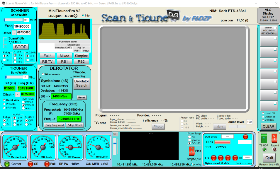

Messagede dl9sec » Lun 13 Avr 2020 14:25
is there a magic how to reliably start and operate Scan&Tioune?
I need one reboot to be able to start the program. To start, close and start again is not possible. The non-movable information window appears and stays for several minutes, then it closes and nothing more happens.
When I get it started, I couldn't get something catched and/or decoded. The scanning arrow runs from left to the right, but there is no spectrum shown (see attachment).
Running an up-to-date Windows 10...
(Don't be bothered by the 0V LNB voltage, it is fed from another part of my reception system. Minitoiune v0.9beta8.9 is running very well...)
TIA.
73, Thorsten

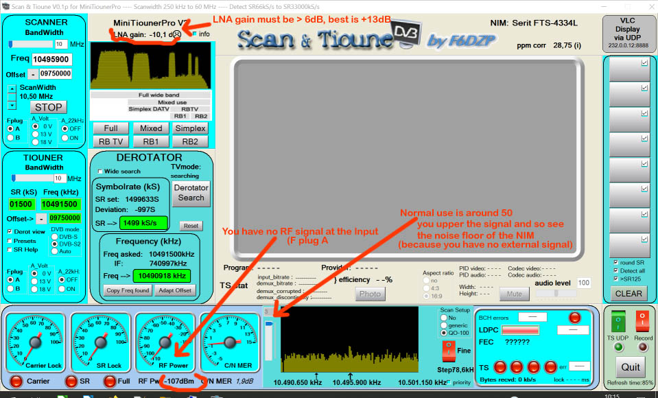

Messagede dl9sec » Dim 19 Avr 2020 08:33
Regarding the starting problems of Scan&Tioune...
I am using a computer running Win10 x64.

Nevertheless, the program neither tunes e.g. to the beacon, nor does a scan result in a spectrum with stations.
Here is the info output:

Re: Scan&Tioune
Messagede F6DZP » Dim 19 Avr 2020 12:51
Hello Thorsten,
Seeing the screenshot, Scan&Tioune is working normally.
But you have something bad in your environment:
The LNA gain is negative!
this LNA is a chip inside the NIM, 1st stage before the tuner, that has a gain that can vary to amplify or attenuate a signal, to try to give a -20dBm signal to the tuner.
Normally the gain that is shown is between +6 and +13dBm .
on your station I see a gain negative of -10.1 dBm !!
But on the scanner I see no signal, on the RF level I see no signal (-107dBm)
That signifies that you must have a QRM, a very High signal that is sent to the NIM. this signal can be far from the frequency, the LNA is wide band and the tuner input 10 MHz wide.
so, I am sure that you are sending a very high level signal in your cable ( 144 MHz??, 435 MHZ ?? or ???) that disturb completely the NIM : as a very high signal is at the input, all AGC stages inside the NIM lower all levels at the max they can, so you see nothing on the spectrum and you offset up the spectrum display to see only the noise floor of the NIM
Scan&Tioune receive no signal on the freq but a very strong QRM is sent at the input on a far Frequency .jpg
Scan&Tioune receive no signal on the freq but a very strong QRM is sent at the input on a far Frequency .jpg (171.04 Kio) Vu 858393 fois
You can try to scan using a bandwidth of 60MHz, perhaps you will discover the strong signal disturbing your rx.
Jean-Pierre F6ZDP

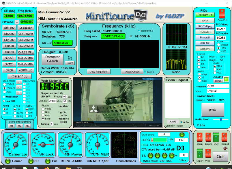

Messagede dl9sec » Dim 19 Avr 2020 16:24
Your Answer is not plausible for me.
How can you explain that with exactly the same hardware configuration Minitioune v0.9beta8.9 works as expected?
There must be basically a big difference between Minitioune v0.9beta8.9 and Scan&Tioune...
2020-04-19 18_15_05-MINITIOUNE v0.9beta8_9 - Receiver_Analyser DVB-S_S2 144 MHz to 2450 MHz - SRmini.png
2020-04-19 18_15_05-MINITIOUNE v0.9beta8_9 - Receiver_Analyser DVB-S_S2 144 MHz to 2450 MHz - SRmini.png (311.64 Kio) Vu 858390 fois

Messagede F6DZP » Dim 19 Avr 2020 21:15
@Jabi:
Photo are saved in the Minitioune directory.
@DL9sec:
on the Minitioune screenshot the LNA GAin is positive and normal : +8,3dB and you have a signal ,RF level is normal : -41 dBm
on the Scan&Tioune screenshot the LNA gain is negative! : -10.1 dB and you have no signal : RF level is -107 dBm
I cannot say more. If you just change the software and don't change anything with the hardware I don't understand. Never seen that.
The Tiouner software part of Scan&Tioune is the same than in Minitioune, so should exactly the same. (The only difference is for rendering the video)

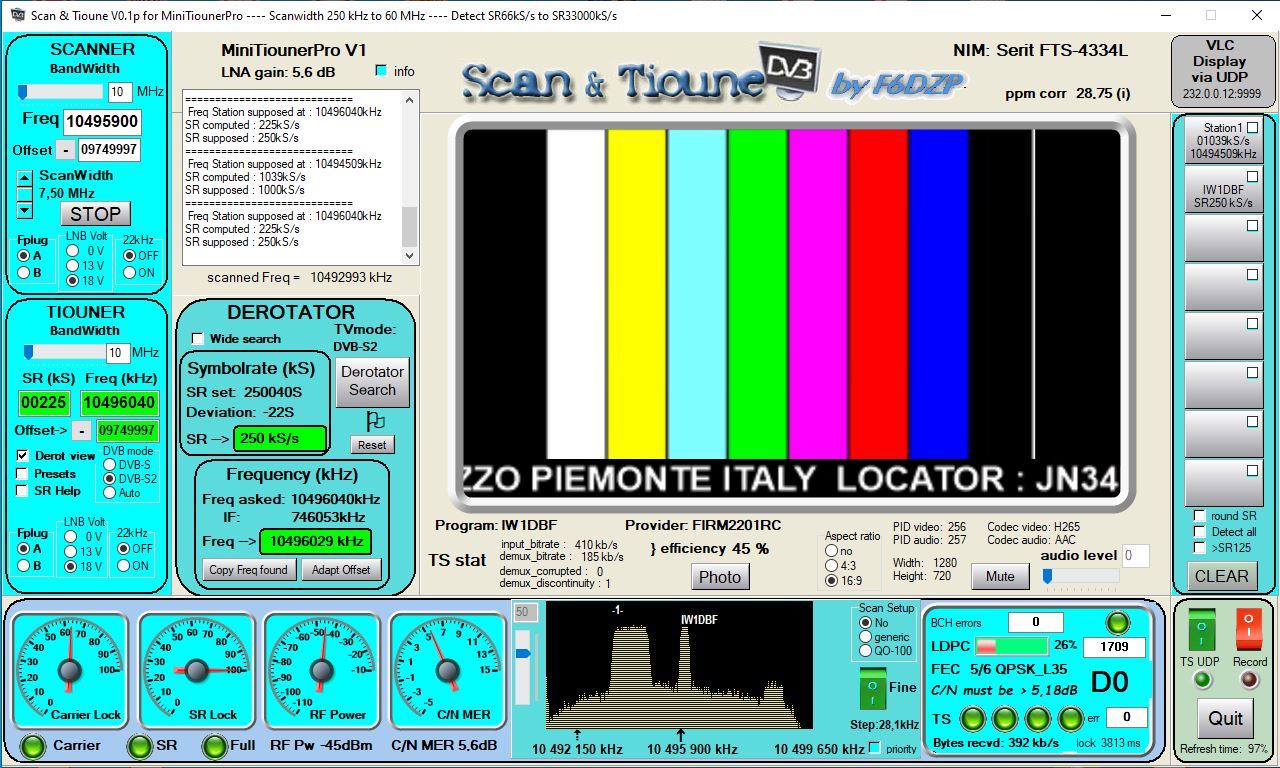

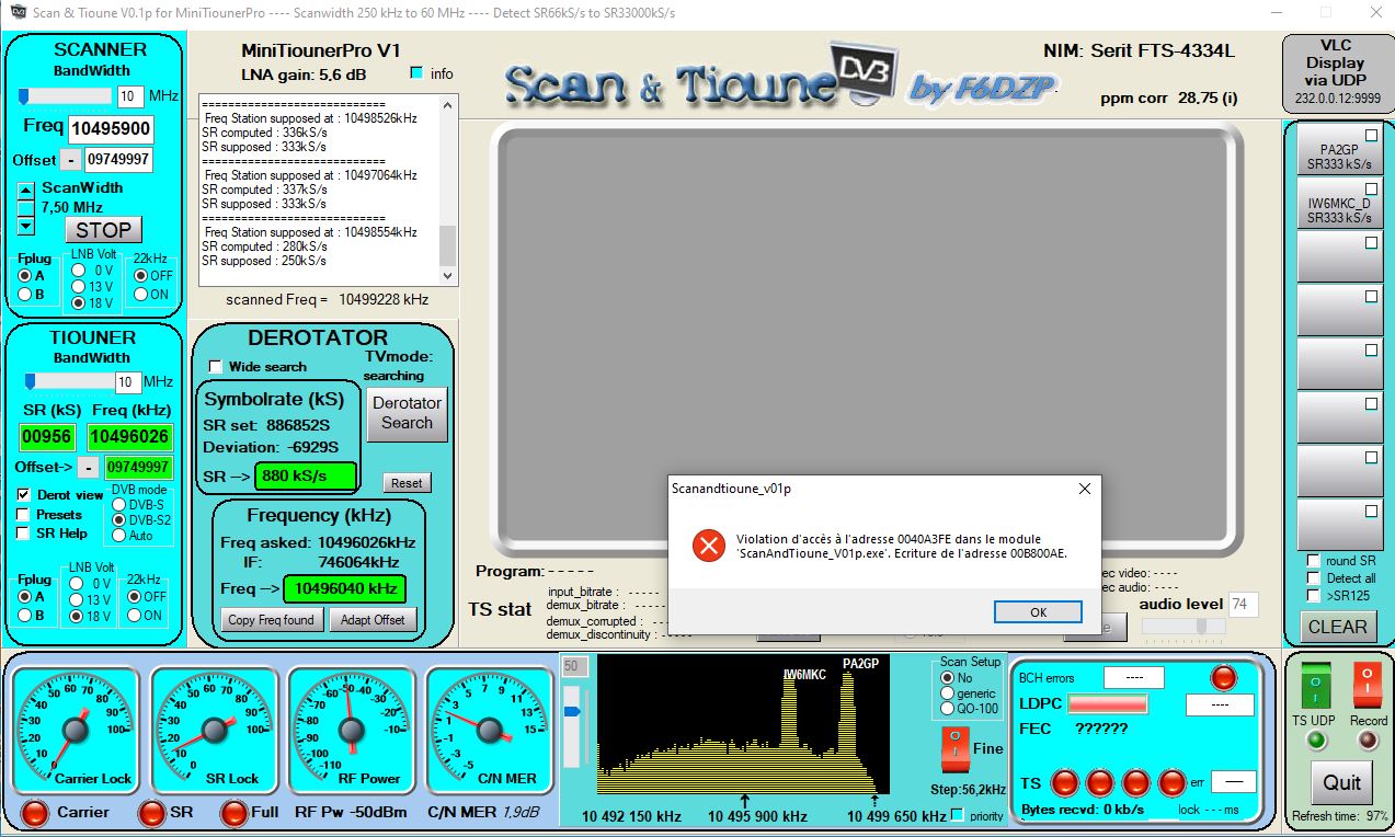

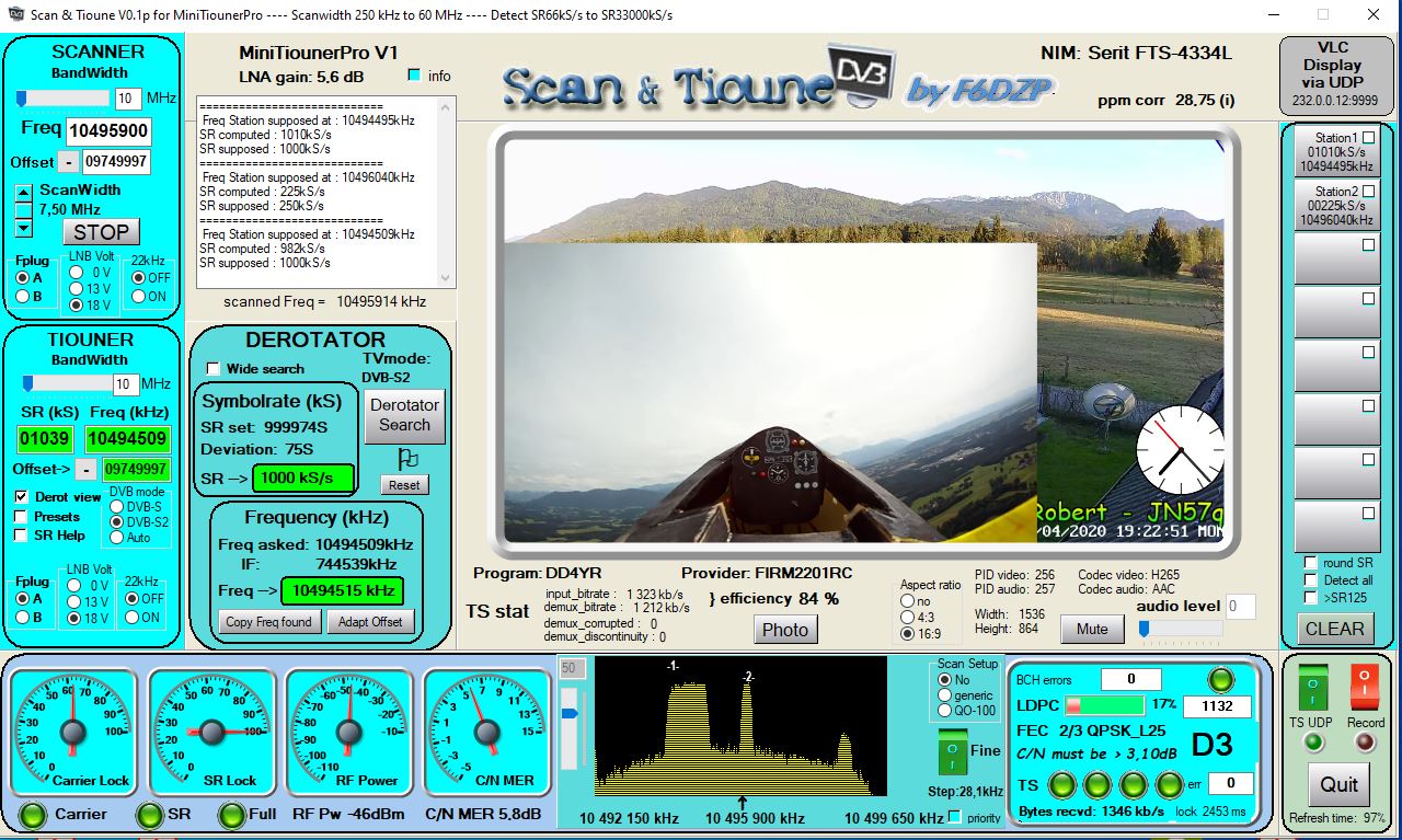

Messagede F1EJP » Mer 29 Avr 2020 09:03
Pour moi fonctionne parfaitement depuis plusieurs jour (1 seul message d'erreur sans plantage)
La vidéo est même plus fluide avec VLC que avec direct-show !
Quelques exemple avec parabole 80cm ordinaire(STRONG)
Le flux vidéo ne semble pas encore transmis sur TiouneMonitor ?
Merci pour ce surperbe développement
73 de F1EJP
