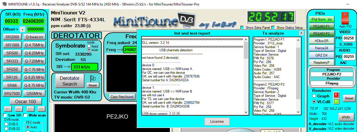

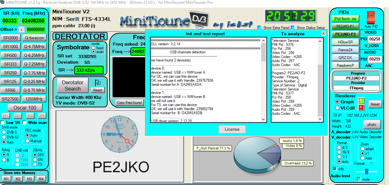

While experimenting with multi-program stream everything works fine when using the Graph renderer, when changing to VLC.dll renderer only Program 1 is displayed, when selecting Program 2 nothing happens and only Program 1 is shown. Is this a limitation ? It is the first time experimenting with multi-programs with FFMPEG so might be some fine tuning must be done on the FFMPEG part. Thanks for the advice.
Regards, PE2JKO
I am using the 1.0.1g version. Please see some screenshots :

yes it is normal and well known on my side.
Since the first version Minitioune using Directshow (Graph) has been able to work with Multistream . I used it to receive broadcast station with sometimes 12 services in one TS.
I have just implemented VLC for amateur use only because some Amateur DATV stations send often bad TS (= bad timing PCR/PTS) and Directshow Graph mode doesn't like bad TS(=> cut in audio or choppy video), VLC accept better TS with bad timing.
As for the moment 99,99% of DATV stations send TS with only 1 service, I let VLC to play the first service.
The possibility to use VLC dll in Minitioune is new, so it is the first implementation, the first step.
But yes,It is already in my "to do" list : implement multi services in the VLC mode.
Today you have the Graph mode that can do it and if your TS is correct (= with good timing) you don't need urgently the VLC mode with multi services.
remark : you are not using the last version of Minitioune. The v1.0.1.0r is better, try it.

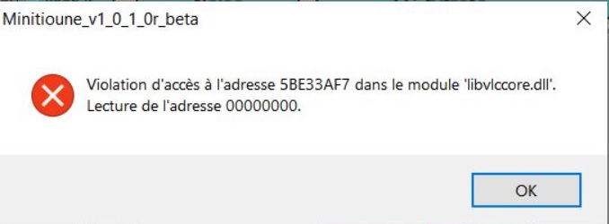

I am having problems between MiniTioune v1.0.1.0r and VLC. I run Windows 10 and installed VLC 32 and VLC 64 but seems Minitioune does not send anything to VLC via UDP.
I enabled VLC and Minitioune in Windows firewall through, also tried to downgrade VLC to earlier versions but nothing so far.
When try to enable VLCdll on the Renderer it comes up with the error message in the attached image
Thank you for any help to solve yhis
