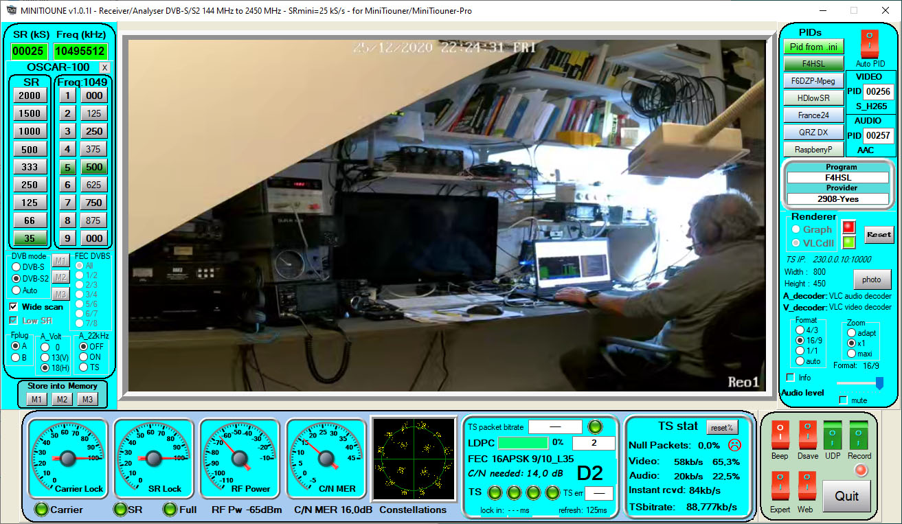

Minitiooune V1.0.1.0 can do SR25 and has a TS analyzer
Messagede F6DZP » Sam 26 Déc 2020 04:24
Minitioune version 1.0.1.0 is coming soon.
It incorporates the ability to decode and display the video using the functions of VLC which are now integrated.
** This more easily solves the problem of receiving broadcasts that are not up to DVB standards and cause stuttering in the video or clicks in the sound in Graph mode.
** This more easily solves the problem that one can have if one uses a second monitor.

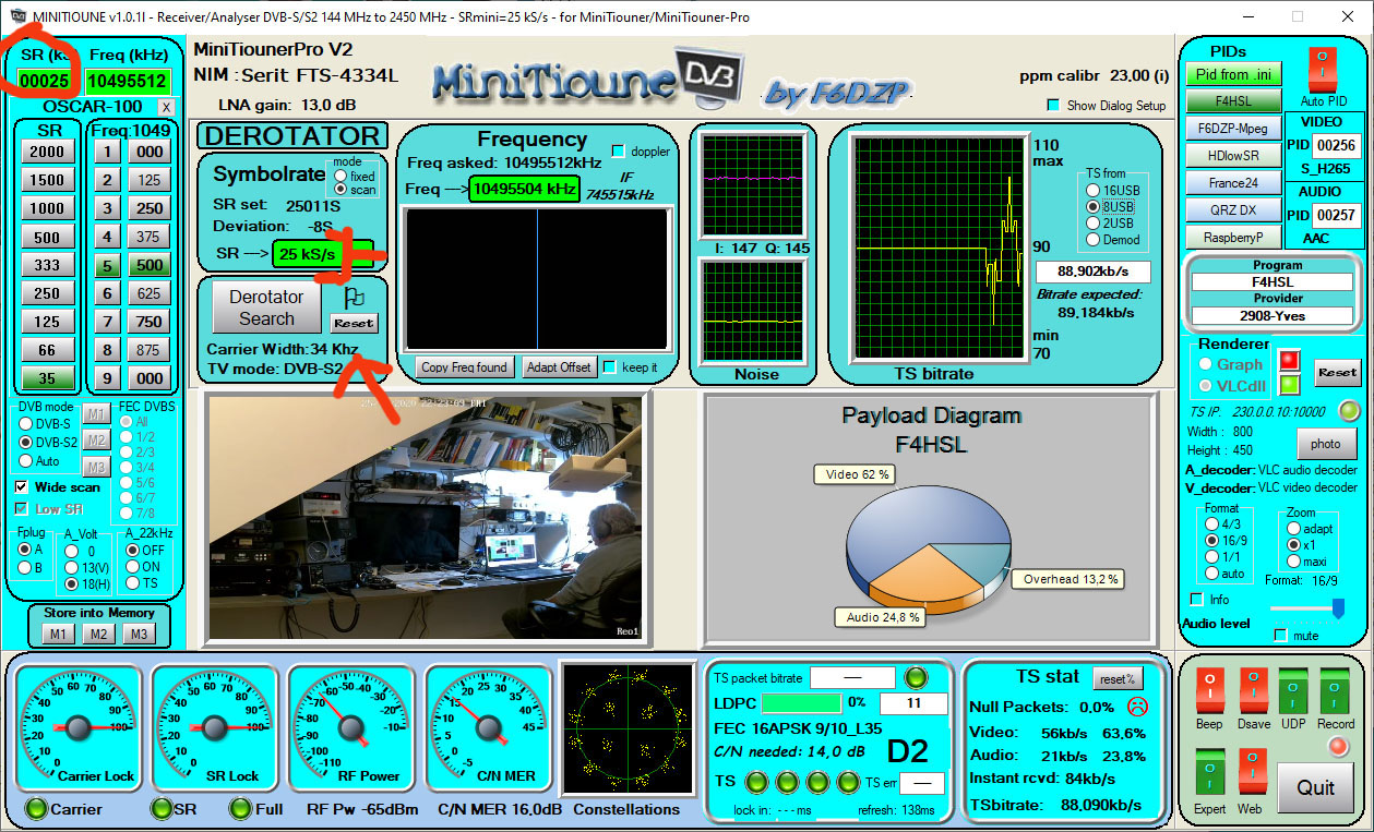

In addition to the statistics on the received TS stream, it can go down to SR25!
Yesterday evening a first transmission / reception on QO100 of a video (+ sound) in 800x450 (16: 9) format in SR25 was carried out.
this video therefore only took 34 kHz of bandwidth! Unbelievable!
The transmission was carried out on QO100 by Yves F4HSL virtuoso TS encoding at very low bit rate, with the latest December 2020 version of the firmware for Pluto developed by Evariste F5OEO which has optimized the filtering for very low bit rate transmissions and added additional parameters to correct errors of non-linearity of our amplifiers, which makes it possible to place the constellations much better.
This version is in finalization and should be available for everyone towards the end of 2020 or the first week of January 2021.

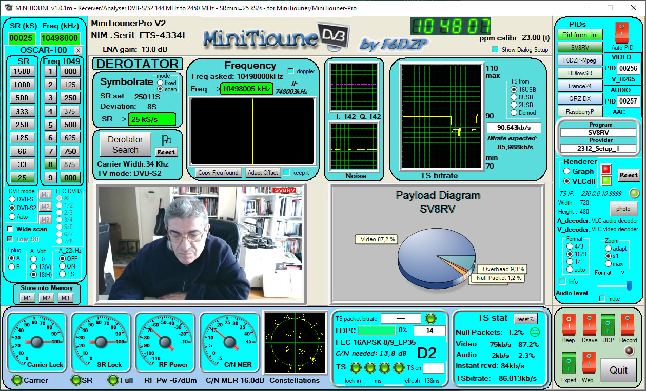

Messagede F6DZP » Mar 29 Déc 2020 09:49
new test today
