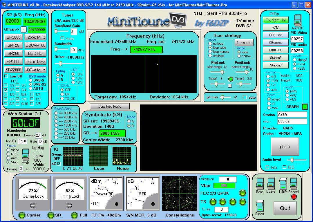

All is OK, but the DVBS2/H264 test beacon video from Es'Hail2 will not display at all. I get a black video window.
I can expand the window but it it still black. No video is shown.
Black video with DVBS2.
There is no error message, everything appears to be working fine, and I can hear the audio OK.

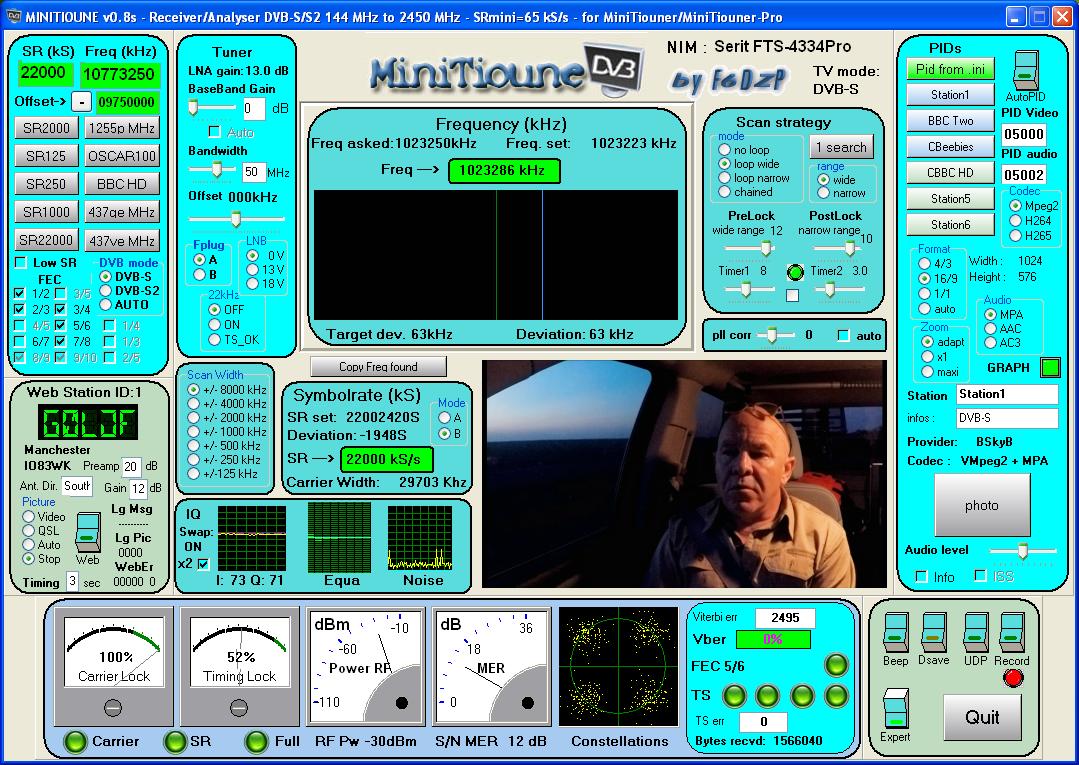

MPEG2 video from BBC, is all fine. No problems at all. All MPEG2 seems OK. Snapshot attached.
MPG2 high resolution from BBC fine in MT.

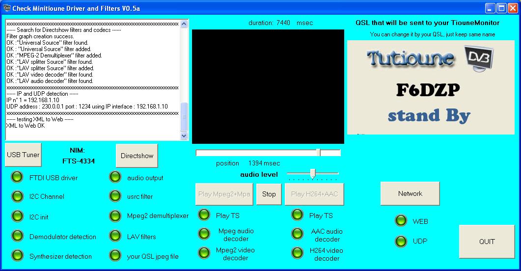

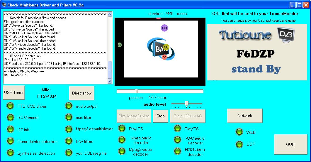

The video test program (CheckMiniTiouneDriverAndFilters_V0_5a.exe) displays both the SUPPLIED sample MPEG2 and sample H264 video OK.
The test program will NOT show the TS clip I recorded from Es'Hail2 of the DATV beacon. The video is displayed as black as in MT.
I have attached snapshots of this.
Display supplied sample H264 fine in test program.
Display black in test program too.
The hadware test program (TestMyMiniTiouner_V2_0a.exe) shows no errors at all and 80% I2C speed.

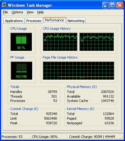

Could you look at the % CPU used when the H264 decoding process try to decode ( when you are receiving the high definition H264 video)?

I have attached a CPU use snapshot. About 83%. I did this over several minutes of receiving Es'Hail2 DATV Beacon (DVBS2).
CPU use when receiving DVBS2 from Es'Hail2
I am suspicious about the idea of CPU use, because VLC can display this very same station at the same time as TS is receiving it (over UDP).
I am guessing it is a rendering problem, as the stream can be saved and then viewed in VLC.

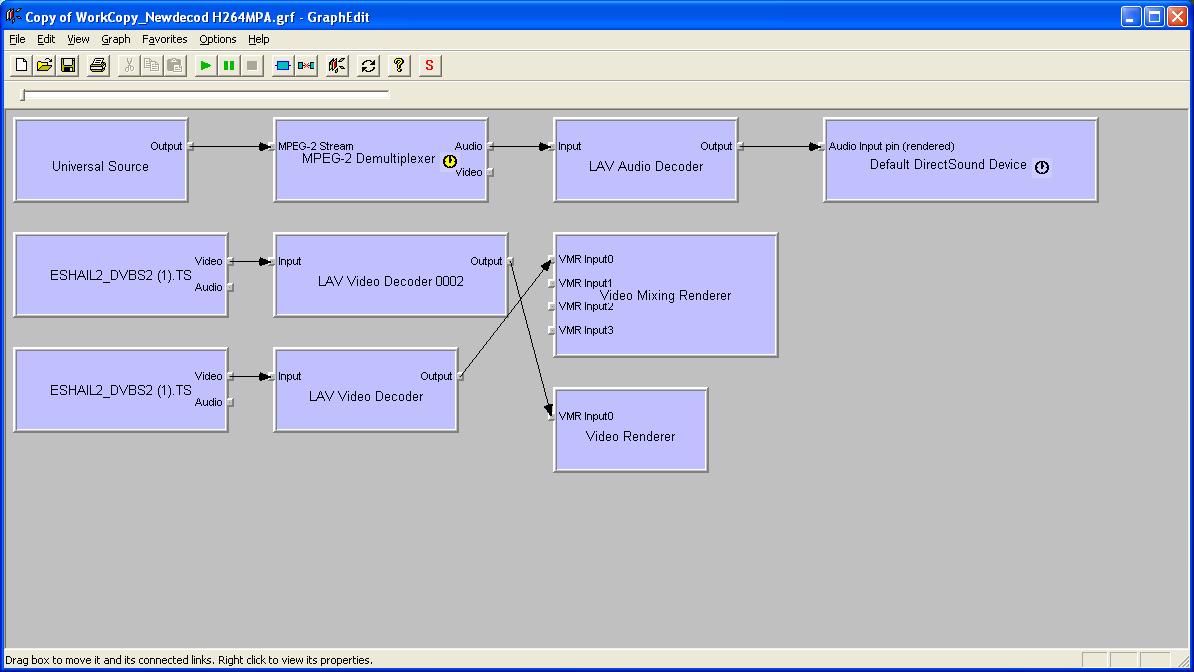

Working on the problem...

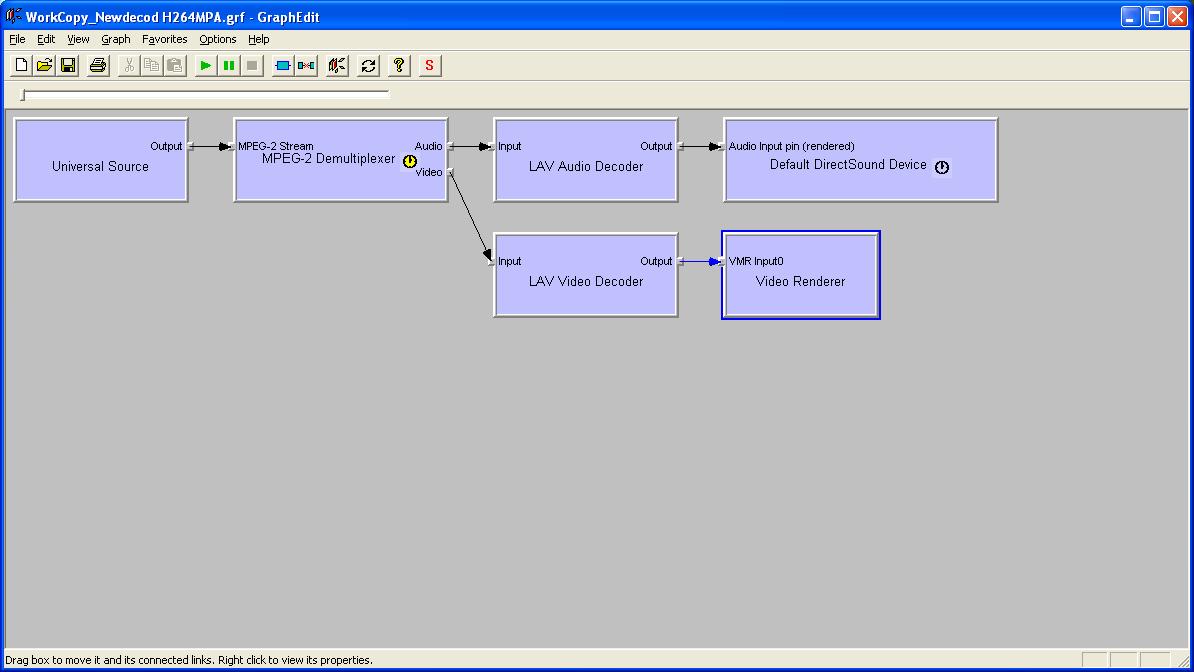

MT selects VMR V9 instead of VR V7 from Quartz.DLL.
Despite this being marked DO NOT USE by the merit value.
This is a working GRF. See the Video Renderer used is 7.
Working GRF
There are three CLSID interfaces on my Quartz.dll. Each has its own merit value.
The SW is not iterating through each CLSID to find the highest merit value in my opinion.
GraphEdit picks VR7 when asked to make a GRF and successfully displays an HD TS file.
Mike G0LJF

1) J-P, can I override this behavior please? Can I supply my own GRF file using the readGRF switch?
; Graph : use of .grf file / utilisation des fichiers .grf
ReadGRF=yes
2) Is there another way to force the use of VM7 which I know works. See attachment...
Here you can see that two identical windows are displayed for the Es'Hail2 DVBS sample.
One works OK and the other does not.
Comparison of VMR9 and VR7 (works OK).
