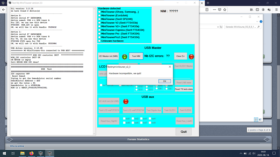

I have the same issue. I run the FTProg and installed a "using NIM tuner" template. Now I got this "hardwer incompatible" error...I attach a snapshot. Could you advise please.

Messagede F6DZP » Ven 14 Aoû 2020 15:57
I cannot help, I have no information.
What is the hardware you are using?
Re: Hardware Incompatible, we quit
Messagede mucsb » Dim 16 Aoû 2020 13:22
Soulution found!
I use DATV-Express MiniTuioune. I had to use FTProg and download default template again. Now it works fine.
