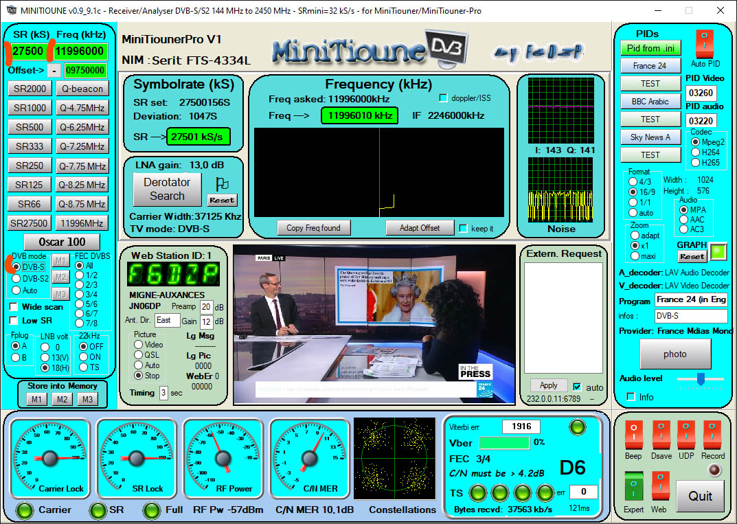

the first thing to do is to try on a direct freq, receiving directly your own signal on 437MHz or 1255MHz from a Pluto or Lime Mini or Minimod at SR1000 or 2000.
Have you tried to receive also a broadcast station from QO-100/Es'Hailsat2 at SR27500? https://www.youtube.com/watch?v=-WlHawgb8IQ&t=9s
receiving Broadcast station from ES_Hailsat.jpg (320.95 Kio) Vu 26467 fois
take picture of what shows Minitioune and put it here on the Forum.
