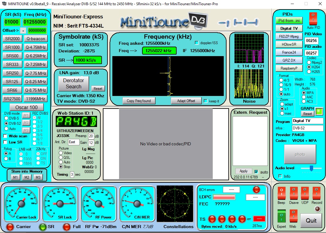

My minitiouner express doesn't lock on 1000 or 2000 KS. From 500 and down it works just fine.
Does anyone have an explanation? Tried it on 2 computers, running win10.
Thanks in advance,
Gerrie de PA4GB

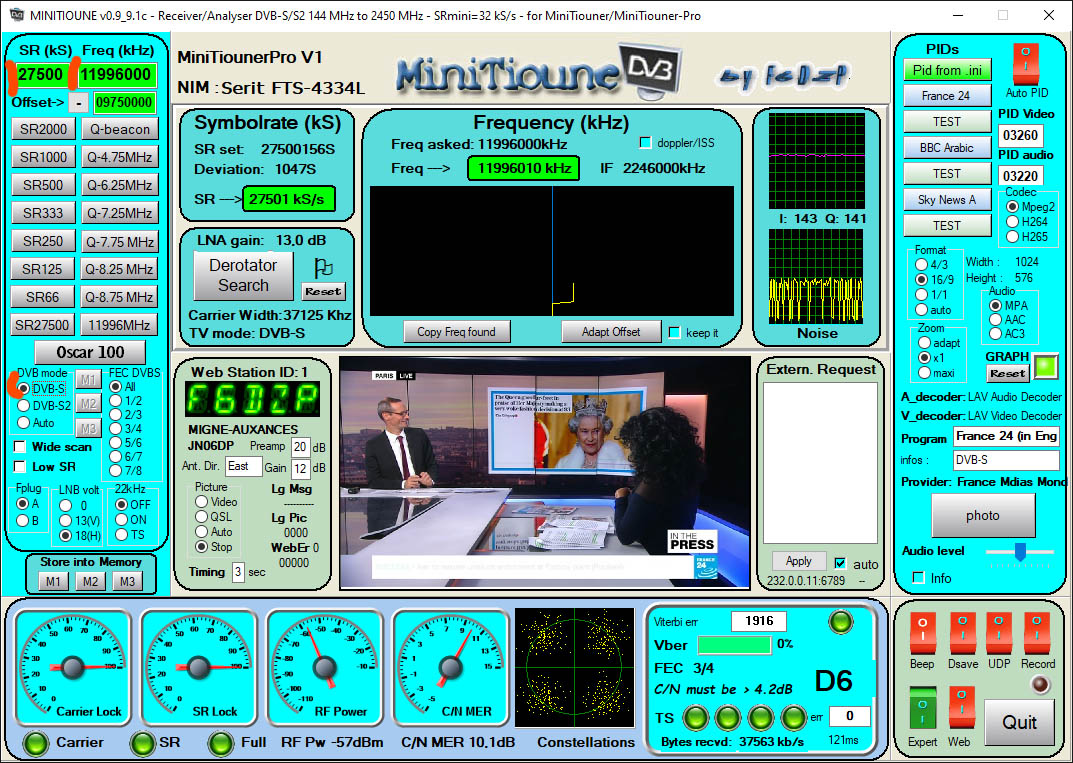

the first thing to do is to try on a direct freq, receiving directly your own signal on 437MHz or 1255MHz from a Pluto or Lime Mini or Minimod at SR1000 or 2000.
Have you tried to receive also a broadcast station from QO-100/Es'Hailsat2 at SR27500? https://www.youtube.com/watch?v=-WlHawgb8IQ&t=9s
receiving Broadcast station from ES_Hailsat.jpg (320.95 Kio) Vu 26466 fois
take picture of what shows Minitioune and put it here on the Forum.

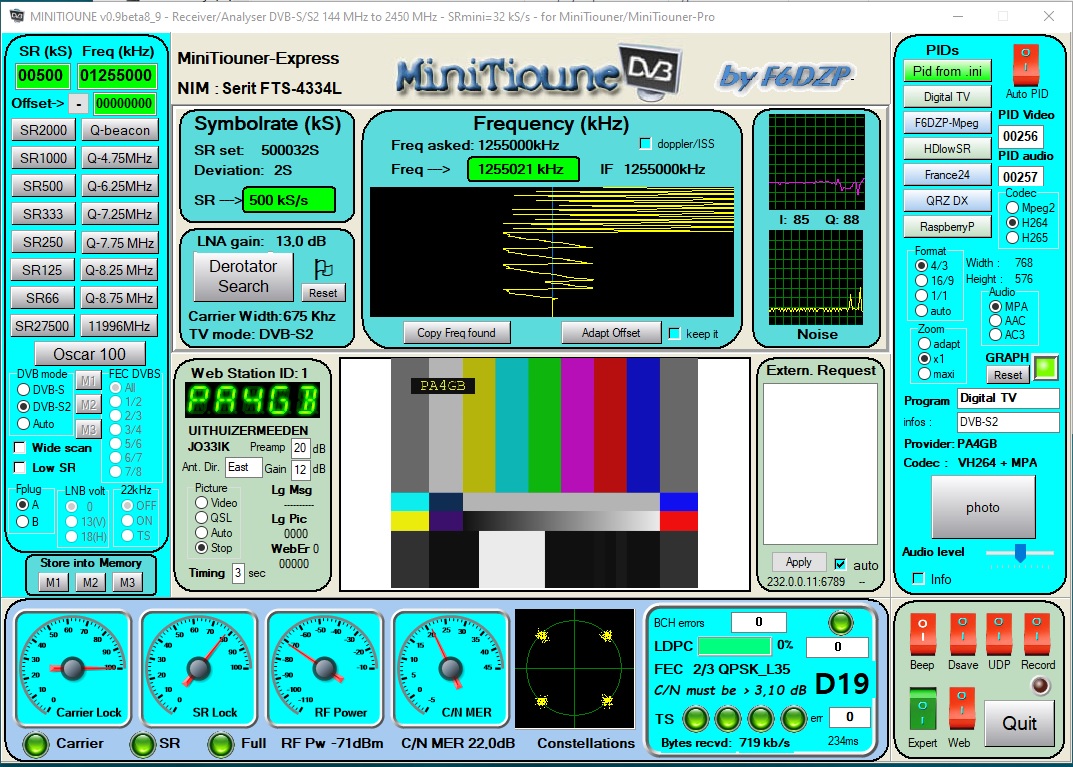

Tried with Pluto and datv express
1000kS
500kS

You cannot do the test using the Pluto and DATV express software that is very difficult to set for good result.
My first answer is not Minitioune cannot receive but DATVexpress software cannot give a good signal.
So for your exemple I say: your Pluto+DATVexpress software doesn't work at SR1000 or SR2000 with your Pluto.
I never use the DATV-Express software, this software has never been able to give a good TS.
Use the F50EO pluto firmware and OBS : information here https://wiki.batc.org.uk/Custom_DATV_Firmware_for_the_Pluto
and download here : http://www.vivadatv.org/viewtopic.php?f=60&t=692
Have you tried to receive the broadcast station from QO100/Es HAilsat or receive the QO-100 Beacon at SR2000?
