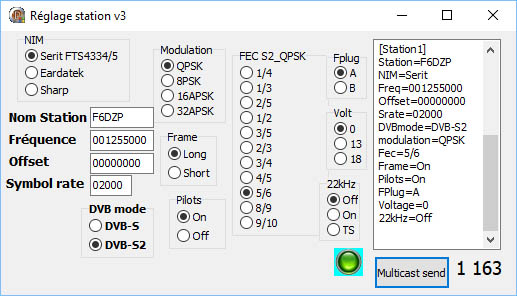

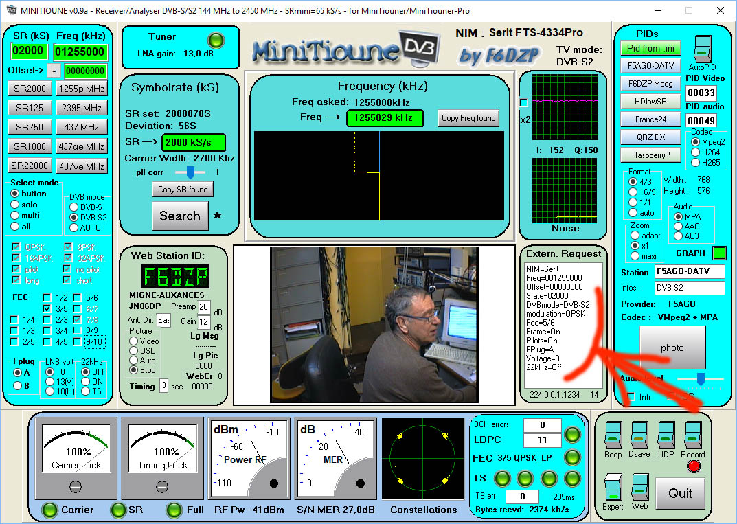

1) Next version (v0.9) will be able to receive commmands from another software via UDP.
beta version will be released very soon.
minitiouneV0.9 test.jpg (337.73 Kio) Vu 61222 fois
Minitiouning Multicast sender.jpg (74.56 Kio) Vu 61222 fois

yes you will be able to develop your own application that send UDP message to Minitioune.
