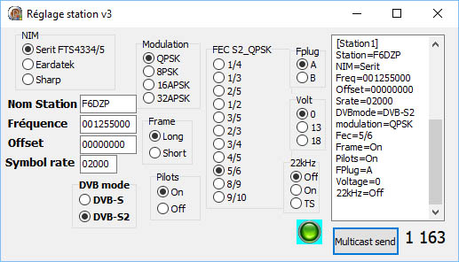

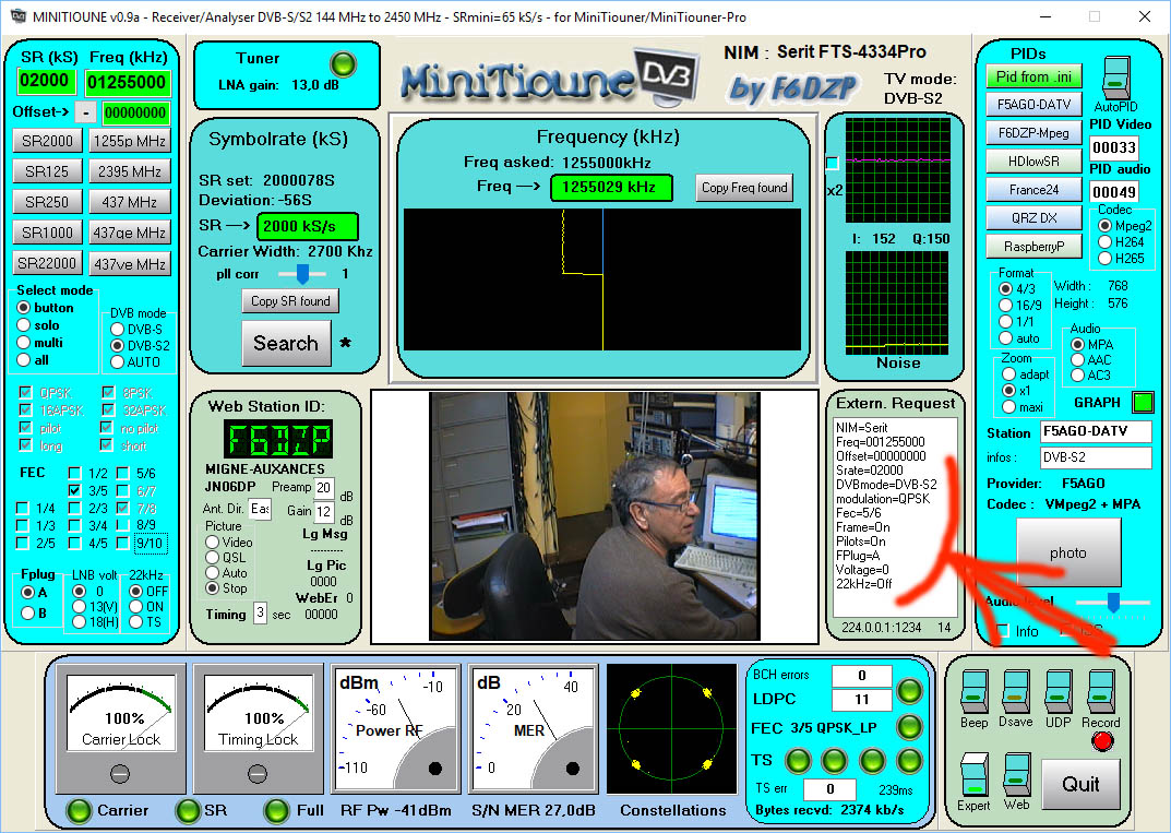

Messagede F6DZP » Lun 25 Fév 2019 05:23
OK now you have UDP running with VLC.
1) Next version (v0.9) will be able to receive commmands from another software via UDP.
beta version will be released very soon.
Minitiouning Multicast sender.jpg (74.56 Kio) Vu 61212 fois

Re: UDP stream howto visualise?
Messagede on4bhm » Mar 26 Fév 2019 12:47
Wil the UDP specifications be released?
so i can build my own vb.net app?
thanks
on4bhm
Messages: 13
Inscription: 14 Juin 2013
Messagede F6DZP » Mar 26 Fév 2019 20:55
yes you will be able to develop your own application that send UDP message to Minitioune.
