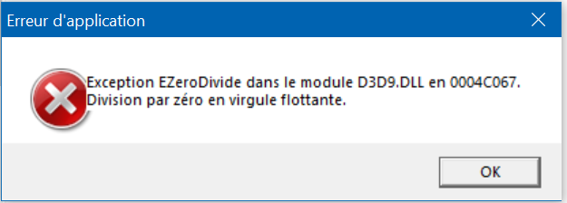

However, when I came to run CheckMiniTiouneDriverAndFilters_V0_5a.exe, I got the error as shown
d3d9 error.png (30.78 Kio) Vu 101280 fois
and nothing else happened.

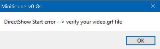

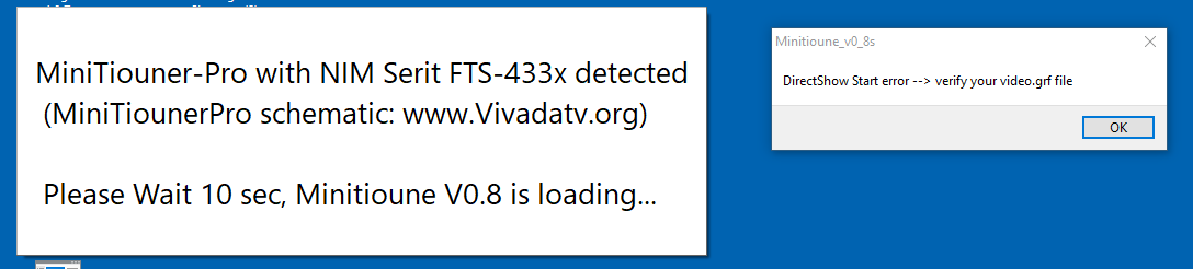

However MiniTioune_V0_8s.exe ran after double clicking on it albeit, after receiving this as an error
. The only indication that something was wrong was the red indicator in MiniTioune for the "Graph"

If I force it to use the NVIDIA card, I get also the error message "DirectShow Start error -> verify your video.grf file.
If I click Ok, the Minitioune screen appears but I have no display (GRAPH always RED)
I have not found the problem
Pb NVIDIA.PNG (17.24 Kio) Vu 101257 fois

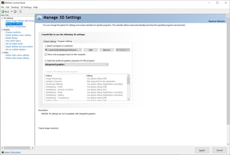

Edit - I have a kludge solution which is to use the Nvidia graphics preferred graphics settings. Like this -
sorry for the low resolution - forum limits.
This does work but you need to do this setting for each programme and every time they change.
g0mjw

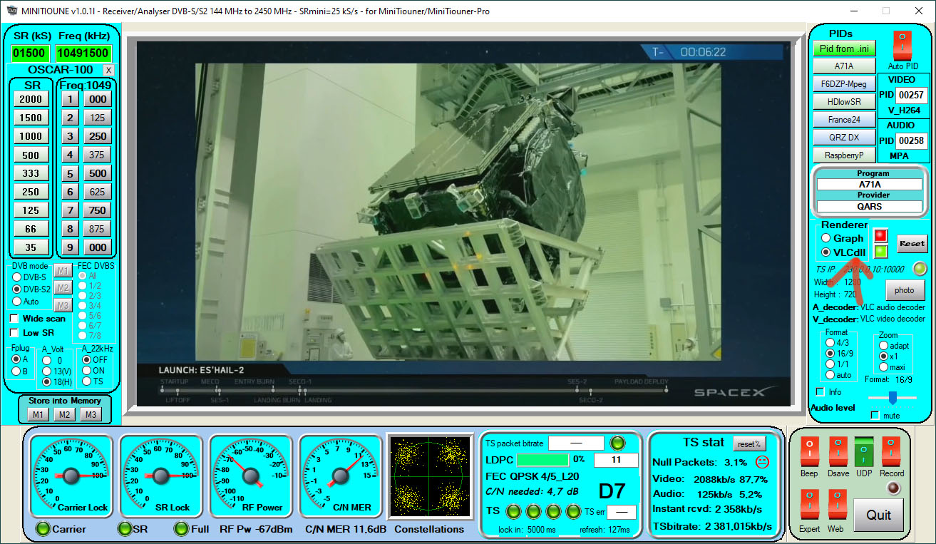

The new version of Minitioune can work also in VLC rendering mode . If you have dual screen, just write in the .ini that you want that Minitioune starts in the VLC rendering mode.
I use it very often on a dual screen system, we can also see Minitioune with left half on the first screen and right half on the second screen. we see the video on both monitors.
My main screen is a 4K 43" screen and the secondary screen a full HD screen
Minitioune_v1010_showing VLC rendering mode.jpg (367.39 Kio) Vu 97386 fois

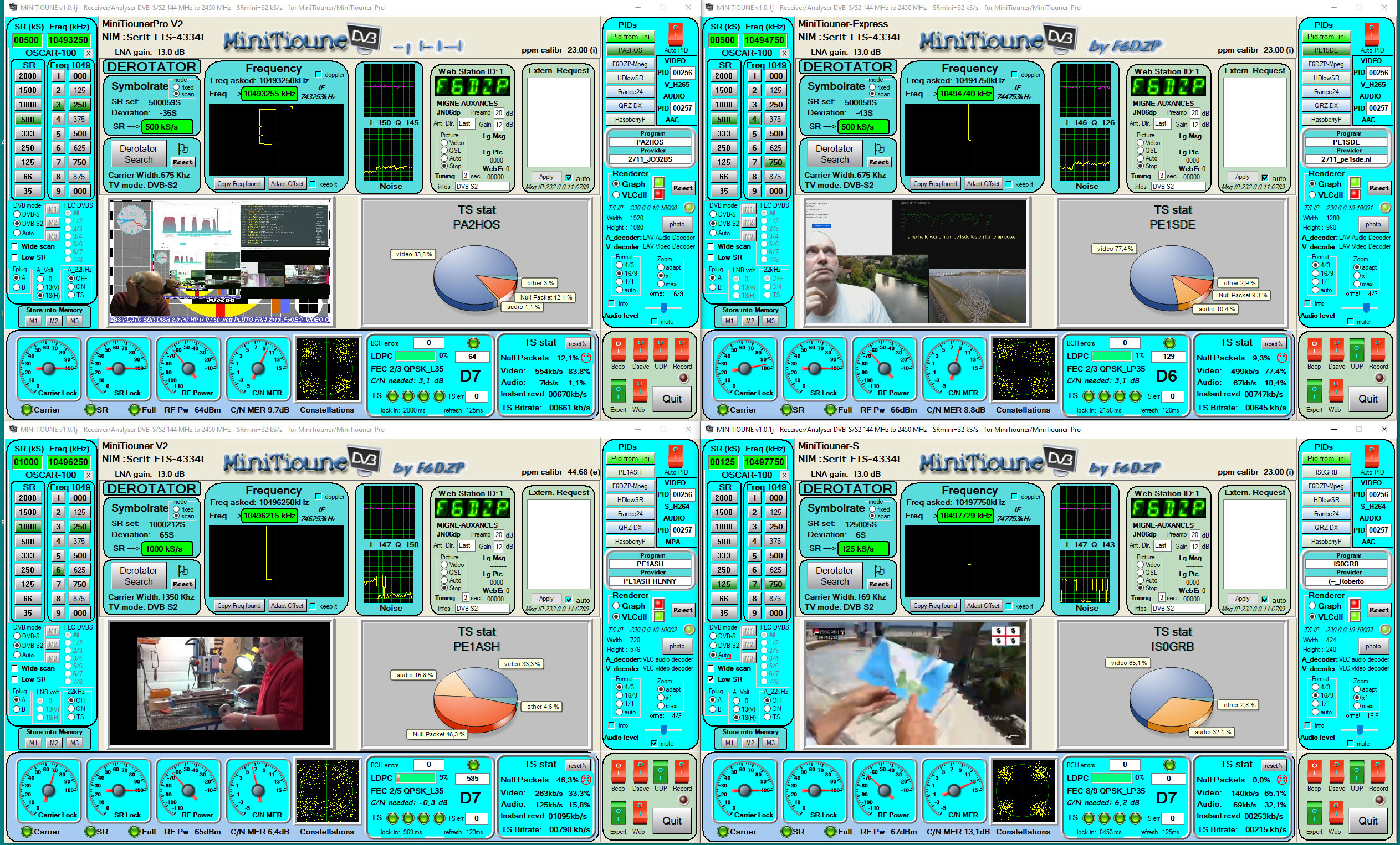

I can show how I can work with 4 Minitioune at same time on one computer and receive at same time 4 different stations
4xMinitioune_working at same time_RX4different stations.jpg (1.67 Mio) Vu 97386 fois
as you see we are not limited by the size of the picture on this forum
