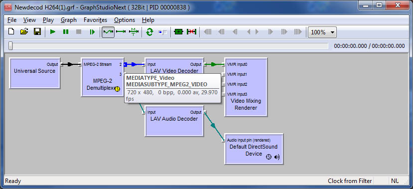

Re: Suddenly no H264 video (v0.5a or v0.6d on Win10)
Messagede F6DZP » Dim 14 Mai 2017 10:14
OK we have found the problem:
when I look at your "newdecod H264.grf" file, I see that the video out pin of the Microsoft demultiplexer says that it is a Mpeg2 video.
So it is norma that it can't decod the H264 encoded video.
bad H264 grf file from Ken W6HHC.jpg (84.16 Kio) Vu 60913 fois
so your "decod H264.grf" file is corrupted, you have just to take the good one that is in the Minitioune package.
Messagede W6HHC » Dim 14 Mai 2017 13:40
Thank you Jean-Pierre F6DZP,
SUCCESS! My H.264 problem was "self-inflicted". While modifying the MiniTioune decodeH264.grf file (to suggest LAV filters to Win10), I accidently corrupted the file.
