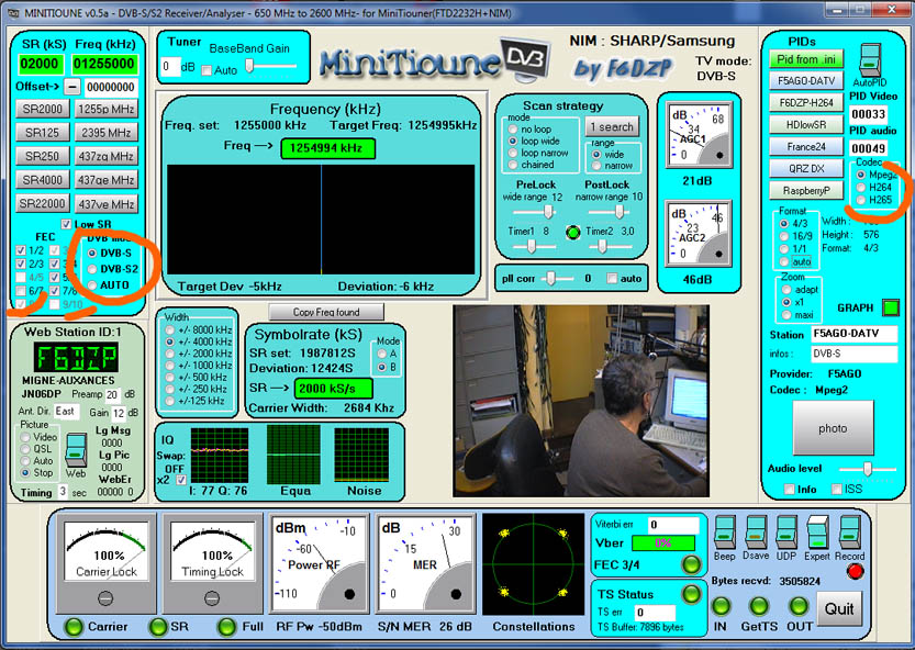

• Useful for a PIPO,
o A click on vu-meter « MER/SN » changes standard/Expert mode
o A click on vu-meter « RF Pw » switches the AutoPID button
o A click on vu-meter « TimingLock » changes the DVB mode(DVB- S, S2, Auto)
o A click on vu-meter « CarrierLock » asks a new lock (= « 1search »)
o In standard mode, un click on thea video changes the display format ( = Echap)
• There are new FEC values for DVB S2
• We can preset the BBgain value and the lowSR/highSR mode
==> The file Minitioune.ini is now different with the new FEC values and the new possibility to preset BBgain and LowSR.
==> There is a new file « H265 decod.grf » for H265 decoding.

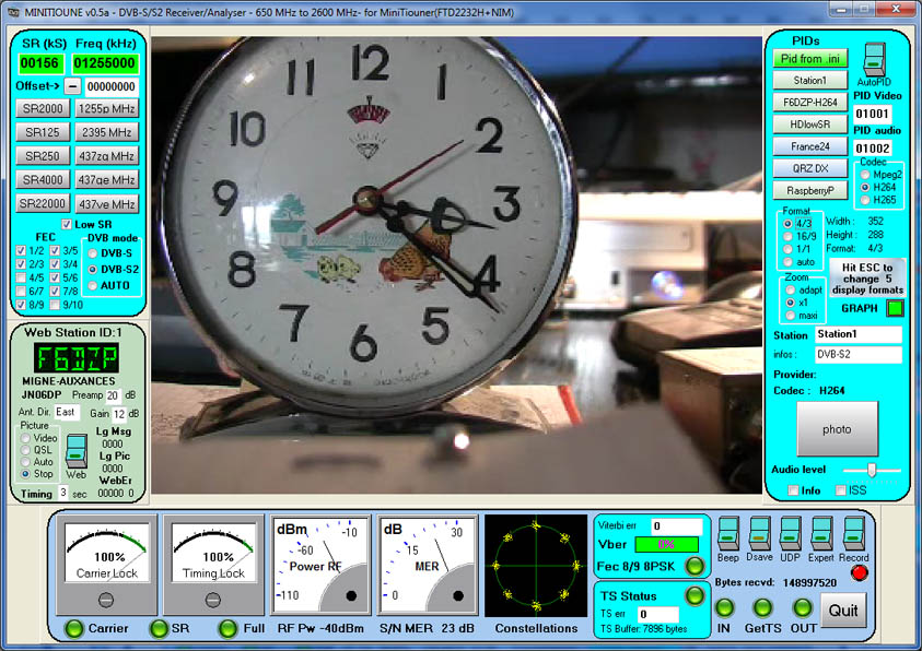

DVB-S SR2000 new options_.jpg (209.37 Kio) Vu 22444 fois

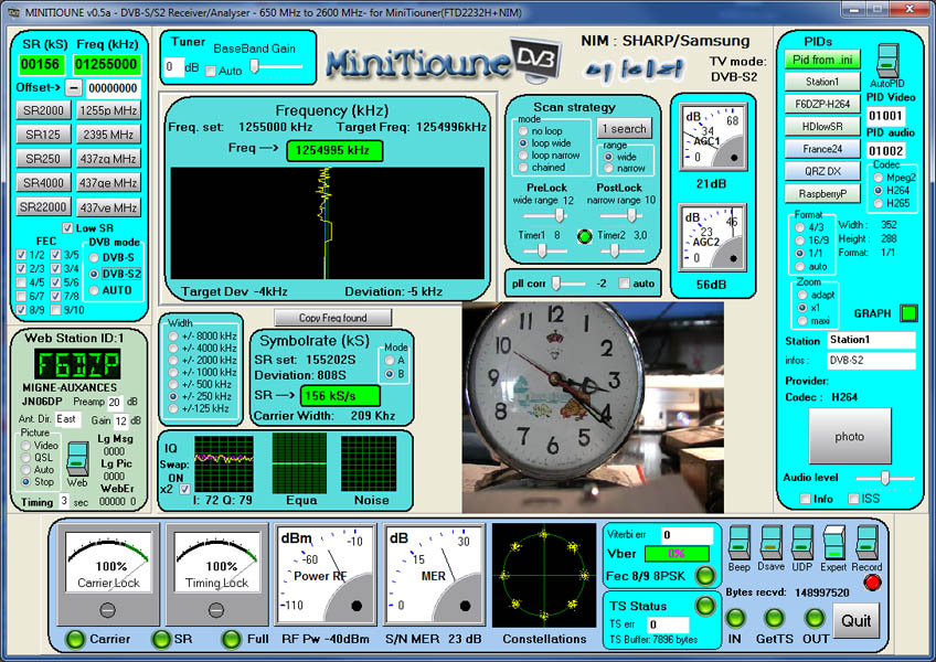

DVB-S2 8PSK SR156_.jpg (212.4 Kio) Vu 22444 fois
This video is received at only SR 156 kS/s !!
DVB-S2 8PSK SR156s_.jpg (172.9 Kio) Vu 22444 fois
