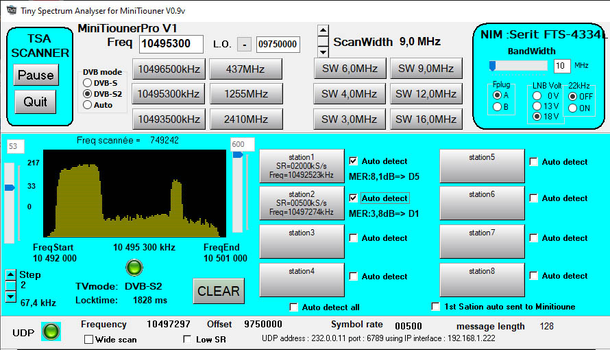

I understand what you are asking, I work on it since 3 months.
I prepare solution with a scanner made by the NIM and that will be included in the MinitiounePro software
the software in near to be finished as a stand alone tool. Thios software send order to Minitioune when you click a button.
QO100_scanBandwidth 9MHz détection 2 stations.jpg (155.87 Kio) Vu 147284 fois
and I include it in Minitioune to obtain a new software "MiniTiounePro" that will do at same time receiving and spectrum analyzer with station data detection... I suppose that it is what you wish??

Messagede F6DZP » Jeu 10 Oct 2019 21:07
this spectrum analyzer send by UDP all information it can get.
actually it send to Minitioune : Freq, SR, offset, DVBmode, Fec
and can display RFlevel, MER, Report ( D0 ... D5 ... Dn) that shows if that signal can be decoded (= enough strength for the Fec used), I could send this data by UDP but Minitioune don't needs them, so I have not done.
it is sent using Multicast UDP protocol so = broadcasting
But as this software will be inside Minitioune, we don't need the BATC spectrum: we will have the spectrum in Minitioune software including all information about each station present.
In that way we do not need Internet connection. good also for portable stations.
