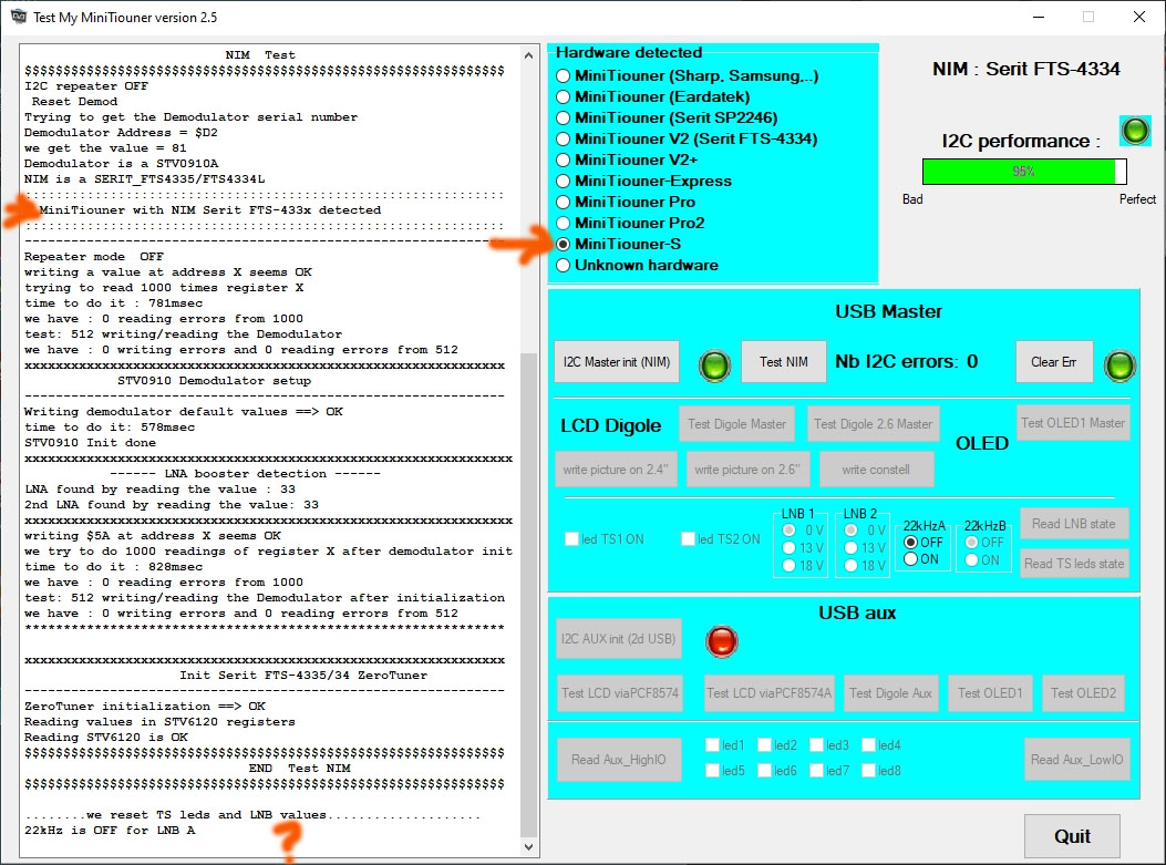

Using Software "MiniTioune V0_9_9_1h" (what is the latest as far as I know) I can't swith LNB Voltage and measured 0V on both Tuner A/B. Switch is greyed out.
Using Software "Test My MiniTiouner V 2_3" the I2C performance is around 90% and Voltage switch for LNB A/B also greyed out. I guess there is a Version 2.5 but can't find.

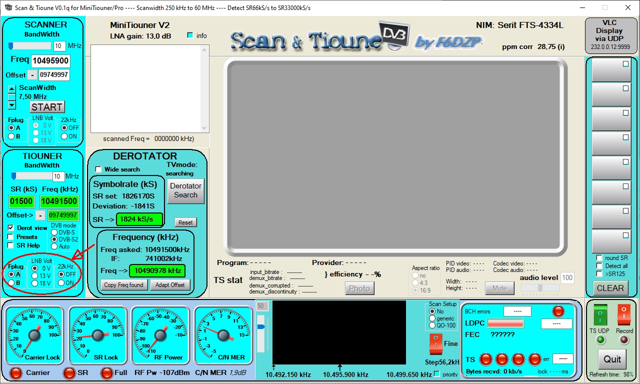

Using Software "Scan & Tioune V0.1p" I can switch between 0V/15V/18V, but just on Tuner A.
Testing with "Check Minitioune Driver and Filters V0.4a" all lights green.
Anyone have an idea what could be wrong? Do I usse the correct software versions?

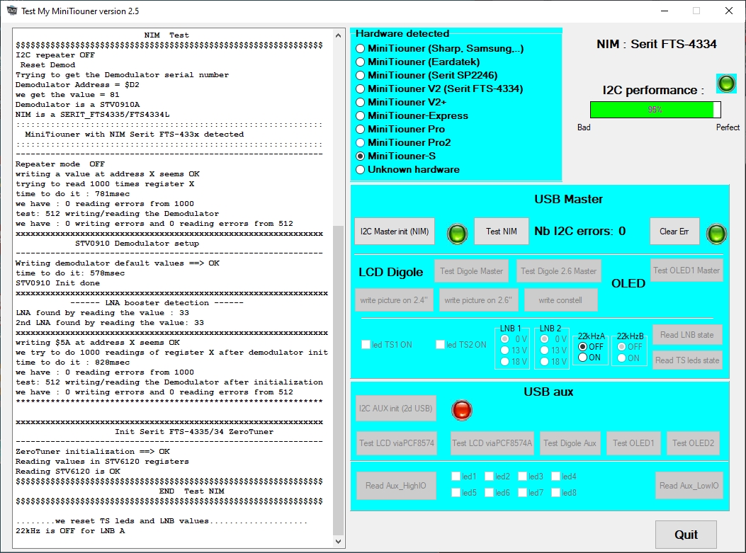

"Hardware detected..." jumps to "MiniTiouner V2 (...)"
Here is what I got, quite different to the screenshot in the Manual.

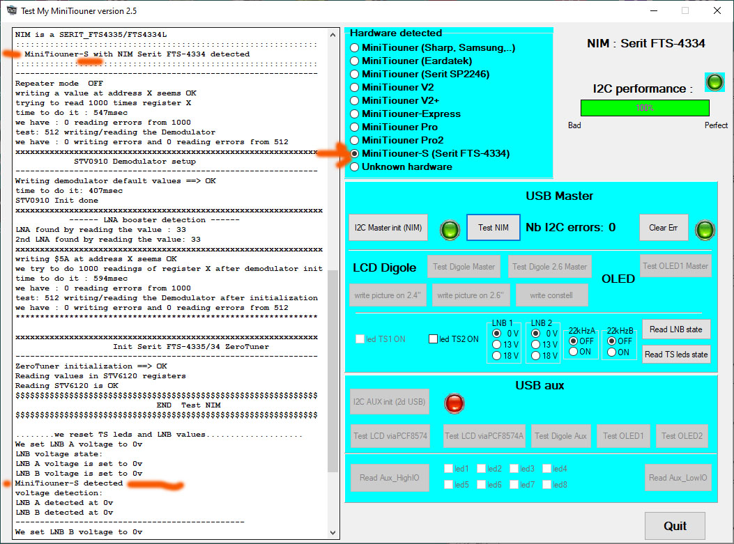

Yes there is an issue with your equipment.
The test should show:
MiniTiouner-S well detected.jpg (378.13 Kio) Vu 87747 fois
but your test cannot work the LNB voltage switch, so you obtain:
MiniTiouner-S NOT well detected.jpg (276.2 Kio) Vu 87747 fois
so there are 2 possibilities:
- your MiniTiouner-S has an issue with the LNB voltage switch command.
or
- your computer or USb line(noise, busy ?) or ??? cannot execute the I2C order to switch the LNB voltage.
Could you test your MiniTiouner-S on another computer?

When I tried "Scan & Tioune V0.1q" I have LNB 0/13V/18V" on Fplug A (but not on B). A little success ...
