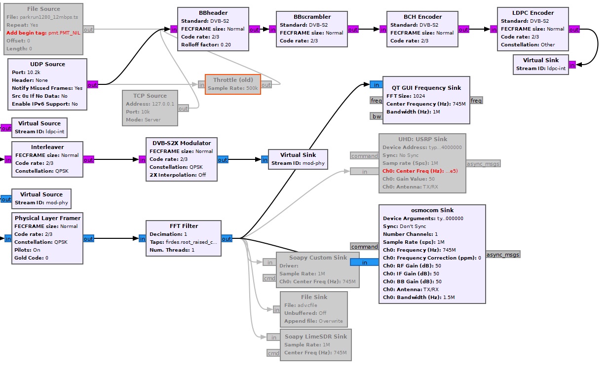

Messagede SV8ARJ » Ven 10 Mai 2024 08:08
Hi Dominique, what an amazing utility you have created !
I have a LimeSDR USB (not the mini) that is working fantastic.
I also have an Ettus B200 that would be great to be included in the list.
I can use it through gnuradio companion grabing your UDP stream going for Pluto just fine.
But it would be perfect to have a single user interface.
Both osmocom and UHD sink work fine with no issues.
My best regards
George / SV8ARJ
TXing from B200 using stream to 127.0.0.1:10200 from DATV-Easy
2024-05-10 10_55_35-dvbs2_txUDP-2024.grc - D__u_QO100.jpg (204.6 Kio) Vu 924594 fois
SV8ARJ
