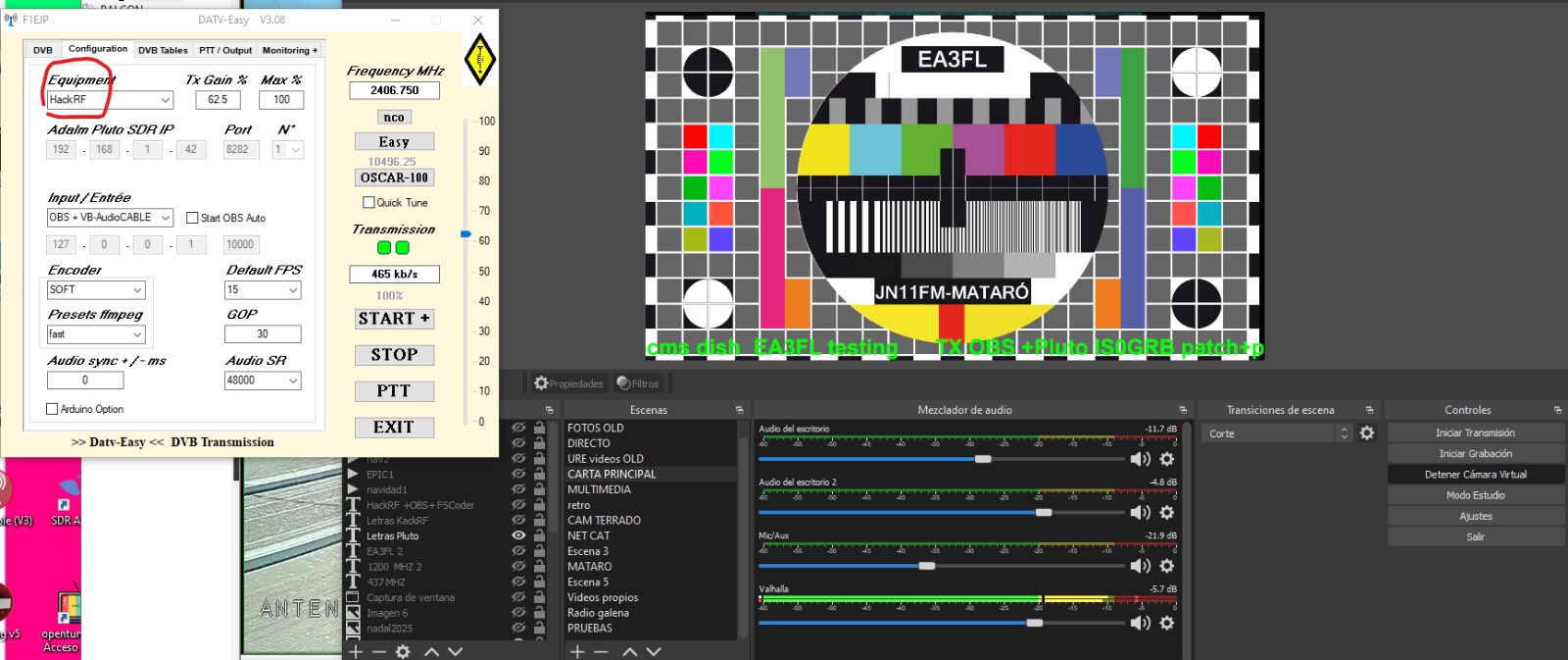

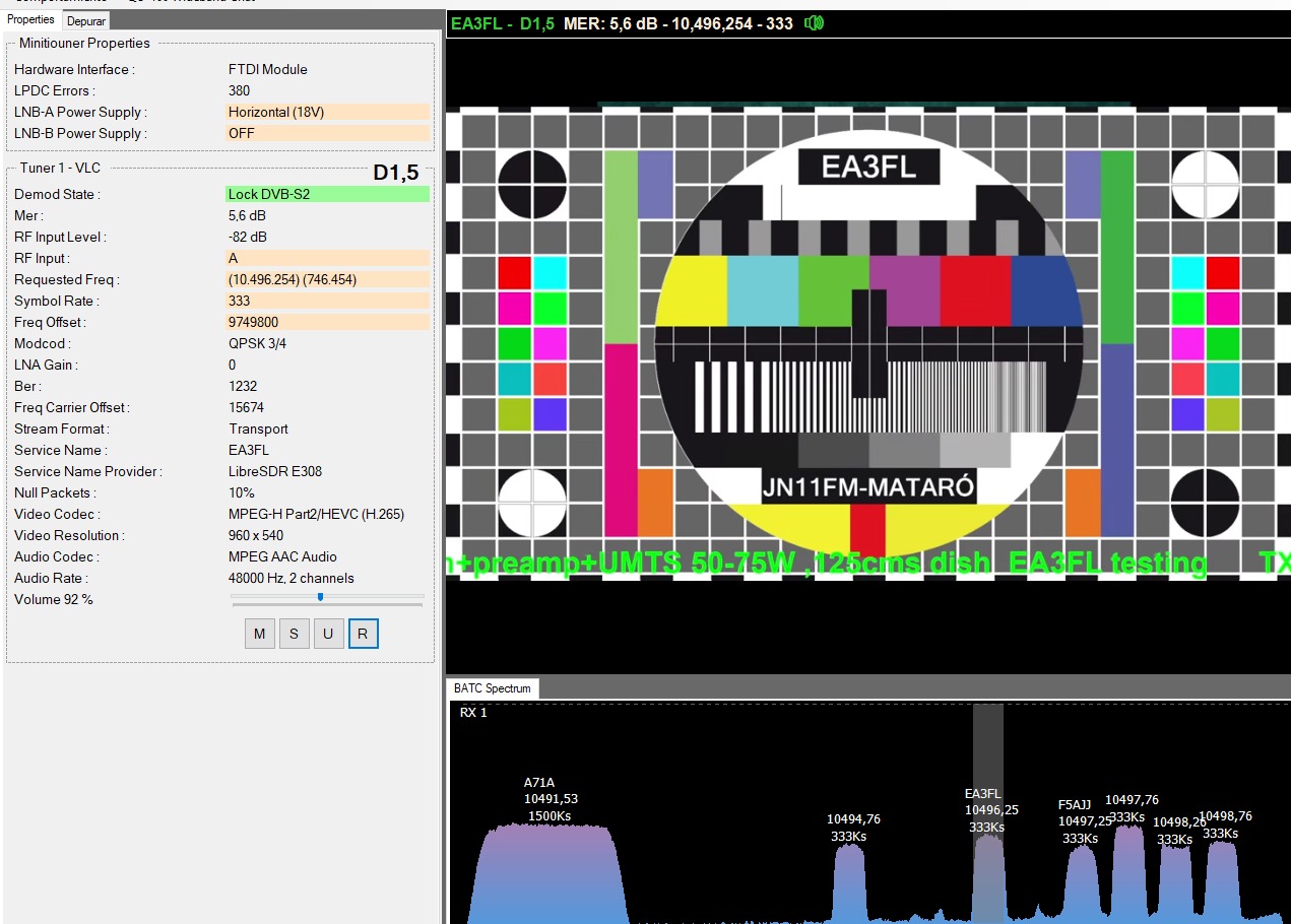

Postby EA3IGB » Sat 4 Apr 2026 11:08
Test Easy & HackRF
WhatsApp Image 2026-04-03 at 11.45.55.jpeg (208.21 KiB) Viewed 372698 times
WhatsApp Image 2026-04-03 at 11.45.18.jpeg (205.1 KiB) Viewed 372698 times
