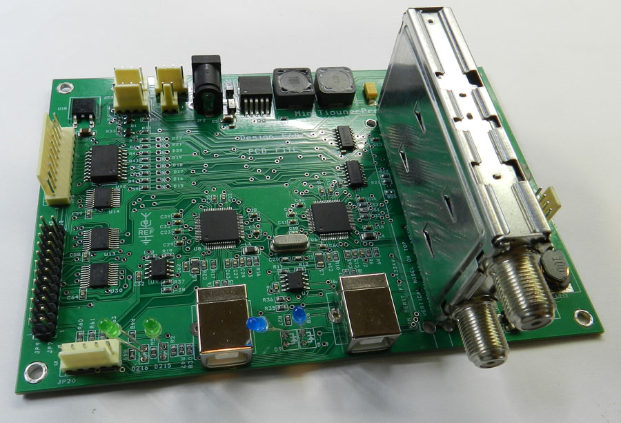

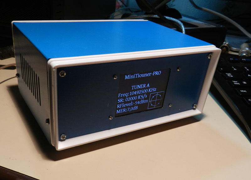

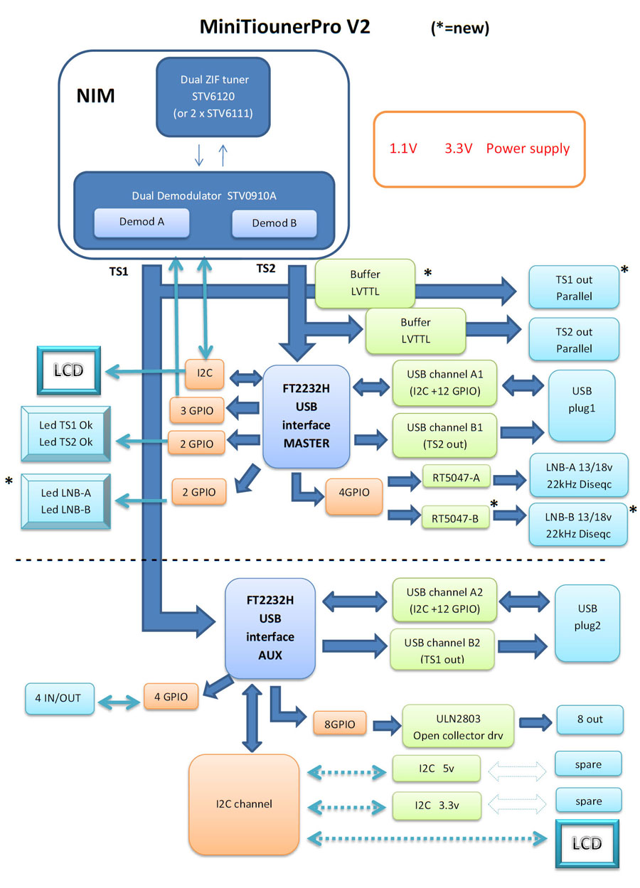

In 2 weeks we will have the MiniTiounerPro V2.
Many features can be found on this receiver:
- ready for receiving 2 stations at same time (useful for Duplex on Oscar-100) using next Software Dualtioune.
- 2 x RT5047 that produce 13v or 18v (400mA protected) for your LNA or LNB, one separate voltage for each different F-plug
- the MinitiounerPro has a design that allows the lowest I2C noise , Minitioune refresh rate can be 100ms (180 ms with a very slow processor like the Atom processor in my Pluto or Chuwi Tablet)
- 2 leds indicating TS1 and TS2
- 2 leds indicating LNB A/B voltage
- allows the use of LCD or Oled display
- TS1 and TS2 parallel output => we can use for developing IP interface or direct transmission to a modulator or ...
- 4 GPIO input/output
- 8 output ( with 8 leds) to drive relays, preamplifier ... depending the RF band you are using
The MiniTiounerPro V2 is ready for all future developments.

Messagede DL4OCH » Lun 20 Mai 2019 18:37
Hi all,
my MiniTiouner Pro V2 arrived today and works fine with one exeption:
There is no 22kHz on Tuner B, only on A. 14/18V works fine. Is this still a software-issue, or had I bad luck with mine from REF.
Also I would like to know, when the dedicated software for this MiniTiouner will be available...
vy73,
Wilm, DL4OCH
DL4OCH
Messages: 10
Inscription: 30 Mar 2019
Re: MiniTiounerPro V2
Messagede F6DZP » Lun 20 Mai 2019 20:32
Yes I have not implemented yet the 22kHz for the B input. thank you to remind me , Sorry I forgot to do it. the V2 of MiniTiounerPro is very new and I had to time to finish the new options for it .
So yes it is a software issue (beta version), but not very complicated to fix.
When the MinitiouneV0.9 will be definitively finished (I hope I am very near the end) I will work on the software Dualtioune that allows to receive 2 stations. This software already exists but works only with DVB-S mode, not DVB-S2, so I will upgrade it with the final procedures used for Minitioune.
