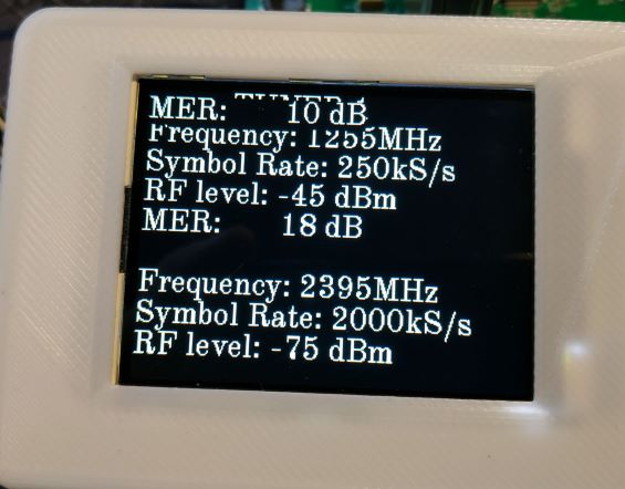

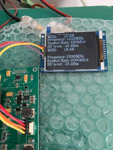

Messagede ik8ozv » Sam 25 Jan 2020 12:17
F6DZP a écrit:You can test your disply using the software "TestMyMinTiouner"
Hello Jean-Pierre and all,
i have tried the Digole Display with the "TestMyMiniTiouner_V2_0" program
as suggested me from Jean-Pierre but i have noticed that i do not see it verry good.
As you can see in the posted picture the write "TUNER" is not shown free but there
is the write"MER: 10dB" hides the TUNER write.
Please what could it be?
How to fix it properly?
Thanks
Enzo IK8OZV
PC= I9 / Win10-64bits.

Re: Display connection
Messagede F6DZP » Lun 27 Jan 2020 06:07
I can say nothing as you say nothing.
is it a 2.4" or a 2.6" or ???
which button do you use for the test?
Messagede ik8ozv » Lun 27 Jan 2020 06:29
Hello Jean-Pierre.
It is a 2.6 one
Thanks
Messagede F6DZP » Lun 27 Jan 2020 18:01
OK I have the same problem with the test software. I Will fix that. sorry for the inconvenience.
but the Digole 2.6" works well using Minitioune. This issue is only with the test software.
Jean-Pierre
Messagede F6DZP » Mar 28 Jan 2020 05:02
The zoom factor is too much in the test software, so all lines cannot fit in one screen so the last lines start again at the top of the screen and erase part of the screen...
it will be fixed in the next release of all tools.
