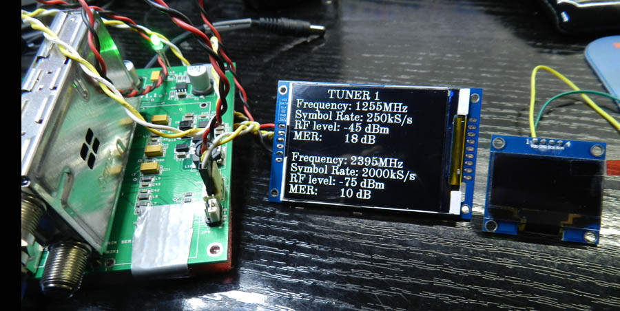

On the photo you can see a Digole LCD 2.6" 320x240 True color IPS

you can see the difference between a Digole LCD 2.6" and an OLED 1.3"
test LCD digole 2.6 inch_.jpg (121.2 Kio) Vu 93829 fois
So the Digole 2.6" will be more useful for next software DualTioune as it can display 2 stations parameters
