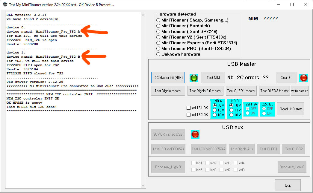

Re: Help on error Program
Messagede ik8ozv » Dim 22 Sep 2019 08:41
Hello Jean Pierre,
I have used since a cuple of weeks ago as i had assembled it and it worked with no problems.
I had to store it for a wee as i had to take off the dish from the balcony for mainentence.
Yesterday i had mounted again the Dish and tried.
This is what i get now when i run the TestMyMiniTiouner.
If you n eed more details please let me know what you need and how to do it
Looking the Minitiouner from the front( Power connect on the front ) i have connected the dish on the
upper connector and the USB cable on the right connector.
Please can you tell me what to do?
Thanks
Enzo
Messagede F6DZP » Lun 23 Sep 2019 04:11
I also don't know if you are using a MiniTiouner V2 or MiniTiounerProV1 or V2 or ????
You have not answered to my question.
How I can help you if I don't know what you are using.
We are in the MiniTiounerProSection of the Forum, so I suppose that you have a MiniTiounerPro, in another case you should have publish your question in another place...
So:
If this is a MiniTiounerPro, your Eeprom is not well programmed.
If this is a MiniTiounerPro you must have:
When ypou receive a MiniTiounerPro, it is already programmed, you have nothing to do, it is ready to use.
I suppose that you have re programmed the MiniTiounerPro with the data that are for the MiniTiouner, not the MiniTiounerPro.
So the error message says the truth : you must re program the MiniTiounerPro with the good data.

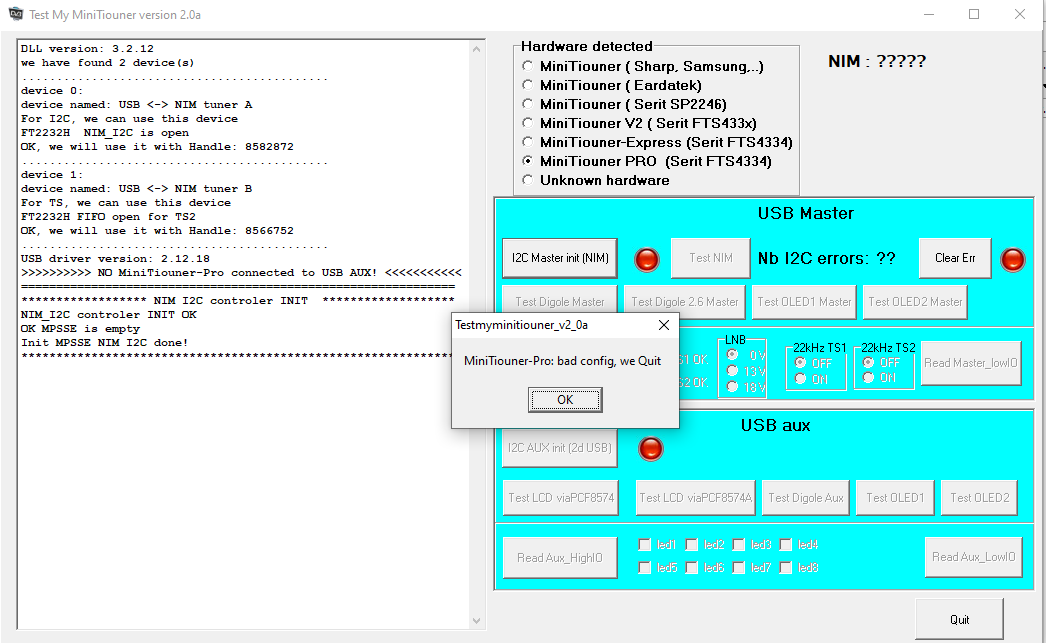

Messagede Jabi » Jeu 2 Fév 2023 14:59
Hello Jean Pierre:
I have the same problem on one computer. On the other one it works perfectly with the same connection cable. What can I do? I have uninstalled and installed the programs again but it still doesn't work. Any ideas? Windows 11...
73,s de Jabi, ea2aru.
