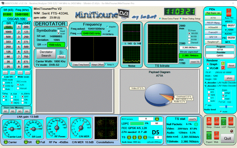

If I select Graph mode MiniTioune program locks up and have to use CTR ALT DEL to close it.

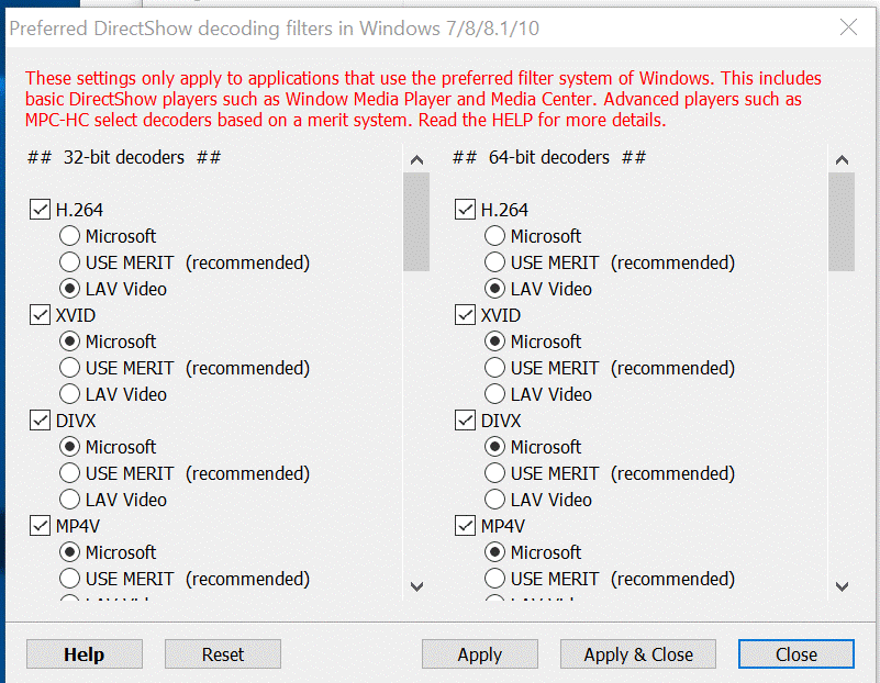

There is no change in how my MiniTioune responds do I have to make any other changes to the settings?
Do I need to change preferred decoder settings if so to what?

Messagede g8koe » Ven 18 Juin 2021 17:24
I have turned off FFMPEG HW acceleration in VLC and HW acceleration in MT as suggested by John G7JTT.
Also have tried the two latest versions of Nvidia drivers.
Non of the above worked.
If I select Graph mode MT locks up.
Are other any other suggestions that I could try.

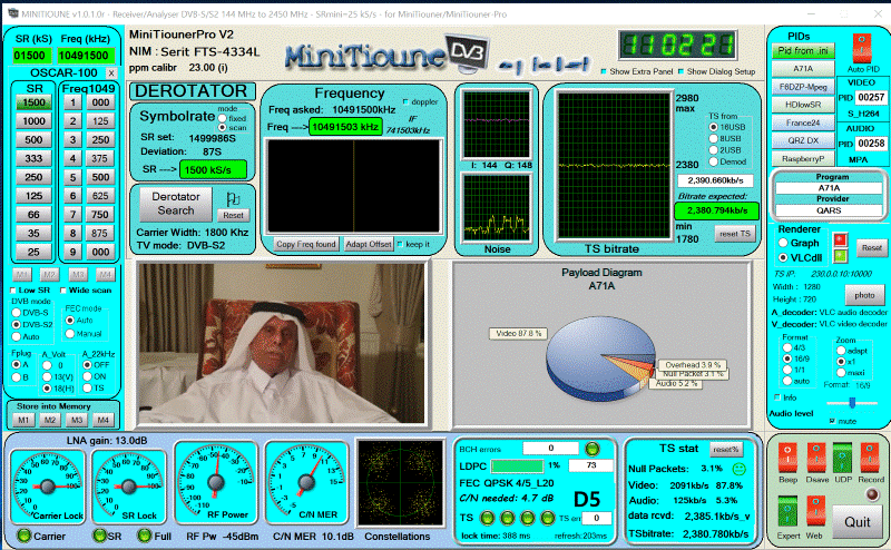

Re: MiniTiounerProV2 Graph HELP
Messagede g8koe » Lun 21 Juin 2021 08:28
VLC did an up date and MT stopped working in Graph mode.
I have two monitors connected to my PC and had MT always starting in my second monitor by setting the position in config.
Now changed config so MT starts in my first monitor.
MT now works as it should including enabling HW accelerator in VLC and MT.
If I move MT in Graph mode so display is half on monitor 1 and half on monitor 2 only the half on monitor 1 displayed the video the other half is black.
VLC mode works with half of picture on each monitor.
Hope the information may be of help.
Martin
