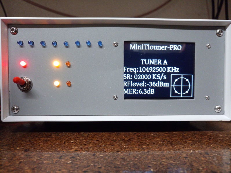

Re: MiniTiounerPro2 et écran Digole
Messagede F6FCD » Ven 1 Nov 2019 05:01
Ci-dessous mon nouveau coffret avec l'écran 2.6" de Digole.
PC= I7 / Win10-64bits.

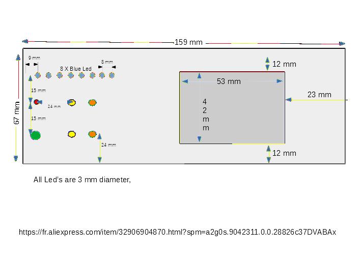

Messagede ik8ozv » Mer 29 Jan 2020 19:57
F6FCD a écrit:Bonjour,
i saw your case that it seems it is the same as mine one.
I like the layout of the LCD the Switch and the LEDs.
Please doi you have a layout that i can copy and make the panel as your one?
Or can you send me the measurements?
Merci'
Enzo IK8OZV
Messagede F6FCD » Jeu 30 Jan 2020 07:29
Hello Enzo,
I do not have a layout of my front panel, but in order to be pleasant, I can make measurements, and send them to you
or dispose here on the forum, may be it can help other builders.
73, Lionel
Messagede ik8ozv » Jeu 30 Jan 2020 08:17
F6FCD a écrit:Hello Enzo,
73, Lionel
Hello Lionel,
i will really appreciate it.
Enzo IK8OZV
Messagede F6FCD » Jeu 30 Jan 2020 08:46
I tried since last message to do my best, please find attached jpg front panel.
Done with "libre office draw", I can send you original file in odg format, let me know and email adress via MP.
Messagede F6FCD » Jeu 30 Jan 2020 08:52
Enzo,
Found your adress on Qrz.com
Just sent you my original files.
73, Lionel
