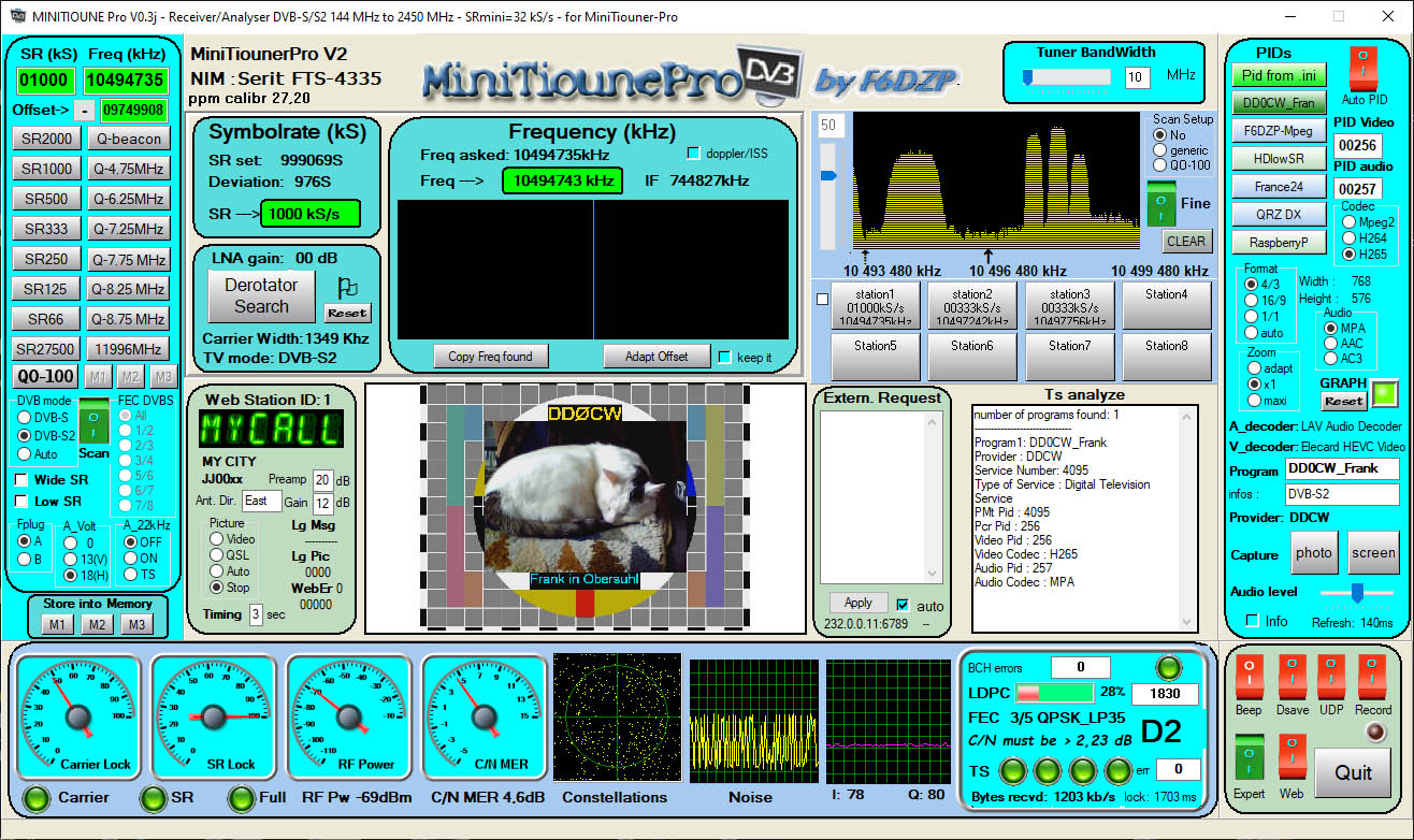

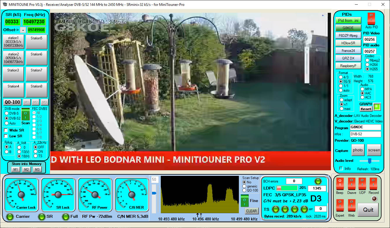

MinitiounePro V0.4 Expert mode receiving.jpg (341.91 Kio) Vu 54087 fois
MinitiounePro V0.4 standard mode receiving and scanning.jpg (267.54 Kio) Vu 54066 fois

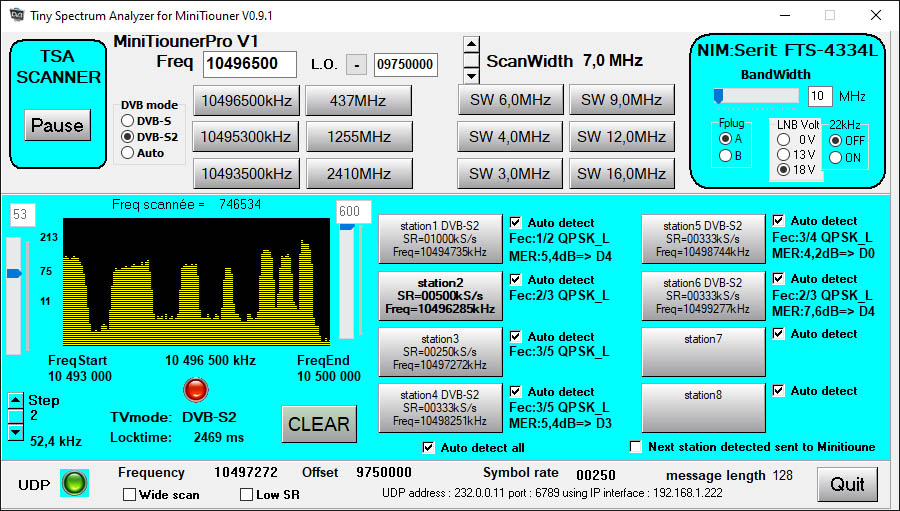

TSAv0.9.1_ 6 stations_4detected.jpg (182.23 Kio) Vu 54079 fois

Messagede g0mjw » Sam 18 Jan 2020 11:24
Looks good. Does it also do the second TS ?
g0mjw
Messages: 12
Inscription: 17 Juil 2011
Re: MinitiounePro bientôt
Messagede F6DZP » Sam 18 Jan 2020 11:36
We have 2 demodulators, so
- the first can receive and decode
- the second scan and detect ( can be another band)
and next evolution
- the second can receive and decode a different station.
But we cannot have 3 functions at same time, we must choose :
scan one band and receive 1 station
or
receive 2 stations
or
scan 2 bands
next step will be to be able to have the 3 choices. But have to wait after publishing the actual version to know what must be changed or enhanced..

Messagede g0mjw » Sam 18 Jan 2020 12:05
Thanks - makes sense. There are only two physical tuners after all. I am not sure I can withstand the anticipation (:
