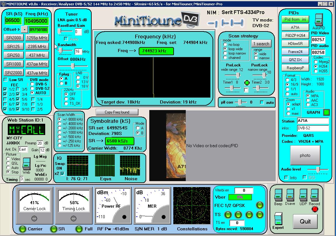

Bonjour ,
J'ai une probleme avec decoder le signal video. le plus part de l'image reste gris.
Avec le test tous es verte.
en englais :
( I have a problem with the software, all received images are half Grayed. on astra and eshail this is the same.
If i run the program to check the codecs, All are green and working. )
73 Jan, ON6ZG / DL6ZG

Messagede F6DZP » Mer 13 Fév 2019 21:28
I suppose that your are using win10 and some update do that. (specially with some graphic processeur like that we can find in a Pluto)
It is not a problem only with Minitioune but also with other software that shows video using Windows .
It is a Windows driver problem.

Messagede ON6ZG » Ven 15 Fév 2019 13:43
Hi, Jean-pierre.
It is a windows 7 32 bit running on that computer ( a small atom processor ) but vlc is working and playing TS video without problems.
73 Jan

Messagede F6DZP » Ven 15 Fév 2019 21:42
yes for VLC because it uses its own procedure for showing the video, VLC is made for different OS.
But if you use any other software that uses windows Video renderer, you will have the same problem.
It is a problem of a Windows graphic drivers for little processeur like atom or others that we can also find with a Pluto.

Messagede ON6ZG » Dim 17 Fév 2019 19:21
ok, merci Jean-pierre, I will have to use another computer then. that is the easiest solution :)

Messagede F4GEV » Mar 19 Fév 2019 22:37
Hello Jean-Pierre,
i have the same problem on a DELL computer with WIN10 and CORE i5 processor.
Help ;)
