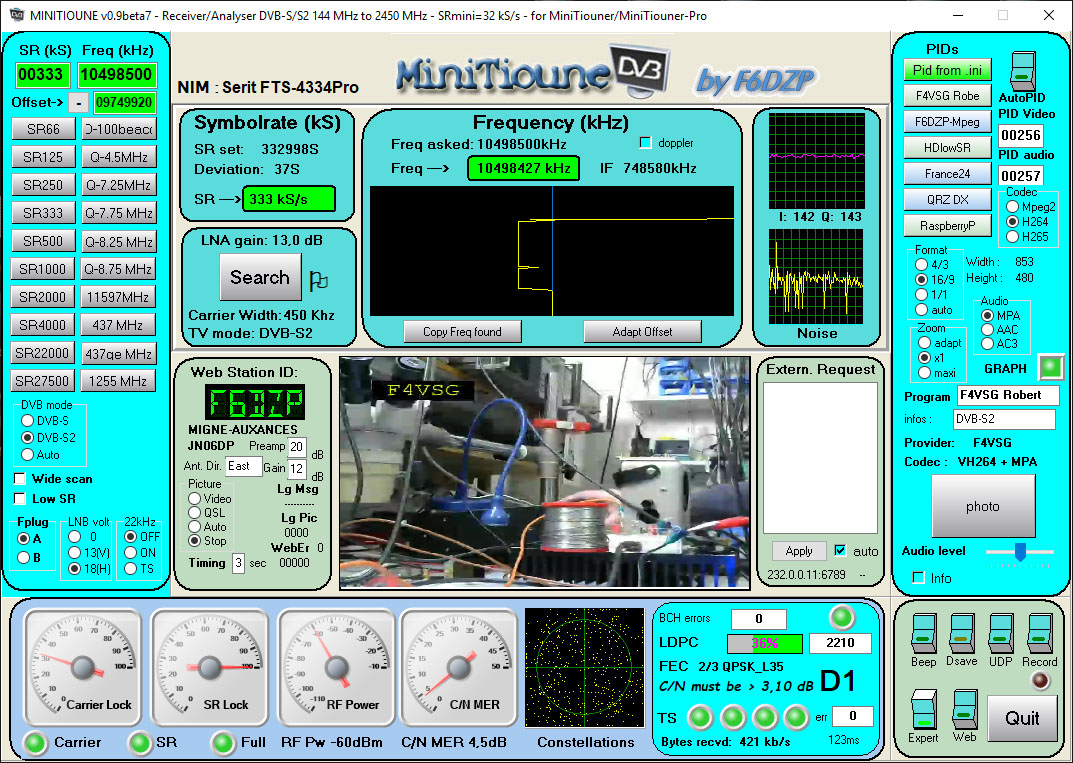

Messagede F6DZP » Lun 1 Avr 2019 10:24
Voici l' évolution avec aussi le médicament qui élimine les effets de mauvais affichage: (cliquez sur l'image pour la voir en entier)
MinitiuneV0.9beta8 Expert mode new features.jpg (410.18 Kio) Vu 115340 fois

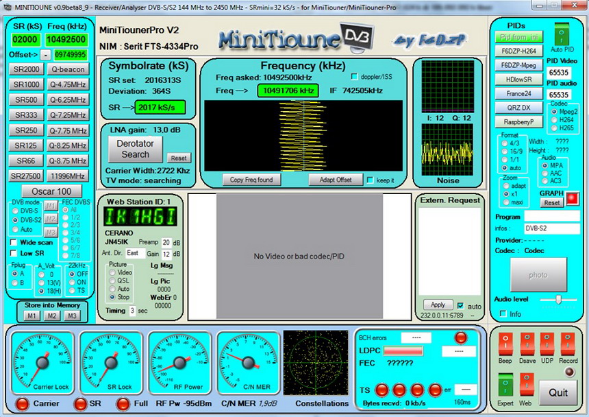

From today we are receiving with the new MiniTiouner V2 great the author F6DZP Jean Pierre
of his project and the new version 9 program is not difficult to install just understand the function
of his configuration of the various tests
https://www.qsl.net/ik1hgi/atv/sat-q-o100/arabo.mp4
new MiniTiouner V2
http://www.vivadatv.org/tutioune.php?om_id=IK1HGI&station_id=1
73 ik1hgi Tony
