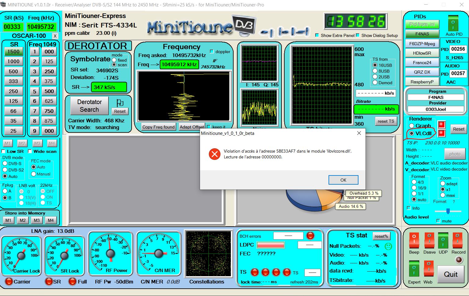

I am having problems between MiniTioune v1.0.1.0r and VLC. I run Windows 10 and installed VLC 32 and VLC 64 but seems Minitioune does not send anything to VLC via UDP.
I enabled VLC and Minitioune in Windows firewall through, also tried to downgrade VLC to earlier versions but nothing so far.
When try to enable VLCdll on the Renderer it comes up with the error message in the attached image.
error message
If you can provide some directions, thank you.
Ed PY2RN

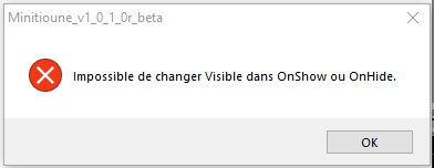

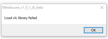

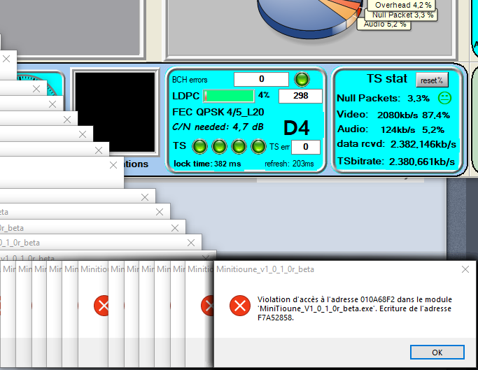

When I'm starting MiniTioune I'm getting 4 error messages each after quitting the present one. The 4th one comes multiple times as you can see on the picture. It seems that a library is missing but don't know why and what library is missing.
1st error message.png (6.76 Kio) Vu 78200 fois
2nd error message.png (3.75 Kio) Vu 78200 fois
3rd error message.png (5.24 Kio) Vu 78200 fois
4th error message.png (83.92 Kio) Vu 78200 fois

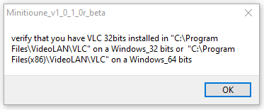

Messagede F6DZP » Mar 12 Oct 2021 14:13
VLC 32 bits must be installed!
it seems that is is not installed on your computer.
You have only the 64 bits version installed.

Hello Jean-Pierre,
error message 1 says that on 64 Bit PC vlc64 should be installed and on 32 Bit PC vlc32 should be installed.
Nevertheless I tried to install vlc32 additionally to existing vlc64 version. That's not possible because installer told me that vlc is already existing.

Messagede F6DZP » Jeu 14 Oct 2021 11:01
I have VLC 64bits and VLC 32 bits installed at same time on all my 7 win10 computers and it works.
Minitioune needs the VLC 32bits version if you want to run VLC dll inside Minitioune.
Thousands of people use it.
If you don't install the 32bits version, disable the VLC mode in the minitiouneConfig.ini
If you want to install the 32 bits version, download it (https://vlc-media-player.org/modules/telecharge/visit.php?cid=1&lid=18) and install it, that's all.

Messagede DL3RY » Jeu 14 Oct 2021 11:54
Hello Jean-Pierre,
now I deinstalled vlcplus-3.0.16 32 and 64Bit version and installed vlc32 from the link you sent in this thread and surprise, MiniTioune_V1_0_1_0r_beta is working :D
Many thanks for your help and your patience.
