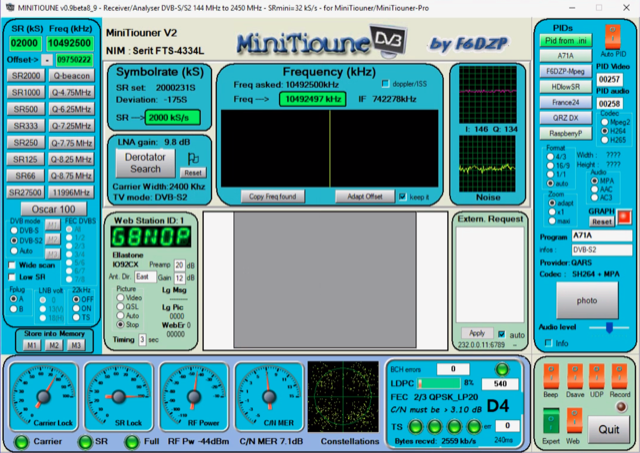

I am having the same problem! All lights are green except for the "Graphic" button. Signal strength of the Oscar-100 is D4. I have previously had excellent results, but cannot seem to get past this problem. My next test is to replace the PC in the shack and see if the problem is cleared.
Pipsqueak
Inscription: 04 Aoû 2017
