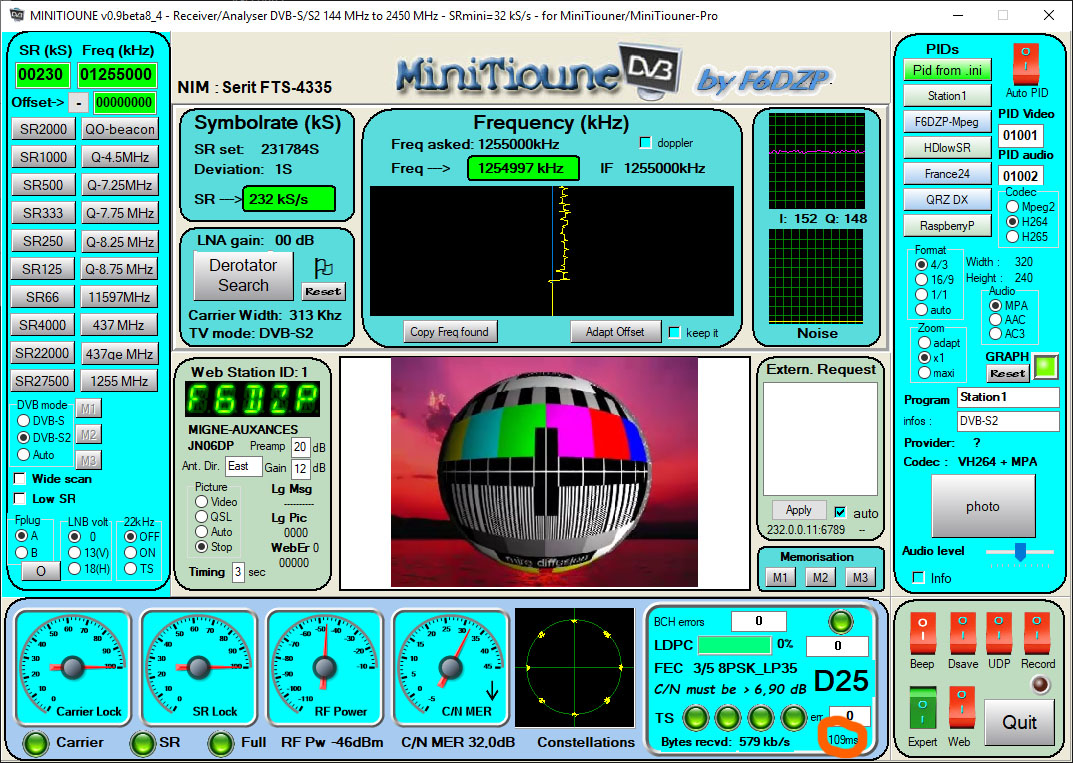

My development of Minitioune are made mainly for the MiniTiounerPro, the new MiniTiounerPro V2 and the Minitiouner V2_BATC.
Minitioune is evolving towards a double receiving possibility. Only the MiniTiounerPro or MiniTiounerV2_BATC+extension can do that.
The MiniTiounerPRO V2 will be available in 2 weeks. it has already many features that are a big addon (double receiving possibility, double LNB chip for producing 13v or 18V that can be different on each F-plug, double TS-parallel output for future extension, GPIO input/output, 8 different power drive for 8 different relays/LNA depending of the band you are using ...
The MiniTiounerpro is also the best hardware about noise and I2C speed (twice as fast as MiniTiouner Express).
Mintioune09beta8_4_timing using a MiniTiounerPro.jpg (378.31 Kio) Vu 39808 fois
