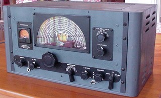

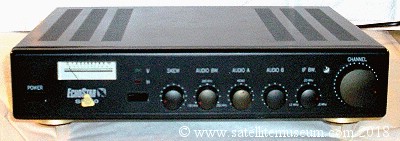

I would love that as well. a nice big box with screen and twiddly knobs for tuning freq, sr,mode, fec and switches to flick
something along the lines of this
with analog signal meters and a nextion display
with a big analog tuning dial
self contained with either built in screen or comp/ hdmi video output
the Tiounedown Reciever Box TRB ;-)
