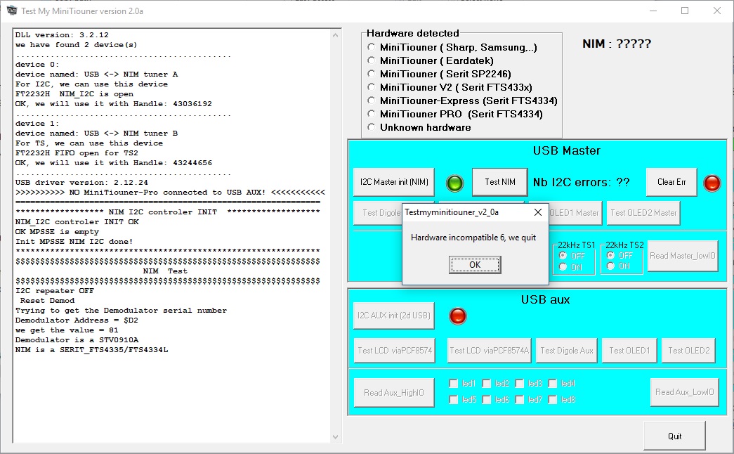

TestMyMiniTiouner v0.2a => hardware incompatible
Messagede G4KLB » Ven 13 Avr 2018 22:36
I think I must do a little mod to my MiniTiouner V2.0 for it to be recognised.
Re: TestMyMiniTiouner v0.2a
Messagede F6DZP » Sam 14 Avr 2018 05:47
Hello Colin
Yes, now I must be able to recognize a great familly of different MiniTiouners.
For the MiniTiouner v2, you must add a resistor of 4,7k or 10k between the ground and CN2-19 (or change the Name in the eeprom using FTprog 'MiniTiouner' instead of 'USB <-> NIM tuner' )
after talking with Noel and Brian, they said it was easier for people just to add a resistor.

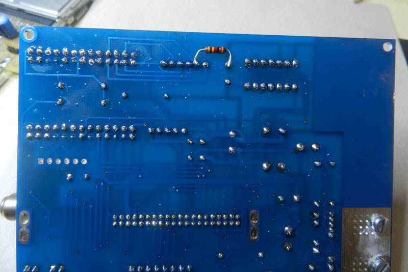

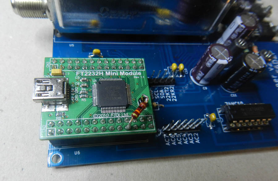

Minitioune V0.8 is compatible with all versions of hardware and automatically detects the version of hardware in use – to enable this function to work with the BATC MiniTiouner hardware you need to add a 4.7k or 10k resistor between pin CN2-19 of the USB module and Ground before running the software.
You can do this on the Mini module or on the main PCB as shown in the following pictures:
Resistor for detection of a MiniTiounerV2_.jpg (101.26 Kio) Vu 42701 fois
or you can do it under the pcb:
Resistor for detection of a MiniTiounerV2_underPCB_.jpg (80.28 Kio) Vu 42701 fois
