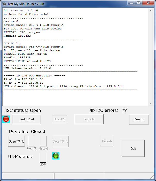

could you show me the exact capture of TestMyminitiouner like this:
When I click refresh...
I don't understand, there is no "refresh" button.

Herewith the screen capture that I get;
Thank you for your help and advice.
73 Shaun.

Ok, your PC cannot talk with the FT2232H
are you sure that your USB plug is USB2, not USB1?
(If your computer is too old, it has only USB1 port)
