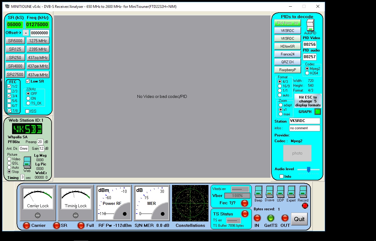

Message from VK5YYY:
Hi Jean Pierre,
Here is the screen dump from the NUC that runs tutioune, we have made many adjustments to the resolution
This is the best we could make it
It does not fill the screen, the full screen button is disable/greyed out
Is it only designed for 4:3 and not 16:9
We would like to fill the screen so when the HDMI output of the NUC is repeated back it fills the TV screen
If you have any ideas please get back to me
NUC Screen Shot.jpg (242.62 Kio) Vu 38545 fois
Cheers Roger VK5YYY

Messagede F6DZP » Jeu 19 Jan 2017 18:29
Have you tried to hit the ESC key - several times- to change the screen format ???
Jean-Pierre
