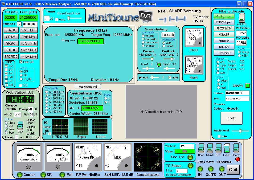

I have MiniTiouner (FT2232 + NIM) but with Minitioune v04c do not decode Mpeg2 DVBS signal. I checked install drivers and SW on three different PCs with the same result.

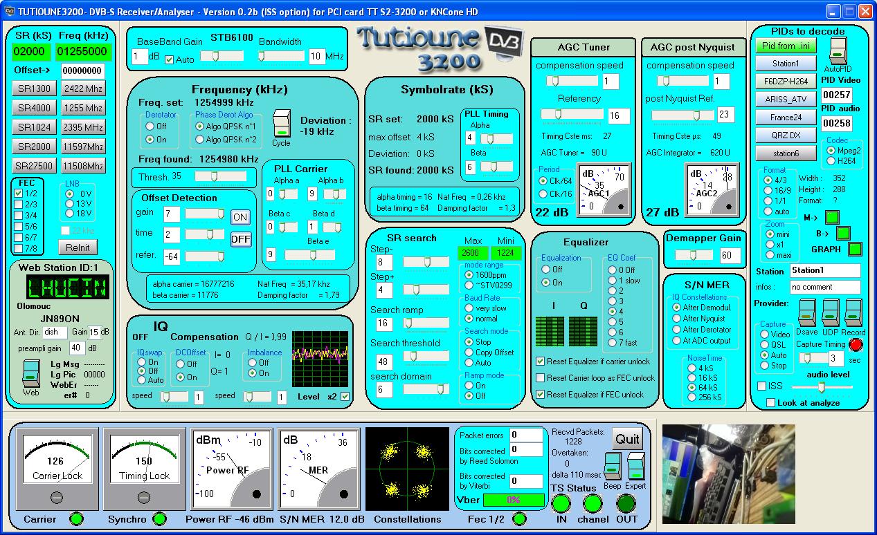

On one of pc is instaled TechnoTrend S2-3200 card and Tutioune 3200 v0.2b and decoding is OK. I presume that there is installed correct video filters and codecs. But Minitiouner do not decode video.
For testing I use Raspberry Pi with RpiDatv SW and IQmodulator from PA0RJV.
Correctly decoded signal on TTS2-3200
The same test signal and the same PC, but different SW and Minitiouner.

Anyone have any idea what is wrong??
How can I verify that the data from NIM pass through the FIFO to USB port and to SW decoder??
Many thanks for your cooperation.
