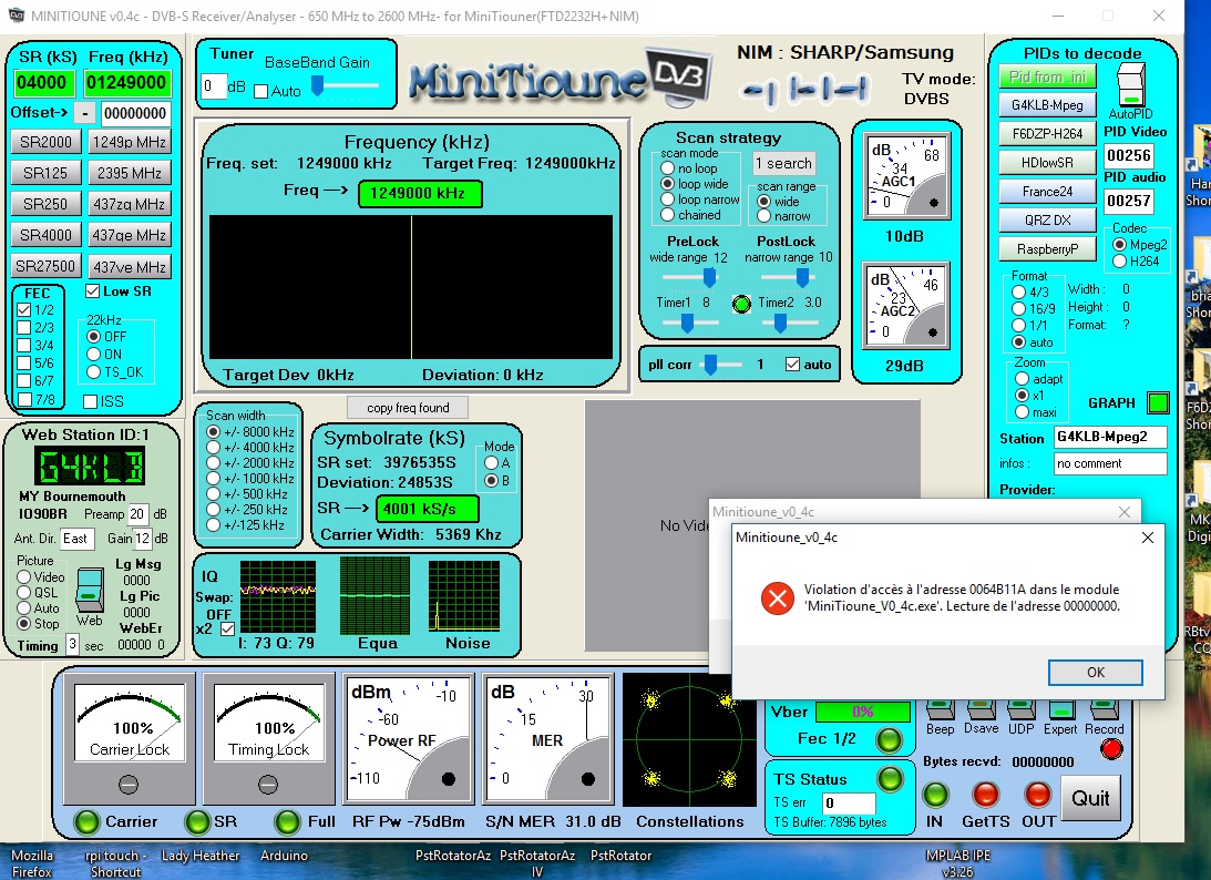

I have a problem with my Windows 10 PC when loading MiniTioune.
Have reloaded everything I can think of, but not resolved the issue, Everything works on my Windows 10 laptop, A complete reinstall of Windows 10 would fix the problem but that is the last resort.
Many thanks

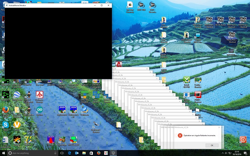

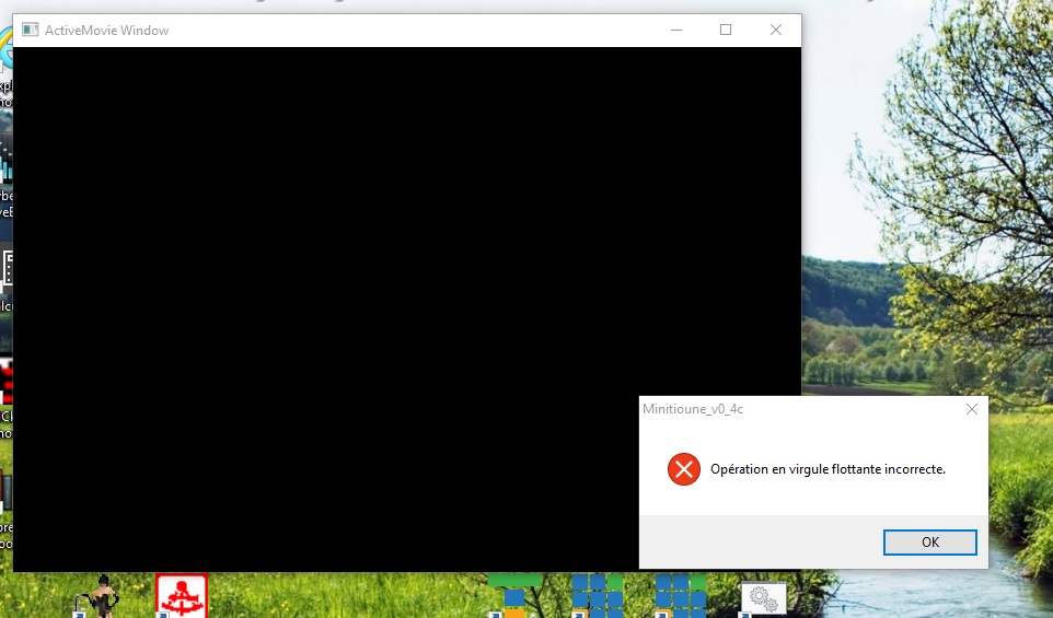

de G4KLB
This is the other Error I get, Its only displaying the video that is a problem, I think my windows files are corrupt, so will have to reload windows to fix it.
