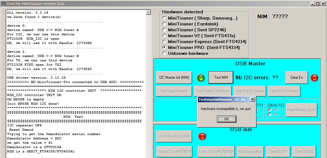

Dear Jean Pierre,
I have build my Minitiouner V2 and tested it with the drivers and fiklters first. I receive all green points.
Now I test "TestMyMiniTiouner_V2_0a" and I receive the error: hardware incompatible !
Thank you for help, you can answer if possible also to my e-mail: rudolphkh@a1.net

Dear Pierre, F6DZP,
please I need your help. I think the problem is, that my "USB -FT2232H Mini Module" does not comunicate with my Computer.
What can I do, must the DRiver be reprogrammed ?
vy73, Karl-Heinz, OE8KHR

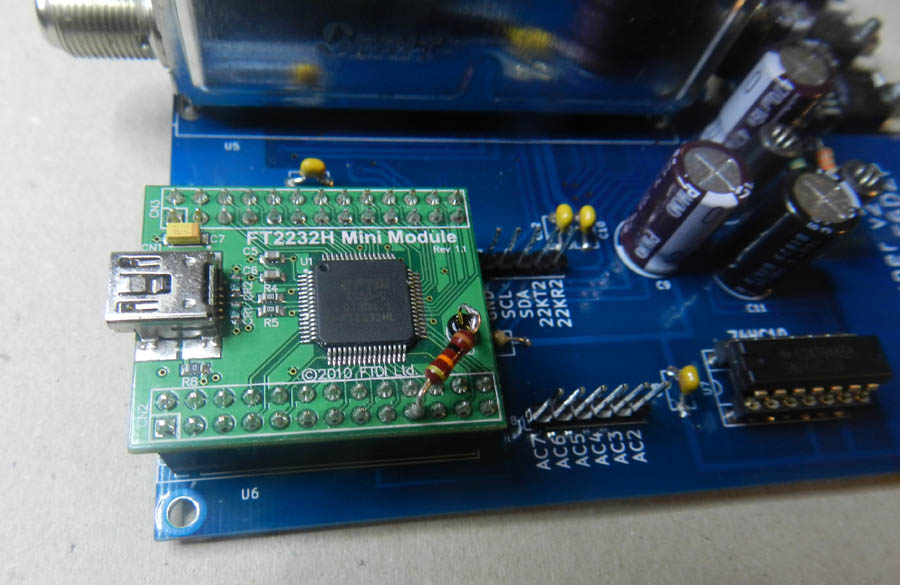

Re: minitiouner V2 - FTS4334LV
MessagePosté: Mer 28 Oct 2020 06:34
this kind of problem comes from hardware.
I think that you have made a mistake when you have built your MiniTiouner V2
I suppose that it is the resistor we must add on the FT2232H minimodule that does'nt exist or is at the wrong place.
Could you join a photo of you Tuner, specialy I need to see the FT2232H minimodule.
MessagePosté: Mer 28 Oct 2020 08:45
de OE8KHR
Hi Pierre,
thank you for Information. I found that the second soldering Connection at this resistor was not Ok, no contact.
After new soldering I receive now a full Picture.
Can you help me now with the following message in the Picture: "No Video or bad codec/PID"
vy73, Karl-Heinz Rudolph, OE8KHR

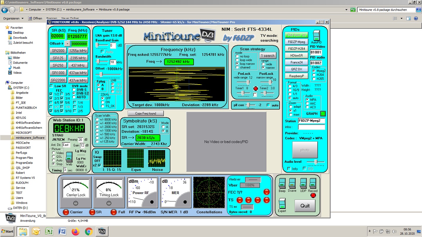

MessagePosté: Jeu 29 Oct 2020 08:24
de OE8KHR
Hi Pieerre.
please find my Screen shot with Version 09.beta.
I have no antenna conected !
How can an I load also some Video ?
73,Karl-Heinz, OE8KHR
MessagePosté: Jeu 29 Oct 2020 09:52
this not a video plyer but a receiver. so you first need to receive a DVB signal.
So you need an antenna for local station on 70cm or 23cm band or need a dish turned toward QO100 to receive it
