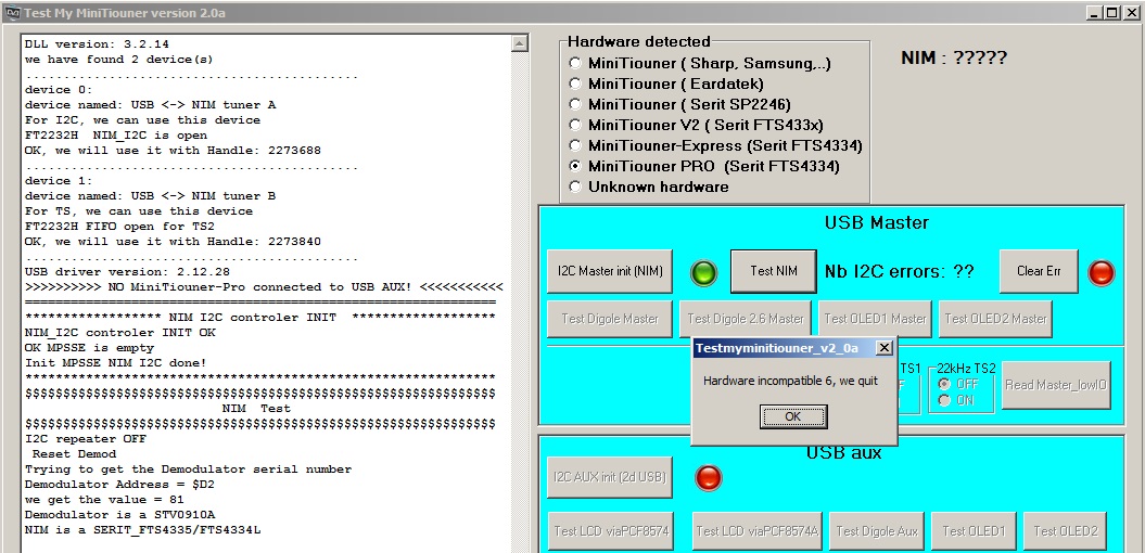

I have build my Minitiouner V2 and tested it with the drivers and fiklters first. I receive all green points.
Now I test "TestMyMiniTiouner_V2_0a" and I receive the error: hardware incompatible !
Thank you for help, you can answer if possible also to my e-mail: rudolphkh@a1.net

Dear Pierre, F6DZP,
please I need your help. I think the problem is, that my "USB -FT2232H Mini Module" does not comunicate with my Computer.
What can I do, must the DRiver be reprogrammed ?
vy73, Karl-Heinz, OE8KHR

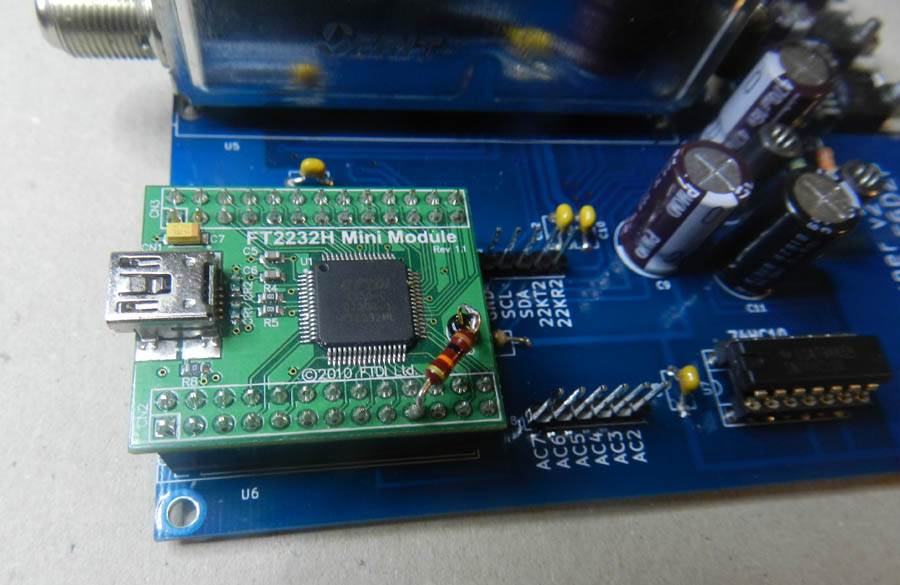

this kind of problem comes from hardware.
I think that you have made a mistake when you have built your MiniTiouner V2
I suppose that it is the resistor we must add on the FT2232H minimodule that does'nt exist or is at the wrong place.
Could you join a photo of you Tuner, specialy I need to see the FT2232H minimodule.
Resistor for detection of a MiniTiounerV2_.jpg (101.26 Kio) Vu 61421 fois

Hi Pierre,
thank you for Information. I found that the second soldering Connection at this resistor was not Ok, no contact.
After new soldering I receive now a full Picture.

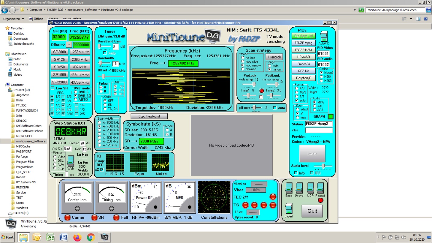

Can you help me now with the following message in the Picture: "No Video or bad codec/PID"
vy73, Karl-Heinz Rudolph, OE8KHR
OE8KHR
Inscription: 22 Oct 2020
Re: minitiouner V2 - FTS4334LV
Messagede F6DZP » Jeu 29 Oct 2020 06:22
That just says that, as you are receiving nothing (all leds are red, you must have all leds green), there is no video to display.
the version of software you are using is very old. Download the last version.(v0.9.9.1)

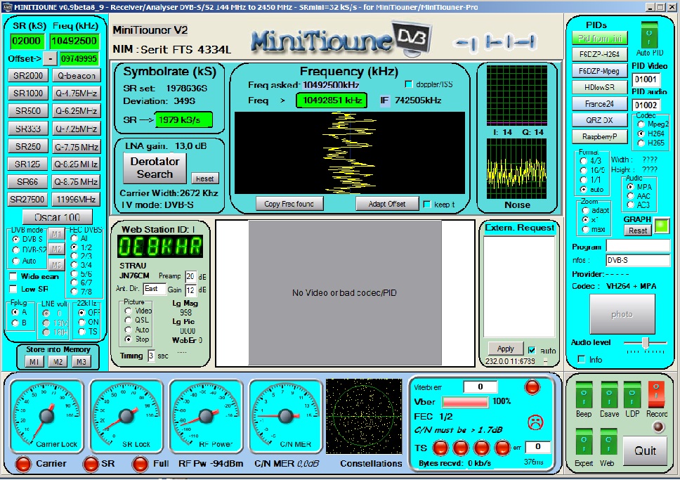

Messagede OE8KHR » Jeu 29 Oct 2020 08:24
Hi Pieerre.
please find my Screen shot with Version 09.beta.
I have no antenna conected !
How can an I load also some Video ?
73,Karl-Heinz, OE8KHR

Messagede F6DZP » Jeu 29 Oct 2020 09:52
this not a video plyer but a receiver. so you first need to receive a DVB signal.
So you need an antenna for local station on 70cm or 23cm band or need a dish turned toward QO100 to receive it
