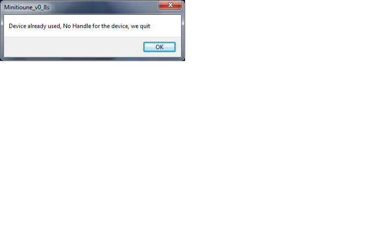

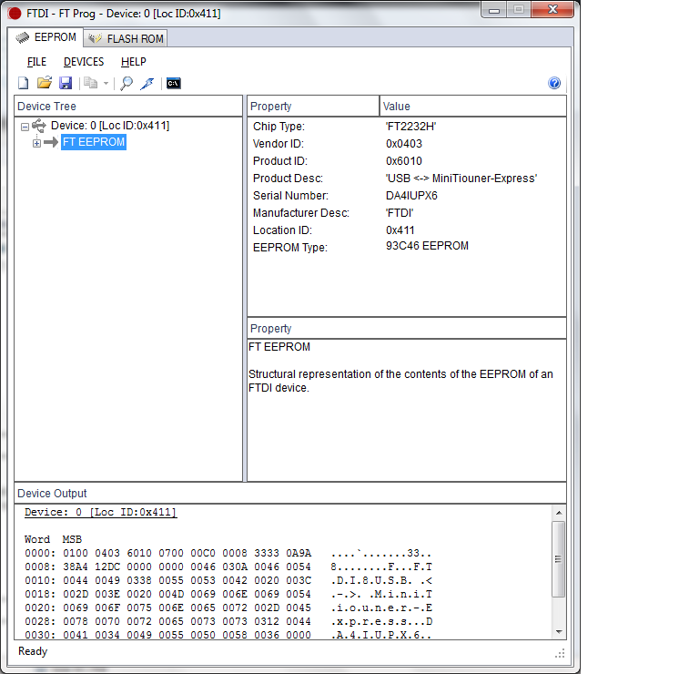

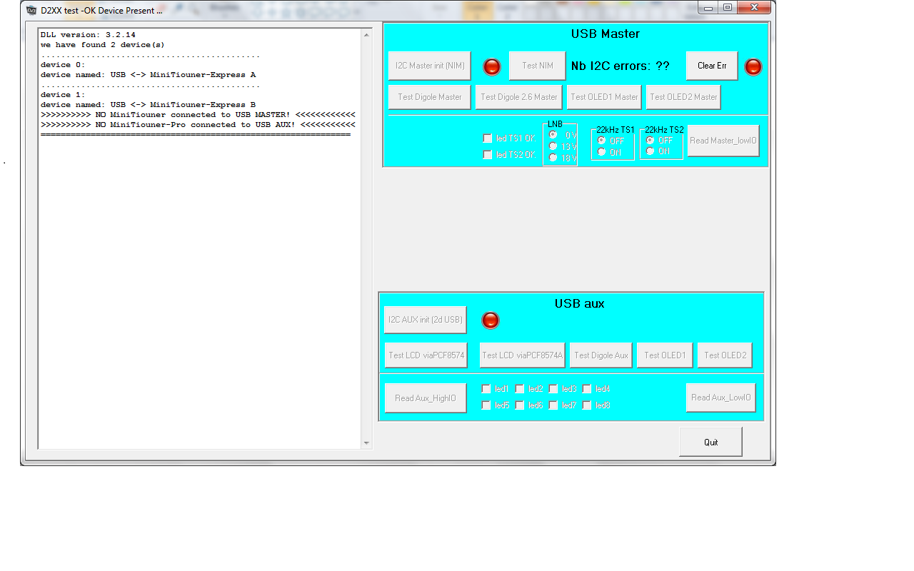

I have spent quite a few hours now with my new MiniTiouner-Express. I believe
my drivers are OK and I also did have to change the device name, but things seem
to get worse the more I work with this :-(
My PC is a 64 bit laptop running Windows 7, SP1 and the MiniTiouner-Express
module is revision B with the Seric FTS-4334 NIM.
Some screenshots attached...
I wonder if anybody else has encountered something similar?
73, Michael, OH2AUE

OK, up and running now, received an updated XML template file
called "using NIM tuner version 0.8.xml". Courtesy of DAT- Express,
this file is at:
https://www.dropbox.com/s/jocqsftygj00o ... s.xml?dl=0
Some compatibility issue with v. 0.8s software. Thanks Art !!!

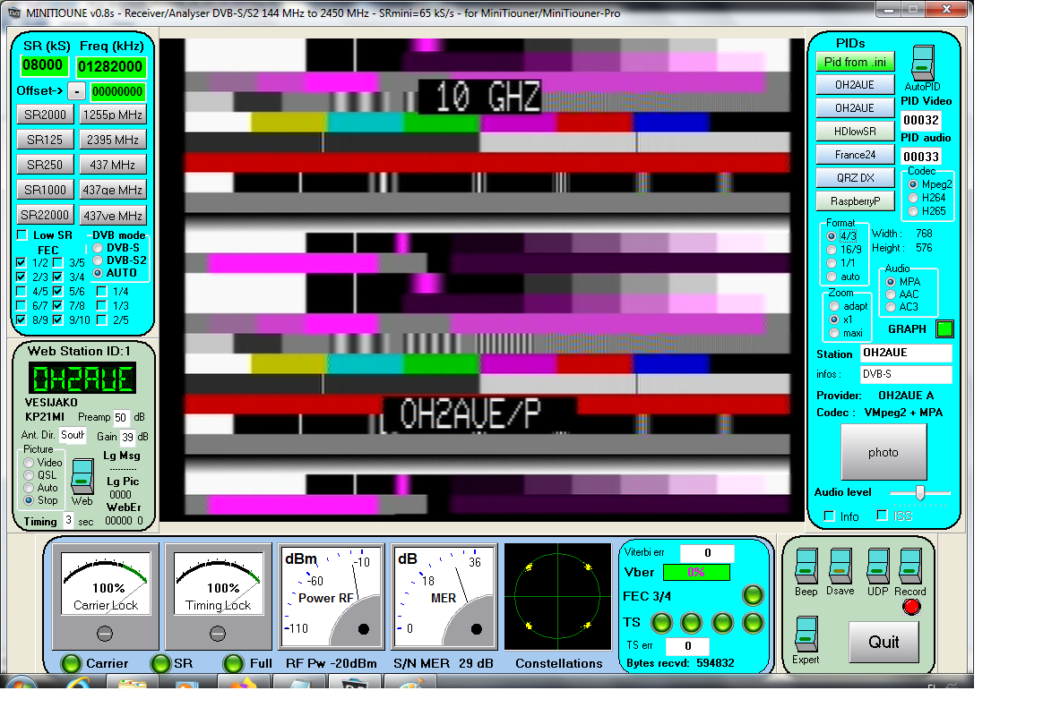

Messagede oh2aue » Sam 7 Mar 2020 15:24
Working fine now, tested with my DVB-2 DATV rig and with both -S and -S2 on Astra FTA channels :-) /michael, oh2aue
