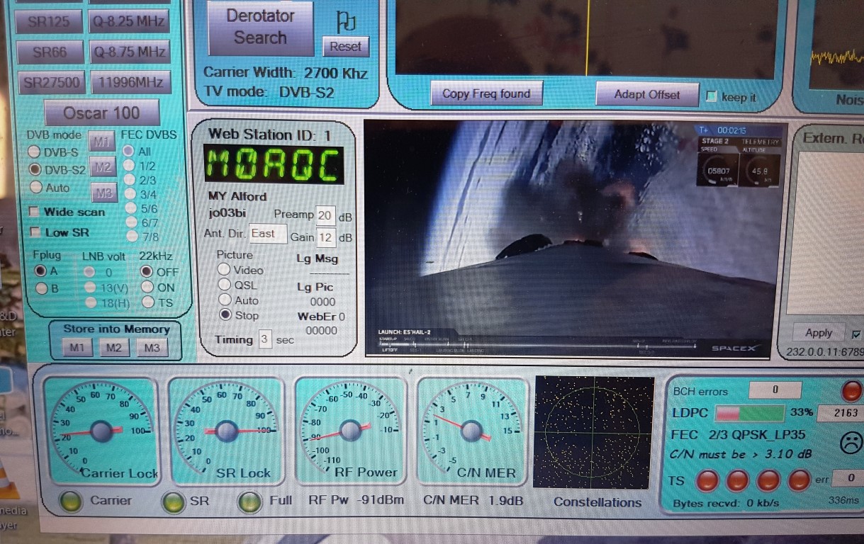

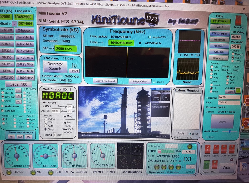

I am receiving the beacon from es'hailsat. here are 2 photos.
this photo shows lock
good (Medium).jpg (327.01 Kio) Vu 46541 fois
this photo shows no lock
bad (Medium).jpg (311.24 Kio) Vu 46541 fois

If I look at photo1, nothing is very strange, your carrier lock is 60%

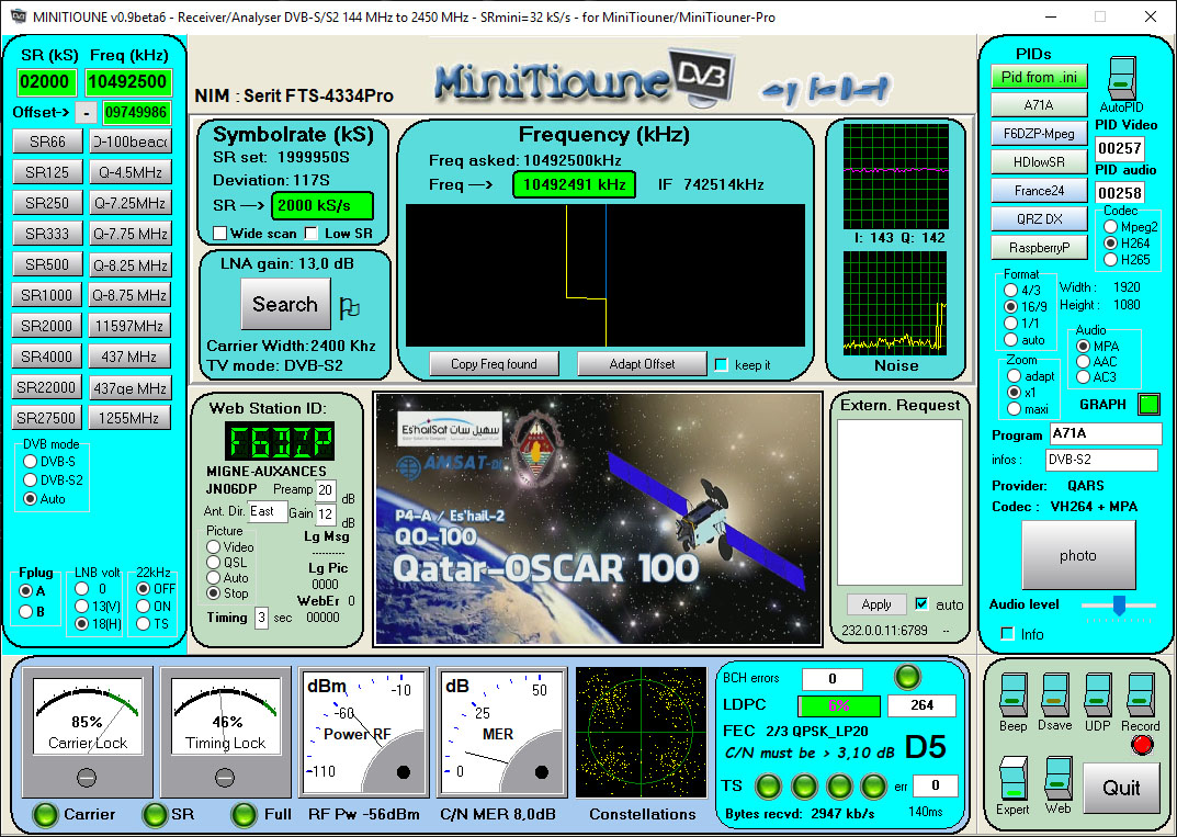

When I was using some basic LNB (I don't remember the exact model), I had this result:
MinitiouneV0.9 Beacon ReportD5.jpg (409.81 Kio) Vu 46539 fois

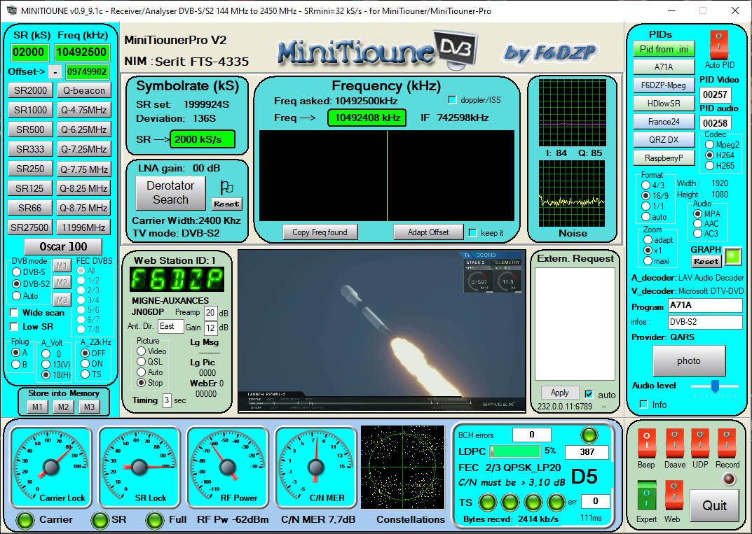

Using a professional LNB I have now :
Minitioune receiving Beacon LNB pro.jpg (307.39 Kio) Vu 46539 fois
On this station, carrier lock is always 85% max, even If I use a good LNB and a good NIM.
There is a little default in the modulation I suppose, as I can receive other stations with 100% lock.
On the second photo the carrier lock is lower and so, your MER is too low to be able to receive.
MER low = noise or phase noise on the frequency.
I suppose that your LNB has some problem ( jitter? phase noise ?..) or you have interferences with this frequency or ???
