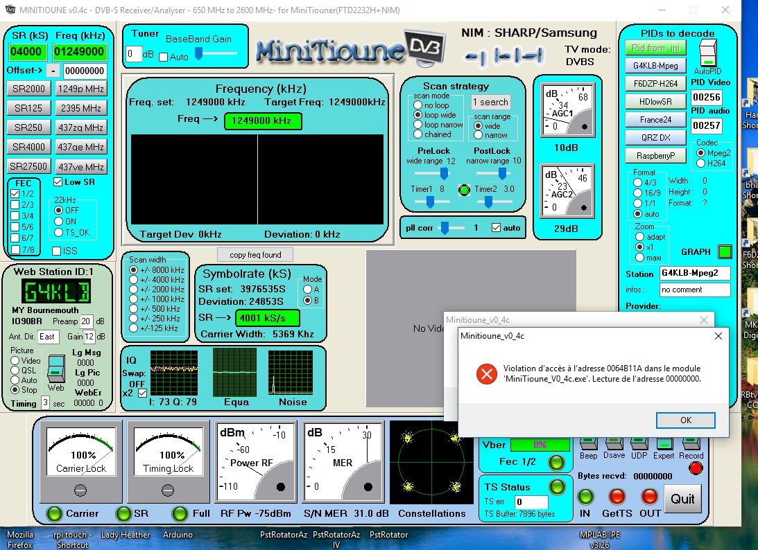

Messagede G4KLB » Dim 16 Oct 2016 13:33
I have a problem with my Windows 10 PC when loading MiniTioune.
Have reloaded everything I can think of, but not resolved the issue, Everything works on my Windows 10 laptop, A complete reinstall of Windows 10 would fix the problem but that is the last resort.
Many thanks

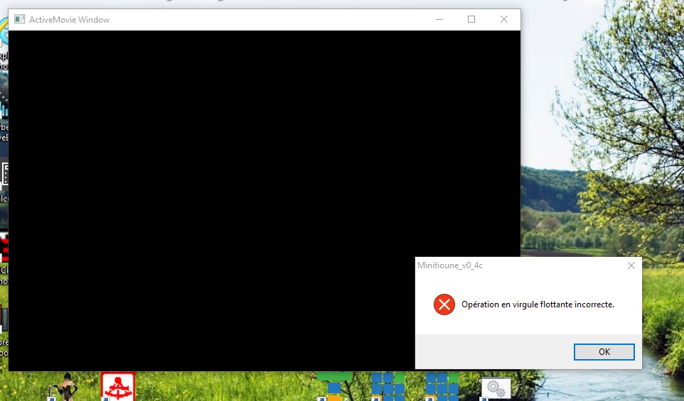

Messagede G4KLB » Mar 18 Oct 2016 16:54
This is the other Error I get, Its only displaying the video that is a problem, I think my windows files are corrupt, so will have to reload windows to fix it.

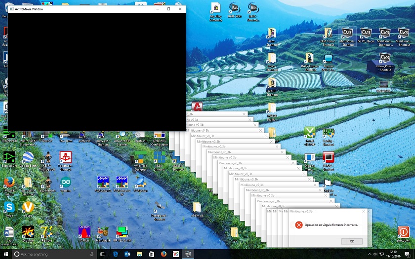

Re: Error loading
Messagede F6DZP » Mar 18 Oct 2016 17:46
Hello
Could you try the Minitioune version 0.3b or 0.3c to see if you have similar result?
Jean-Pierre
Re: Error loading
Messagede G4KLB » Mer 19 Oct 2016 21:20
Yes, the same with any version.

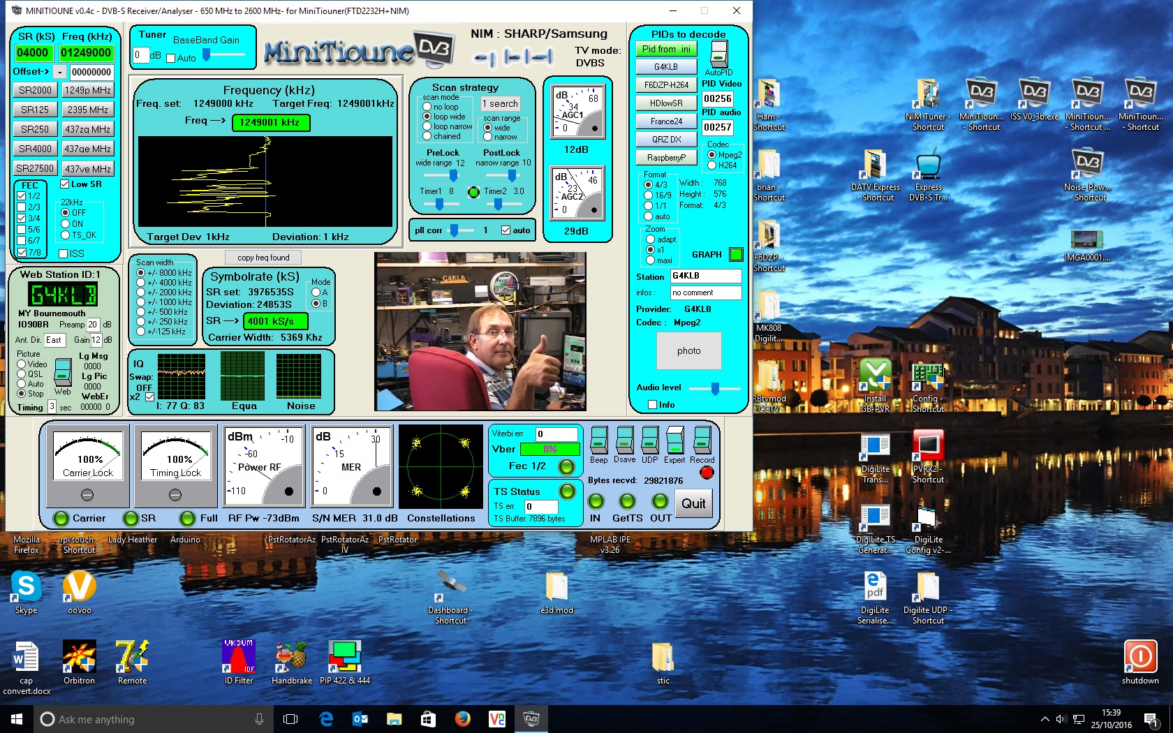

Re: Error loading
Messagede G4KLB » Mar 25 Oct 2016 14:39
New graphics card fitted this morning,
Everything is working now :D :D :D :D :D
Re: Error loading
Messagede F6DZP » Ven 28 Oct 2016 05:25
Well, you have the solution.
I think that it is more the new driver for the graphic card than the new graphic card itself that correct your problem.
Some graphic cards have bad driver that doesn't allow to use a "Video Mixing renderer" after the decoder, but only a simple "renderer"
I suppose this the issue that you had.
Tutioune/Minitioune software uses a Video mixing renderer.
Using a graphic card X, if you use a generic Windows driver, you will not access to a "Video Mixing renderer".
So we absolutely need a good/recent specific driver for the graphic card.
Jean-Pierre
