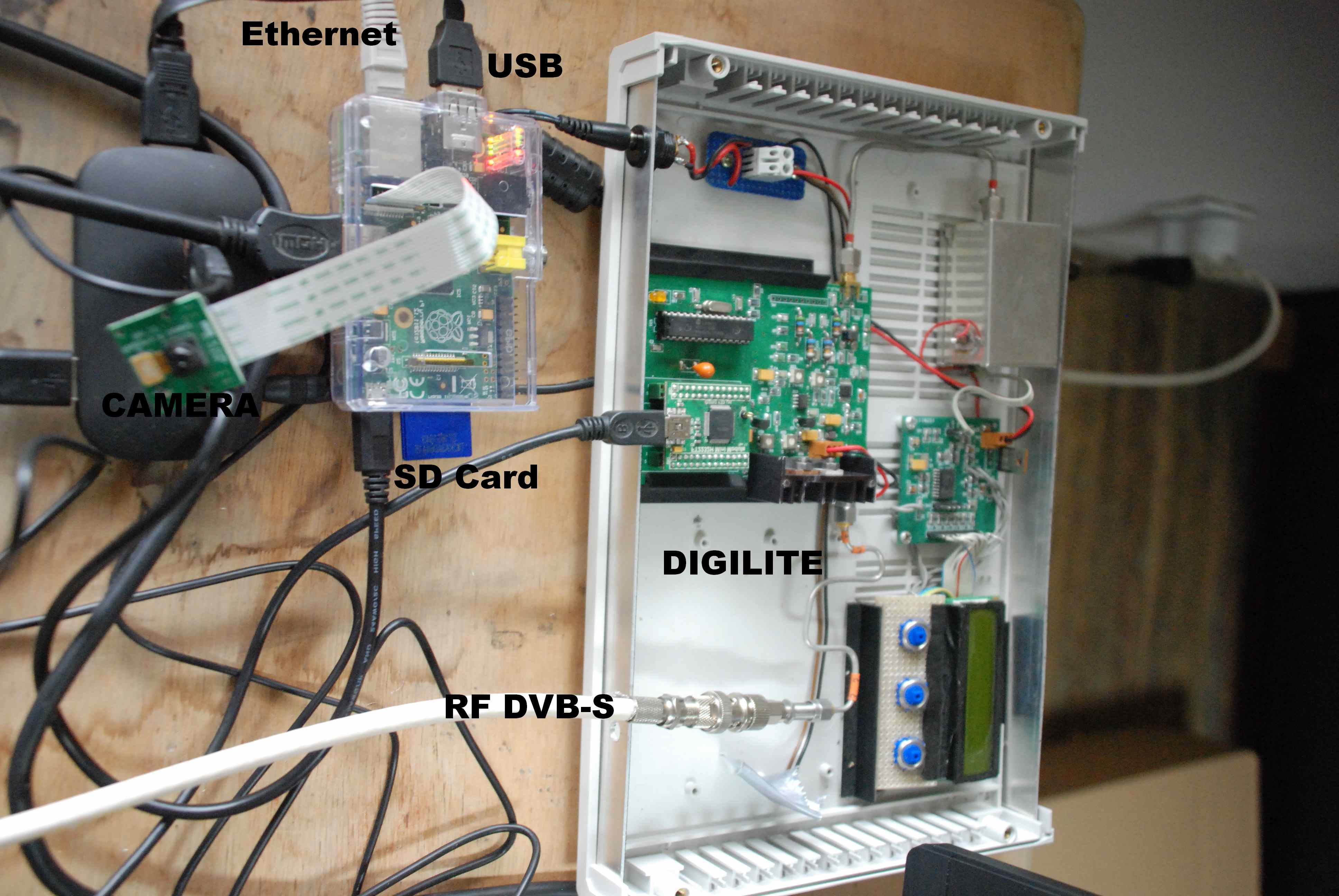

Workflow
I acquire the video from the Raspberry cam. This video is encoded in H264 Elementary stream which is then processed to make a constant bitrate transport stream. This transport stream finaly feed a modulator.
All these processes are done on the raspberry and it is then completely stand-alone.
Experiments with several modulators
DVB-T
First I use the Hides UTC100D USB dongle which is a DVB-T modulator. Thanks to its API I could easily send the transport stream. No other process is needed.
Digilite
Thanks to information from Brian G4EWJ and his great tool dvbs2enco, I could successfully send to digilite. Dvs2enco do the process of transport stream 188 to Reed Salomon which is waited by the digilite. Thanks also to Rob M0DTS for his tips learnt by his MK808 experience.

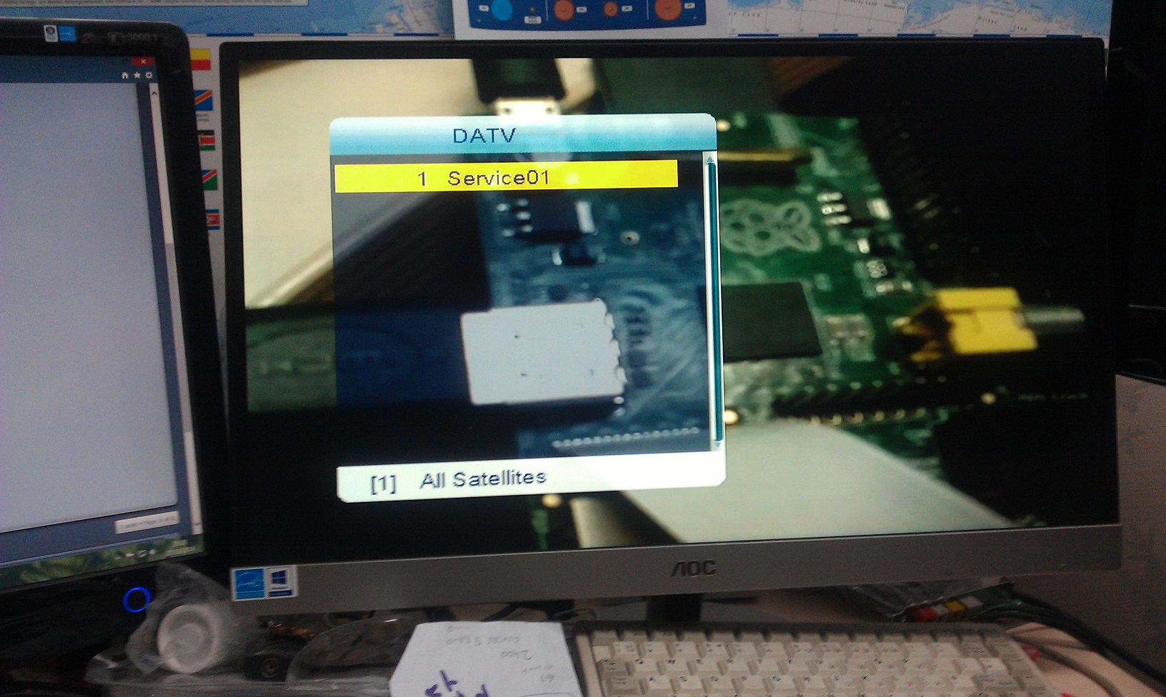

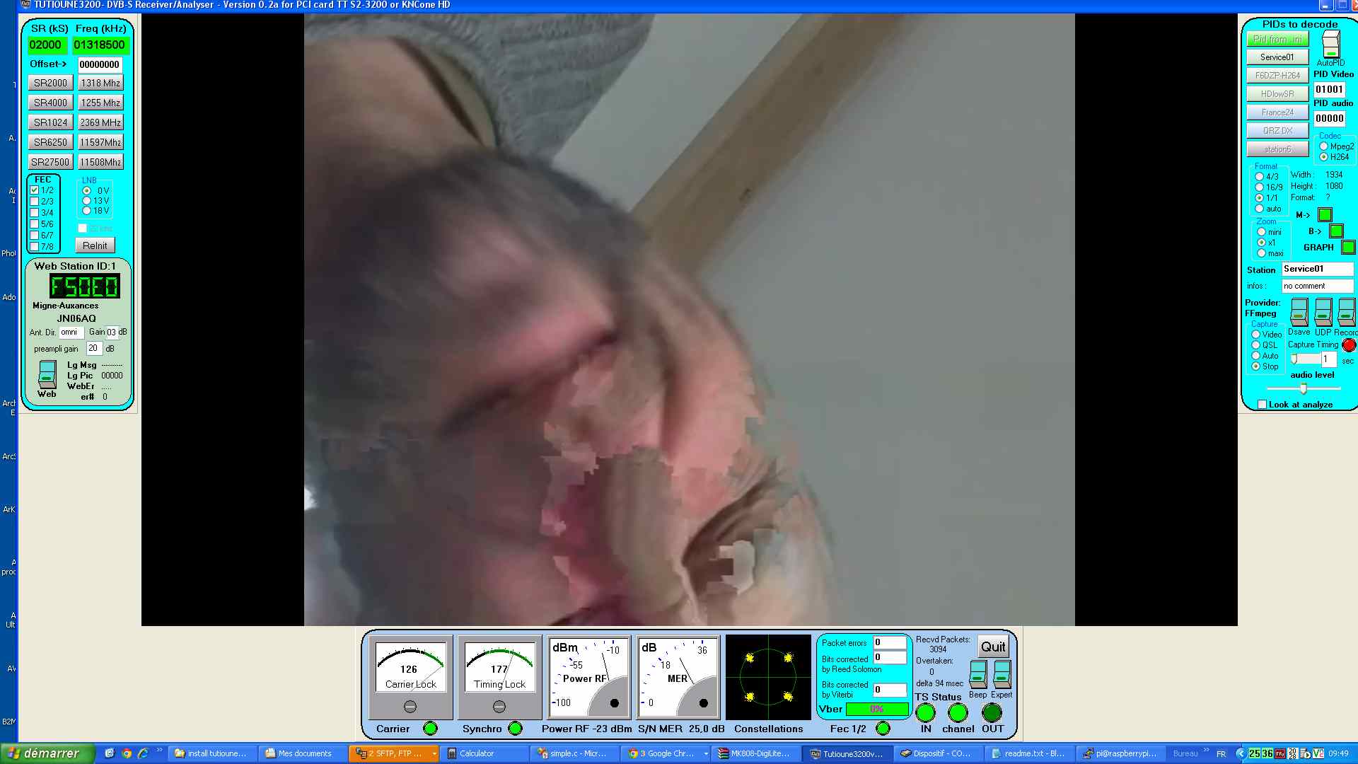

Many thanks for the SD image
I have had it working tonight, very well done Evariste.
Re: Using Raspberry PI to feed a DATV modulator – no PC requ
Messagede G4KLB » Jeu 27 Mar 2014 23:55

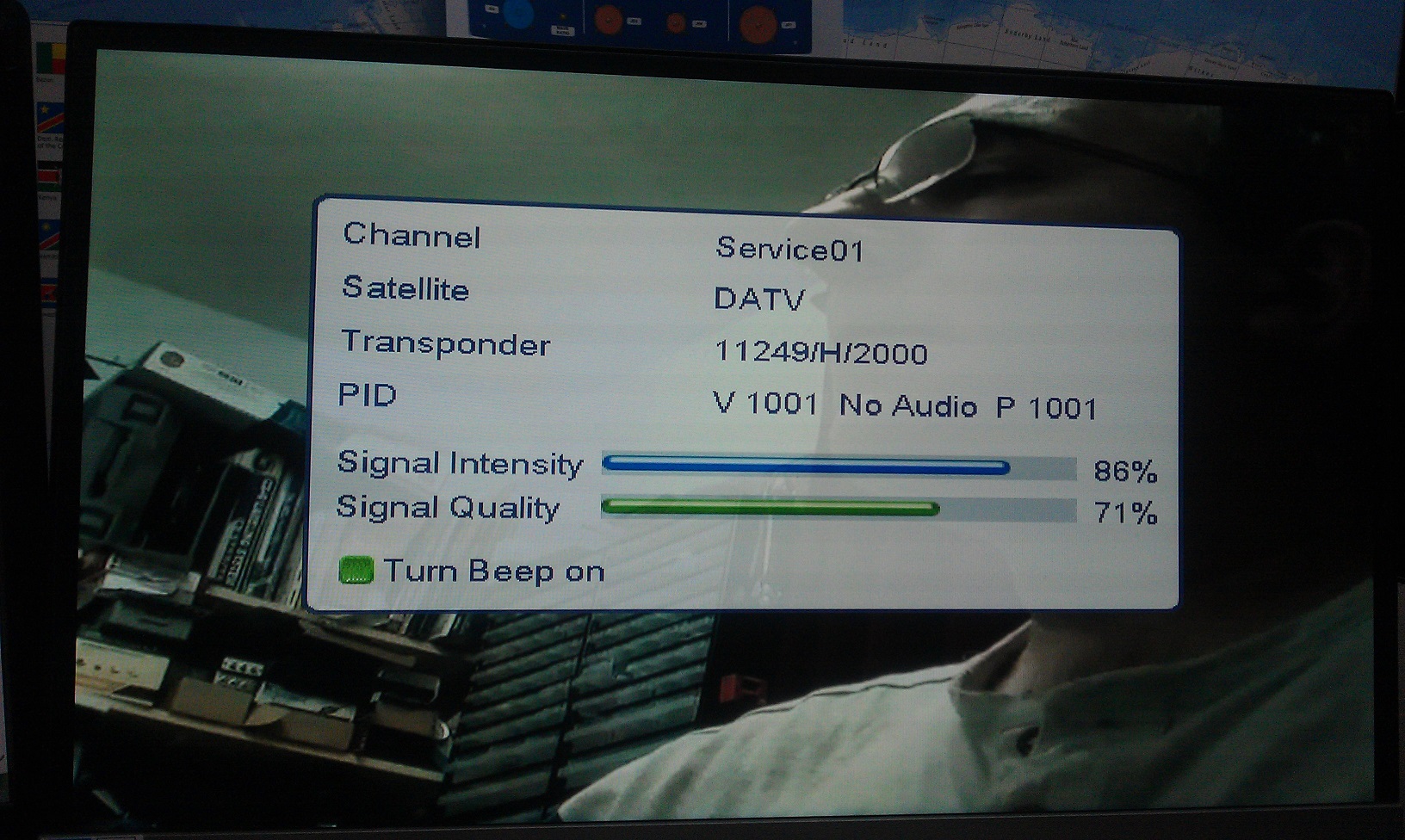

Received on my comag SL100HD RX
Messagede G4KLB » Jeu 27 Mar 2014 23:58
Same again,
The delay was a bit long, but a fantastic start, thanks for sharing with us.

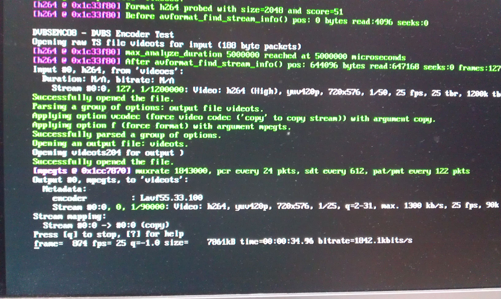

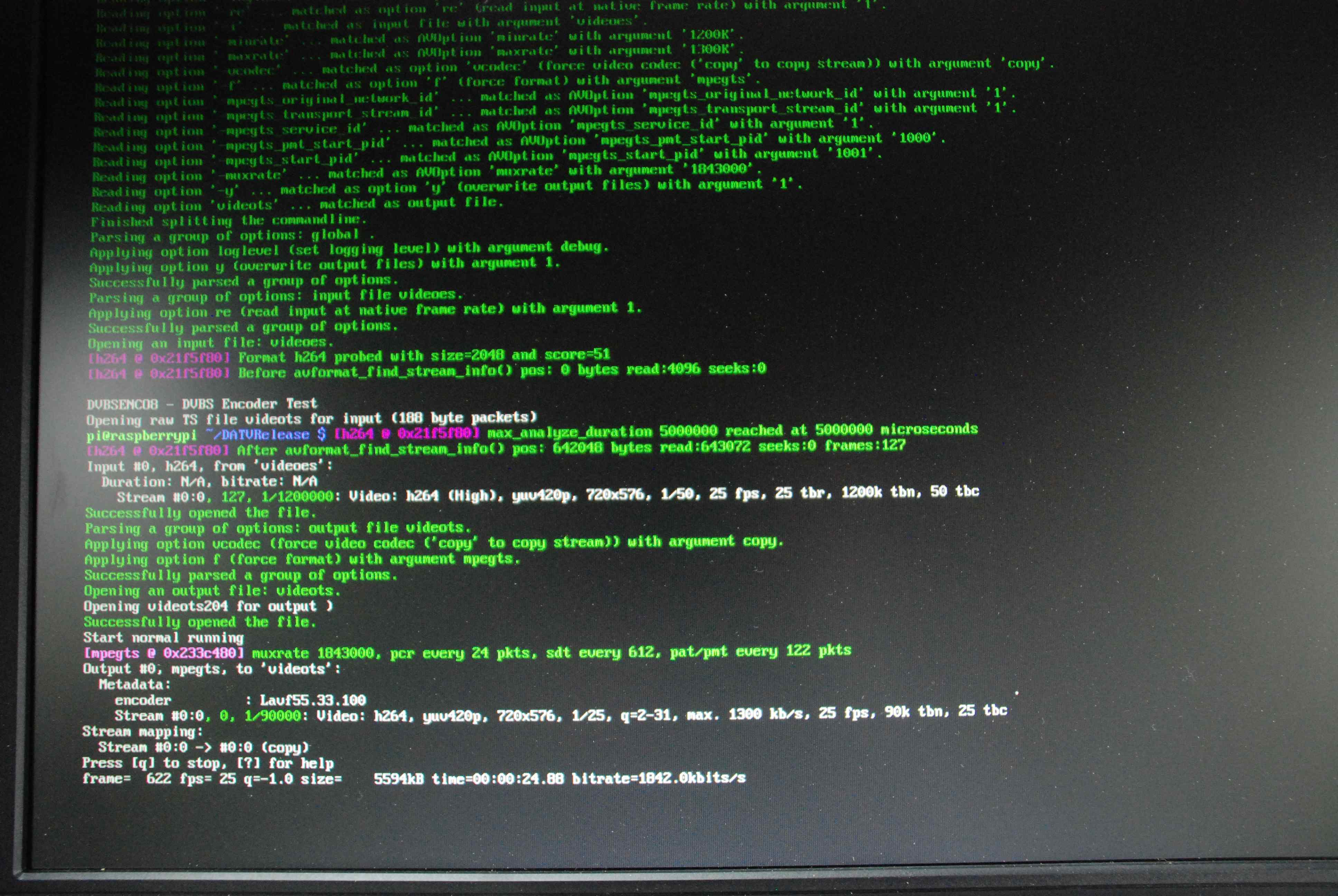

I have been doing a lot of testing and it is working well.
Sometimes the program exits back to the command prompt after a few seconds. It does this a few times and then it is OK.
I am not familiar with ffmpeg, so I am guessing a bit, but I increased the data rate from 1843000 to 1843137, but it still exits sometimes.

Good to hear it works well now ! About the "sometimes" process stopped, I change the ffmpeg command in order to have less latency and also dvbsenco8 which stopped if there is no data input and then it seems OK. I have still about 5 to 6 seconds of latency but I didn't inspect deeper if it could be the digilite itself which could insert such a delay.
At 720*576 the CPU is about 4% for encoding, I am surprised that HD encoding takes such a CPU. Have you run a "top" to see which process cause this consumption ?
By the way...I have to flash the digilite, as I have an old version which does not accept low bitrate...
73's Evariste F5OEO
