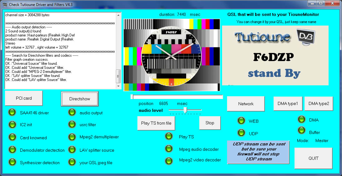

Hi, running CheckTutitoune shows 3200 card installation good, all green lights except TS, Mpeg2 audio and Mpeg2 video decoder lights. The Check list shows:-
Filter graph creation success.
OK :"Universal Source" filter found.
OK :Could add "Universal Source" filter.
OK :Could add "MPEG-2 Demultiplexer" filter.
OK :"LAV splitter Source" filter found.
OK :Could add "LAV splitter Source" filter.
Being new to this, what have I missed, the TS file plays test card ok. Or do these only light when receiving good video?

Do you mean that, when you click the button "Play TS from file" you can see the video and hear the sound, but the 3 leds under this button remain red ?

When I run Check program those 3 LEDs remain red. I think I have loaded all drivers/files OK.
What I am asking is do these LEDs only illuminate when receiving a correct signal from the TT S2-3200 card.

--> when you click the button "Play TS from file" , can you see the video and hear the sound? do the 3 leds under this button remain red ?
or join a screen-shot of what you see.
When you write:
there is no meaning for me as "CheckTutiouneDriver&filters" is not a receiver, it is just a software to check if you have all drivers and Directshow filters well installed.
For that, when you press the button "Play TS from file" this software try to play a TS file, if you see the video and ear the sound that means that all is OK and you should have the 3 leds green.
The S2-3200 is not used nor checked at this moment,we just check that your computer can read, decode and play a TS file, so all 3 "directshow filters" needed for this work are present and so the 3 leds are green. Nothing to do with a S2-3200 card at this specific step.
There is no need to receive a signal to get the 3 midle leds green. All leds must be green without any signal.
I get all these leds green without any signal.

Yes, all working ok, running TS file shows all LEDs running green
