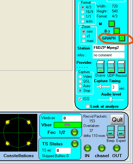

I am using tt 2-1600 and your last version for ISS, but the graphic led is red on the right side.
Is this normal or what does it mean ?

I suppose your are talking of GRAPH not graphic square LED.
Square Leds Tutioune.jpg (95.86 Kio) Vu 37682 fois
a GRAPH is a structure Windows create for decoding audio and video. If you have a GRAPH squre Led that is RED that means that your Windows installationwill nort be able to decode your TS stream.
There are different explanations:
- you forgot to install usrc.ax
- your computer use WinXP and has not Mpeg2 audio or video decoder installed and you must install one
- the "decod Mpeg2.GRF" file is not in the Tutioune directory.
There is a specific software for testing all that . do it, you will see what happens.
http://www.vivadatv.org/viewtopic.php?f=72&t=262

Messagede dj3dy » Jeu 13 Mar 2014 11:23
Hello Jean Pierre,
yes I mean the GRAPH. But it works in the normal program, but not in the ISS beta-program.
Now it is green, I don't have the GRF-file in the right directory . Thank you.
