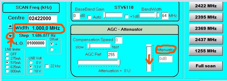

Postby F6DZP » Thu 13 Mar 2014 19:33
Your graphic cannot say all what happens, it is not only wifi interferences but also the curve of your down converter noise amplification
that has this graphic.
1)You must set Width to 62.5 MHz.We will see better the band we are going to use
just click several times on this button to go down to 62.5 Mhz
2) you must put attenuation : I think that your down converter has a great gain so you need to use the attenuator ( -12dB ??) at right to see the top of the graphic.
About HAmTV
We will have 2 frequencies :2369 and 2395 MHz under 2400 MHz .
Wifi is upper 2.4 GHz so disturb us for 2422 MHz and a little less for 2437 MHz
Saturday HamTV frequency change to 2395 MHz, I think it will be better.
Posts: 1129
Joined: 24 Dec 2010
Re: PROBLEM WITH PLAY TS
Postby EA5FUZ » Thu 13 Mar 2014 19:42
F6DZP wrote:Your graphic cannot say all what happens, it is not only wifi interferences but also the curve of your down converter noise amplification
About HAmTV
New settings! [url][URL=https://imageshack.com/i/muy7krj]Image[/url] [/url]
2395 MHZ
[url][URL=https://imageshack.com/i/g9l527j]Image[/url] [/url]

Postby F6DZP » Thu 13 Mar 2014 20:49
Woh!! Now we can really your conditions of reception and interferences.

Postby EA5FUZ » Thu 13 Mar 2014 21:08
so is there any hope? the all controls is ok? don't touch?
[url][URL=https://imageshack.com/i/b8wyayj]Image[/url] [/url]
EA5FUZ
Posts: 27
Joined: 04 Sep 2013
Postby F6DZP » Fri 14 Mar 2014 07:47
Yes all is OK.
The only thing that could be changed, depending of your Down converter gain is the BBgain.
I cannot give a specific value.
I see you have set it to 0dB, it is perhaps too little, you could try 2 or 4 dB
If you don't send the stream to VLC or TSreader you don't need to switch ON the UDP button.
You can also put back to Stop postion the capture button after 10 or 12 sec , you don't need to send your QSL every 3sec. After 10sec it is on your TiouneMonitor.
The only thing to do is to cross fingers for not to have too much Wifi interferences.
Good Luck
