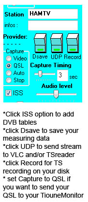

at the right of Tutioune you have the ISS little square to set.
Tutioune1600 setup 3 buttons ON.jpg (58.78 Kio) Vu 153688 fois
and you forgot to:
- set FEC only for 1/2
- give more BBgain (14dB for example)
- set AGC PostNyquist speed compensation to 4
