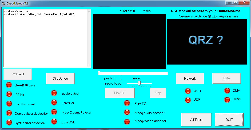

with the new version : CheckMatos V4.1 you can check all your PC installation.
There are 5 groups of Tests:
1 - Check your tuner PCI card and driver installation.
2 - Check if you have Directshow filters installed and your QSL card is in the Directory
3- Check if your computer can play a TS file - mpeg2 encoded - so check also for Audio and video Codec installation
4 - Check Network availability for UDP sending ( to VLC, TSreader ...) and for WEB-XML sending to your TiouneMonitor.
5 - Check if the TS data coming from your PCI card can be sent to the Directshow graph for decoding.
Before tests :
CheckMatos V4_1 before tests.jpg (128.35 Kio) Vu 52085 fois
after having done all tests you must have all leds green.
CheckMatos V4_1 after tests.jpg (173.06 Kio) Vu 52085 fois

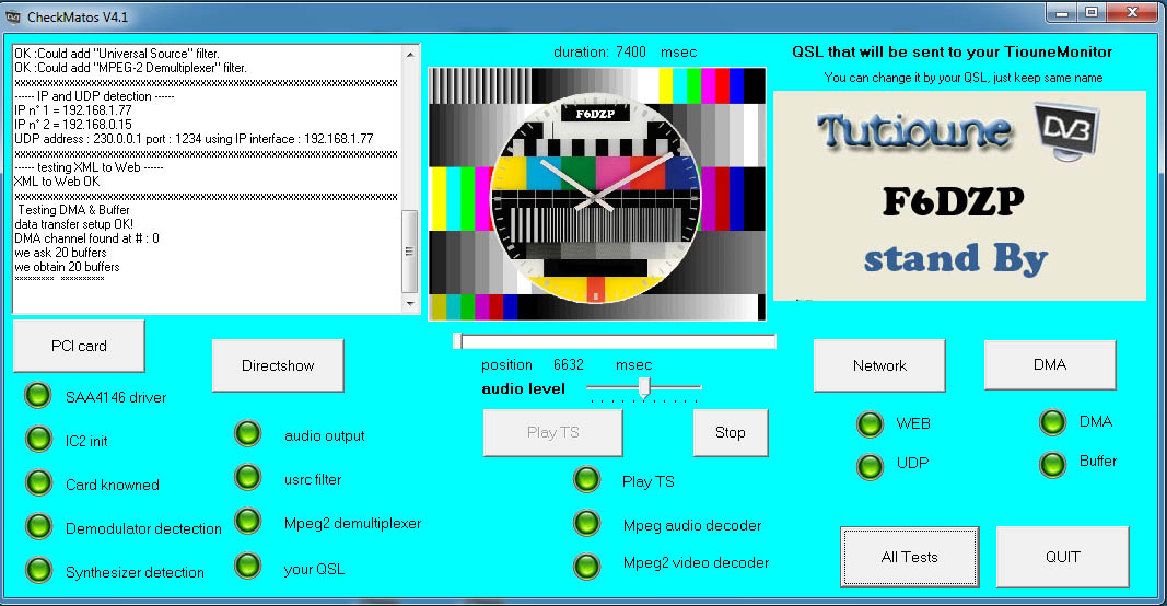

Messagede kb3pmr » Dim 10 Nov 2013 21:13
I just down loaded the CheckMatos V4_1 and ran it. Everything seems fine with the exception that I do not have green lights on the DMA and the Buffer. Do I need this for the S2-1600 board? Windows 7, 32 bit. This was just a dry run with out the antenna hooked up to the High Sierra down converter. If I do need it, what does it do and how can I fix the problem?
Please cancel the above. As an update...after install the V4.1 worked as above. We powered down and walked away knowing I would report this problem. Seems, that perhaps it was not a problem. Upon 100 mile return home with the truck and getting it set back up to the dish that it just needed to power down and reboot. I would presume that after down loading that perhaps a reboot/restart of the computer is in order. I am not sure but it worked for me.
Thanks Bob kb3pmr

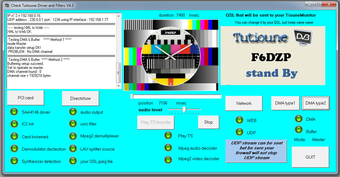

Re: Now you can do a full test before using Tutioune
Messagede F6DZP » Dim 19 Jan 2014 09:09
now a new version:
You can find it in the download section: http://www.vivadatv.org/viewtopic.php?f=60&t=261
