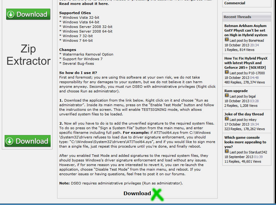

click on DOWNLOAD at the bottom of the page ( if you don't want to download anything you don't need).
dseo download1.jpg (221.89 Kio) Vu 130499 fois

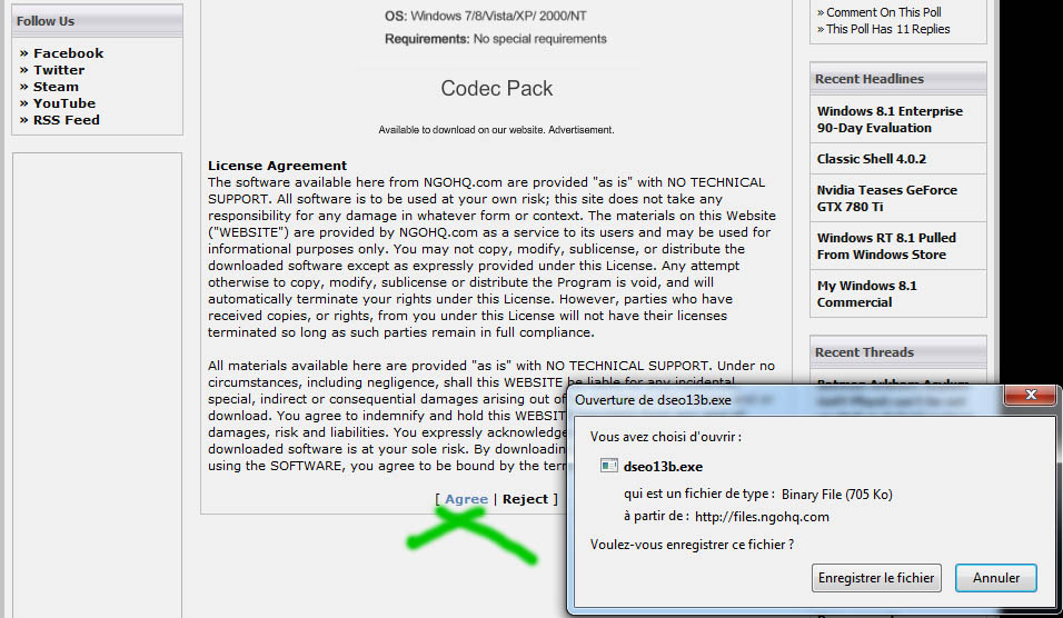

you will go to a second page, go to the bottom and click <Agree>
dseo download2.jpg (172.62 Kio) Vu 130499 fois

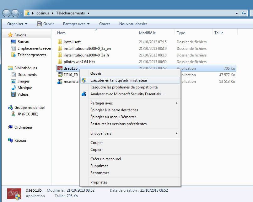

now you have the file dseo13b.exe on your hard disk.
click right on this file and ask to "Run as administrator"

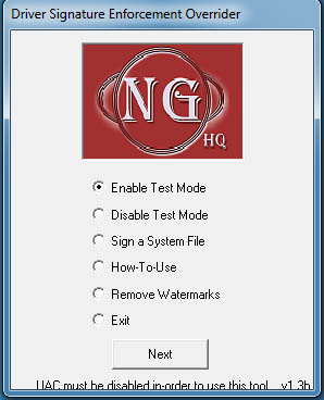

you will get the first DSEO panel :
dseo etape2.jpg (46.22 Kio) Vu 130499 fois

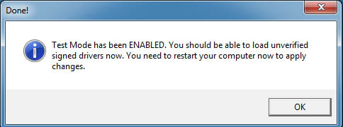

chose : "Enable Test Mode" and click Next.
dseo etape3.jpg (35.48 Kio) Vu 130499 fois

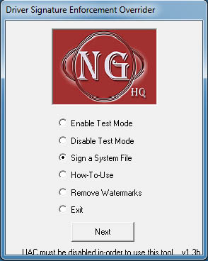

click OK an on the DSEO panel chose : "Sign a system file"
dseo etape4.jpg (45.36 Kio) Vu 130499 fois

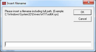

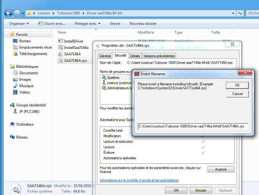

DSEO ask you the complete address of your file starting from C:\...
dseo etape4 bis.jpg (31.11 Kio) Vu 130498 fois

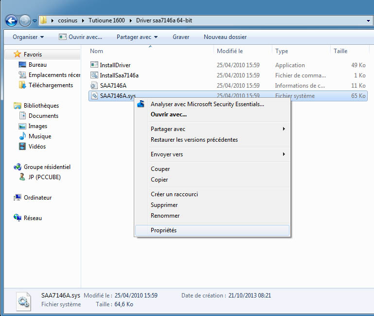

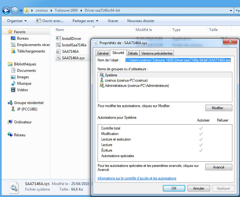

we must find it, for that I go in the directory where it is : "Driver saa7146a 64-bit" and I must get the complete way to it.
I click right on it
< sorry for French sentences>
dseo etape5.jpg (104.36 Kio) Vu 130499 fois
ask at the bottom for proprietaries
dseo etape6bis.jpg (133.89 Kio) Vu 130499 fois
select with your mouse the complete address and copy it (CTRL+C)
go back to the DSEO question and put the address (CTRL+V).
dseo etape7.jpg (139.63 Kio) Vu 130499 fois

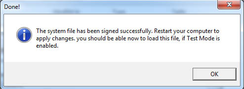

you will obtain an answer of success:
dseo etape8.jpg (35.96 Kio) Vu 130499 fois

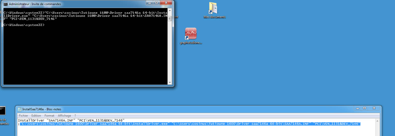

we cannot use the batch file to run the installation procedure. We must do it "by hand"
For that we will use the "Command Prompt" in Admistrator Mode
go to Start Menu > all programs, Accessories , right clicking Command Prompt and select "Run as Administrator"
we must write the whole sentence to install the driver using the "" characters :
"C:\ .... include full path \installdriver.exe" "C:\ ..include full path .. \SAA7146A.INF" "PCI\VEN_1131&DEV_7146"
on my computer I must write:
"C:\Users\cosinus\Tutioune 1600\Driver saa7146a 64-bit\InstallDriver.exe" "C:\Users\cosinus\Tutioune 1600\Driver saa7146a 64-bit\SAA7146A.INF" "PCI\VEN_1131&DEV_7146"
( I copied this sentence from my installSaa7146a.bat file)
dseo etape9.jpg (99.39 Kio) Vu 130499 fois

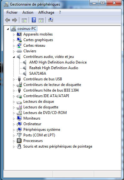

just after you execute this prompt, Windows open a panel to ask you to confirm to install this driver.
And now you can look at the Device Manager and see that SAA7144A driver is installed.
dseo etape10 FIN.jpg (83.99 Kio) Vu 130499 fois

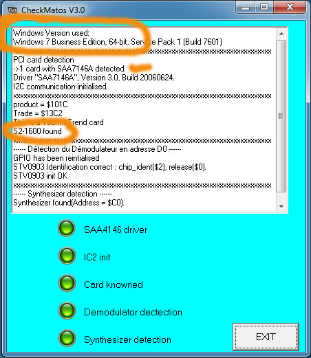

and if you run CheckMatosV3.0 you will find that all is OK, all LEDs are GREEN!!!
CheckMatosV3_0 win7 64 bits.jpg (94 Kio) Vu 130498 fois
